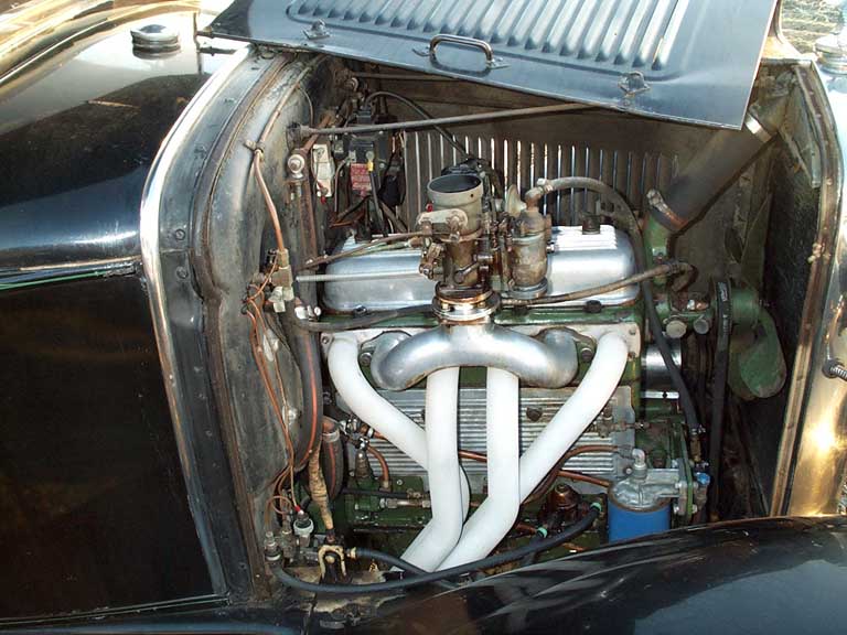

    Hey nice car.
    Do you have any pictures or details of what you had to do to the head? I have one here in England I was planning on fitting soon.
    Cheers
    Rich

  5. Yes - I'd be interested in what you've done inside that Thomas head? Any pictures?

    Yep I decided not to sell her, after all I really love this car, and I'd just have to build another.
    Unfortuatly I aint got no pictures of the head work.:( But here is what I did. I opened it up around the valves, cause it was a bad casting and too narrow, and thats a must do. Then I also widened it out over the pistons to get better flow, but Im not shure if thats done any difference at all, apart from lowering the comp ratio and giving me a whole lot of extra work... I actually think not.! And then I polished it all up,so there was a nice smooth surface. It aint Rocket sience.:)

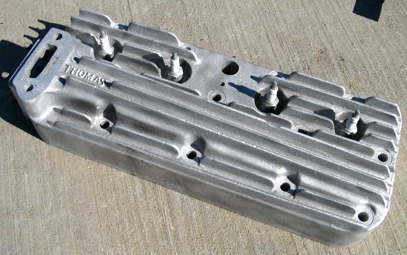

    I was going to ask about the head as well. I've got a thomas head. I was wondering how much relief you cut into it?
    Have any pictures of the under side of the head? Here's mine.

    No I dont have any pics of the underside, I allways forget to take pictures as I build.:mad:
    I did'nt cut relief in the head, I trimmed of the pistons instead, cause I only had acces to a lathe. But it works just fine.
    The chambers in my head was much longer and much narrower, so now they are sill long, but a little wider.
    Yours looks like winfield chamber design.

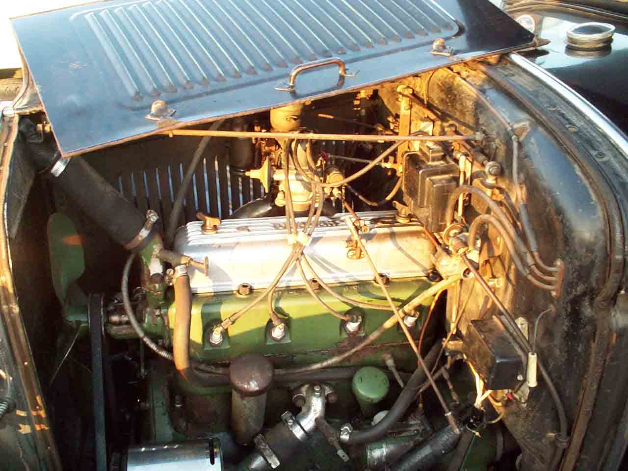

    I've got this. It's fitted with a quickchange rear which theoretically dates it a little later, other than though that it's pretty much pre war.
