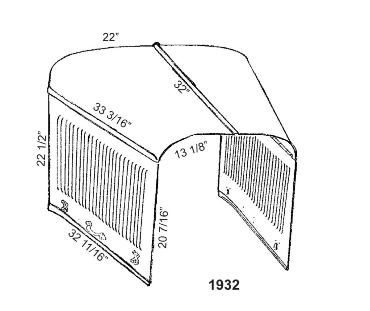

    The 32 Ford hood is the same for a truck or car and ironically measures 32" from the cowl to the radiator shell.
    Both '33 & '34 Ford truck hoods measures 29 7/8" from the cowl to the center of the radiator shell, remember the radiator shell leans back on these years. HRP

  14. pkhammer
    Joined: Jan 28, 2012
    Posts: 851
    pkhammer
    Yes, that helps a lot! With the radiator/shell mounted I can still tip it fore and aft a little so having the measurements at the belt line and at the bottom of the hood will be valuable getting everything set just right. I would ***ume I should figure on a little (1/8") hood clearance at the shell and the cowl so maybe add a total of 1/4" to those measurements so set the actual shell-to-cowl distance?
  15. pkhammer
    Posts: 851
    pkhammer
    I had to tip the top of the grille shell/radiator toward the front and jockey the body around and bit but I was able to get 32 1/4" in the center, 33 7/16" at the beltline and 32 15/16" at the bottom. I added a 1/4" to the above diagram dimensions for 1/8" hood to body and hood to grille shell. I think I'm going to run with that! I've got 1/2" between the back of the cab and front of the bed and the rear tires are within 1/4" or less of being perfectly centered to the embossed sections in the Brookville bed fore and aft.
