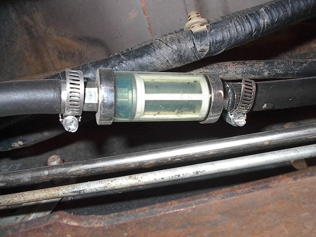

  24. Weasel
    Joined: Dec 30, 2007
    Posts: 6,696
    Weasel
    Absolutely DO NOT use one of these - it's an accident waiting to happen - unless of course you want your car to burn to the ground....
