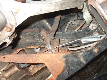

    Not the pass. side but this works on the drivers side.

    Thanks, I've seen that one before. What's the cross shaft assy. out of?

    I don't know. It came that way.
