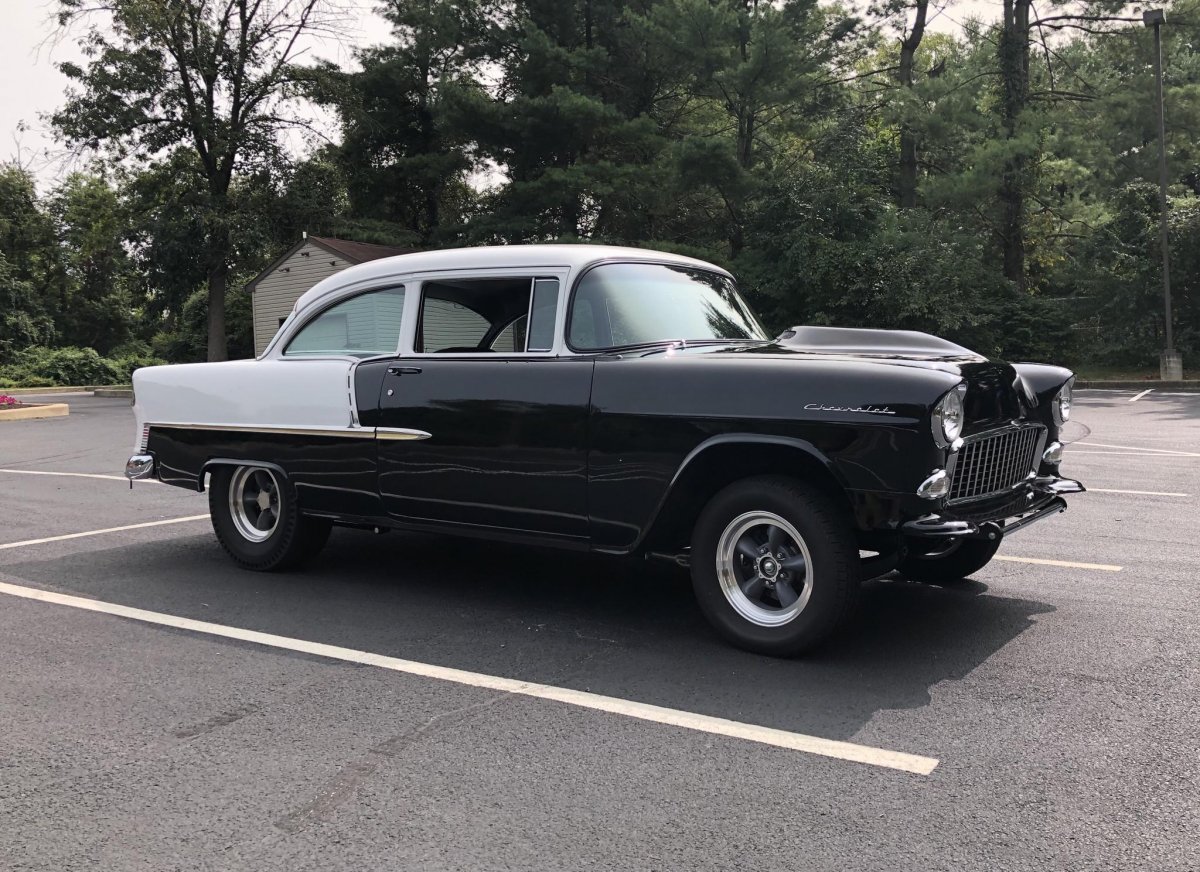

    Sure, it's been built to appear as a 60's c/d class gasser. Still on factory A arms, but lifted with taller coils and balljoint spacers. All steel body save for the Thunderbolt style glass hood. I'll have hood pins on it soon, I don't trust it on the track without them. Car is still on an original 55 Chevy chassis. With the hood closed it looks pretty period correct. It does have a Summit CDI box and MSD distributor and coil, but we plan to hide those when we rewire the whole car on the next few weeks. I run an EFI fuel pump with a bypass regulator, but I do run a carburetor. It has a modern K&N style filter with a filter lid, but those are simple enough to swap out if that matters for appearance.
    It will soon have a set of analog Dolphin gauges in it, but apart from that the interior is period correct as well. I have 4 wheel disc brakes with drilled and slotted rotors up front, if that's a concern for appearance. There is a line lock and proportioning valve under the hood.
    Battery is in the trunk and I will soon be putting it in a box with an external disconnect. I plan to run on my cheater slicks, so I will be installing a driveshaft loop. I also will be adding a 4 point rollbar so I can mount harnesses.

    Your car looks great , you will have no issues running with MANDRA, I look forward to meeting you
