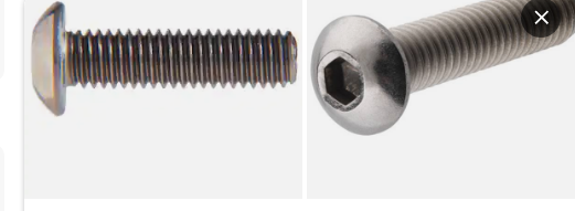

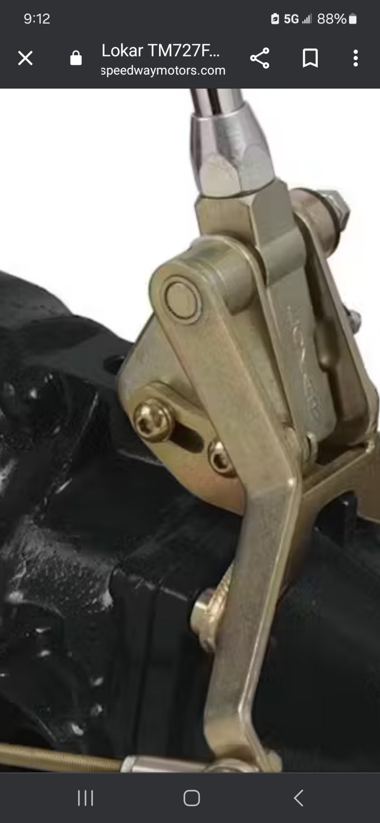

    Anybody know the specific name for this small stubby allen screws that go on your shifting ***embly above your plate . I lost one and my shifter bends out when shifting instead of being secured down

    ****on head cap screw

    Yeah, McMaster and other industrial suppliers have them but you might have to purchase a large quan***y. Is the bolt 5/16-18 or 3/8-16, and how long? I could send you one for the cost of the postage.

    And yes, they are "****on head" screws.

    Yes they're all too long it has to be mega short like 4 threads max cause your shifter as it goes front to back will hit. But thanks I found a site

    Any decent hardware and sometime big box home improvement stores will carry ****on head screws. IMG_2096.jpeg Squirrel I can’t tell from the picture if a normal hex headed bolt will clear the linkage, I believe the ****on head head isn’t as tall as a normal cap screw, I’ll check when I get in the garage latter.

    On a 3/8 unc the ****on head height is about .020 - .025 less than the head height on a grade 5 bolt.

    That thing looks so out of place. As a mech Eng, I would have never designed it with a ****on head type fastener. Also, is the one in the slotted plate used as a guide? Hard to tell. If so, the threads should not be used as a contact surface for the slot. The fastener should have a shoulder to guide the slot.
