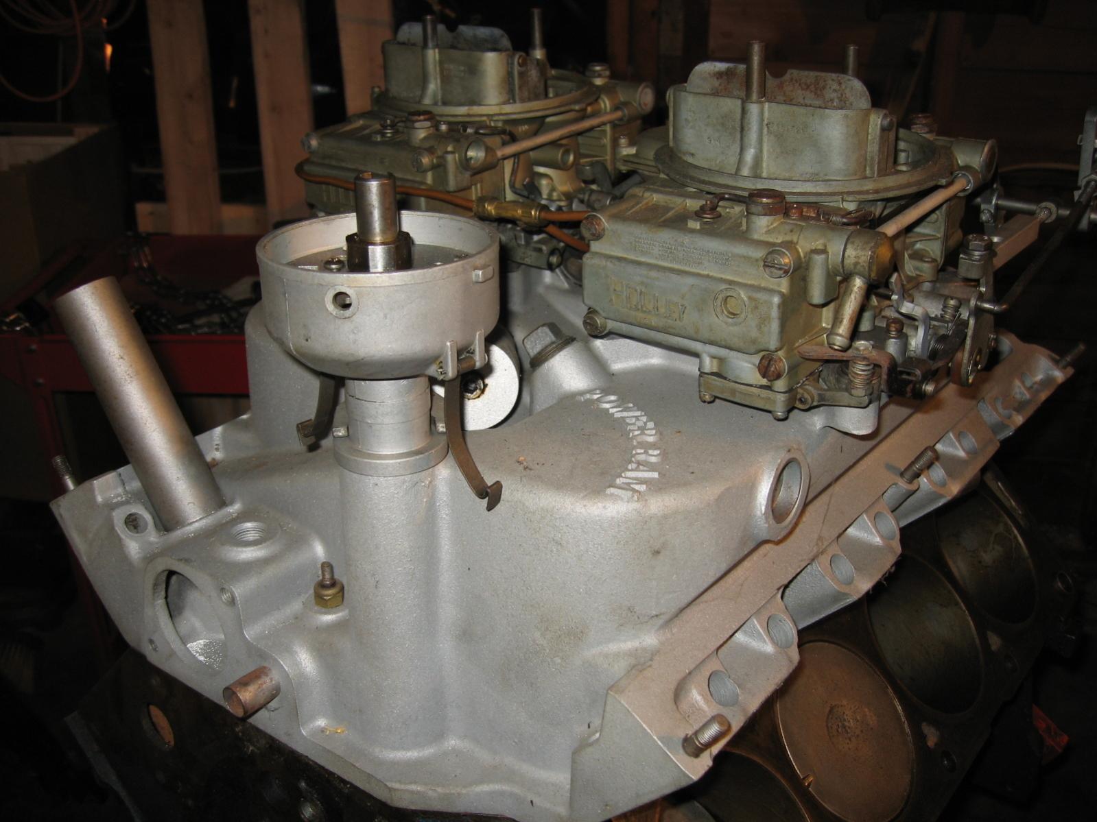

    Does anybody know what distributor to use on a 427 FE Ford with a Mickey Thompson Power Ram Manifold? The factory distributor will not fit in the hole.

    There seems to be a dozen fast eddies in the members section, could you be more specific or do you have a number? Thanks!
    Here is a pic of the intake and the distributor that is needed, but there is no ID on it.

  5. The MT cross ram manifold takes a special distributor adapter to extend the drive down to the cam gear. There have been photo's of it here on HAMB and also a drawing to have one machined. I can't seem to find my copy right now. I'll look this evening.
