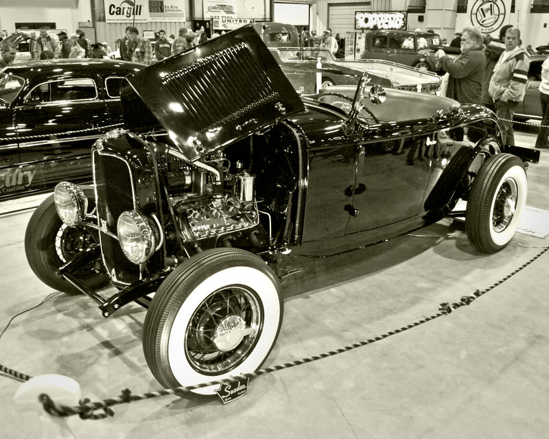

Tim at MN Hot Rod Hardware had mine made for me. I cut up 2" stantions to make it work. There was someone making 3" ones but the cost saving to do them myself was too big to not do it myself. Photo by Antibling

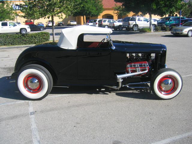

Here is a 3 inch chop with the correct top bows and irons. The top irons are difficult but Neil Gates now has the 3 inch irons available. Your seat needs to be low or you need to be short. I am 6' 1" and I just fit.
