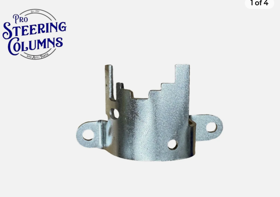

  9. Could a shift detent plate be used
    IMG_9507.jpeg 92f150
    I’m about to add a gm OD auto shift detent to a 56 Chevy auto column.
    vtx1800 and Toms Dogs like this.
