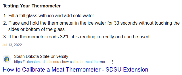

    I bought an Edelbrock 8604 thermostat (180 degrees for small block Chevy) - when I boiled it on my stove, using a digital thermometer, it didn't begin to open until around 187 and fully open at around 195.
    I figured, okay screw the high performance high flow Edelbrock nonsense and see how an AutoZone unit performed. Went and got a Failsafe brand 180° thermostat and boiled it. Began to open at 186 and didn't fully open until around 200.
    What's the deal here?
    Anyone have a suggestion on a reliable, proper functioning thermostat?

    Maybe your digital thermometer is wonky.

    Evey thermostat that I have every tested worked exactly like that.
    Unless your temperature measurement equipment has a recent calibration certificate, there is no guarantee that it is in any way accurate.
    Even a laboratory-grade T or K-type thermocouple has a accuracy range.
    Home-grade stuff? You'd be lucky if it is +/- 10°F

    Verify your test equipment when you think some thing Off,!
