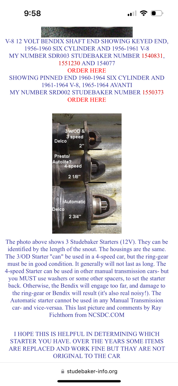

    I’ve acquired a 1955 Studebaker 259 bearcat with the “speed kit” and it is missing a starter.
    Hunting around for answers most of what I find send me to other forums many of which are now dead links. So here I am.
    I’m mocking a few things up and I have a rough idea of how big the starter is but I was curious if someone could throw a tape measure on there’s and tell me how long it is from the flange to the furthest forward point.
    It is a 3 speed over drive motor, I see that they have a different length nose but I haven't seen any mention of the body itself being different sized than others IMG_0342.png if you happen to measure what the diameter is as well I wouldn’t be upset either. Just trying to make sure when it’s mocked up in the car everything clears. I’ve got a couple Chevy starters laying around and thought if one was close to the same physical size I could hold it in place pretend it’s the right one

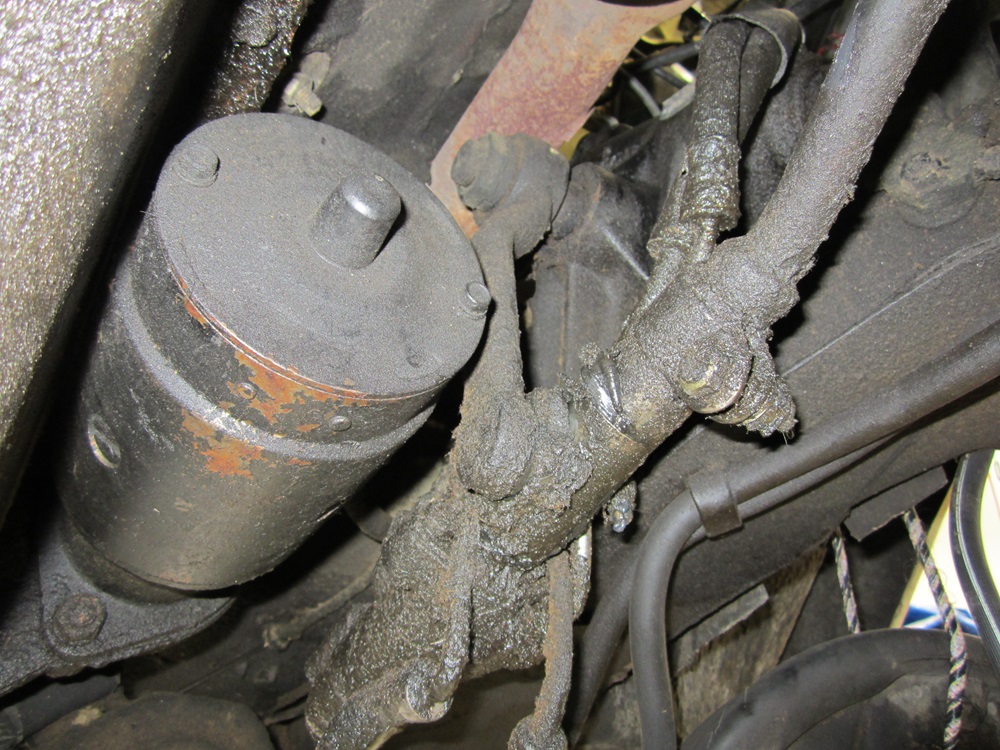

  12. I can get a measurement this weekend if needed, but it looks like a Chevy starter.
    Pic when I had my girls car on a lift just after I got it years ago.
    Tim likes this.
  13. oldolds
    Joined: Oct 18, 2010
    Posts: 3,616
    oldolds
    Studebaker used different electrical suppliers at different times. Sometimes Delco. Sometimes Motorcraft. Sometimes Prestolite. It can get interesting at times. It looks completely different but works.

    I googled six volt Studebaker starter and it brought up hundreds of tractor starters that look identical. In the case of IH the exact same starter was shown for the trucks and tractors.
    I have a starter, generator, alternator builder connection who also works with a lot of rural clients and I bet if I knew the nose cone depth for my application , I believe the photo above says 2” , and the drive gear tooth count and pitch he could open a Hollander guide and find me one or just make me one with the part bin.
    I’ve found that the 6 volt starters have a thicker drive shaft and a different tooth pitch than the 12 volt cars. But no one’s listing specifics on what either are.

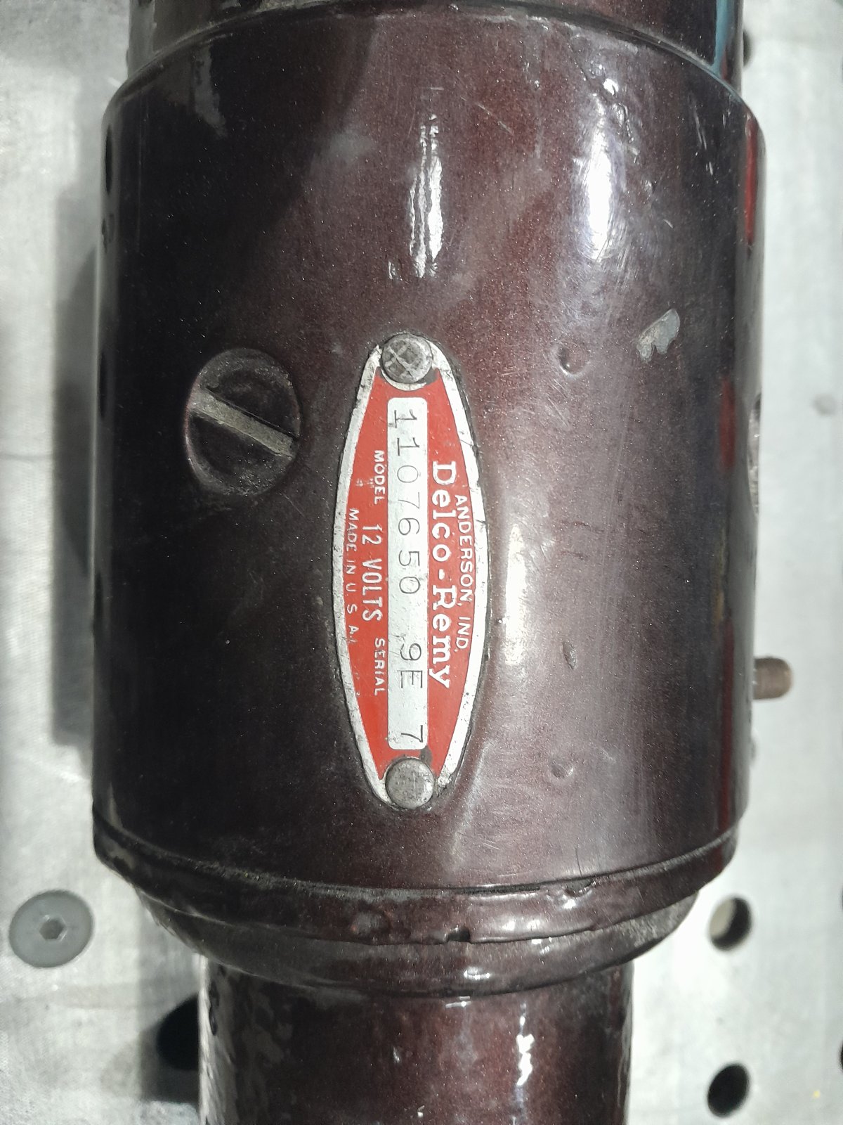

  20. Rynothealbino
    Joined: Mar 23, 2009
    Posts: 439
    Rynothealbino
    6V starter that is mated to a truck 4 speed.
    12V starter that had a manual of some sort attached.
    Both are around 4.5" in diameter.
    Is your car manual or automatic?
    If you called any of the major studebaker parts suppliers they can probably provide you with a part number if not a N.O.S. starter or a rebuilt one.
    My neighbor runs a Powermaster starter meant for a Jeep of all things.
    Tim likes this.

    Thanks! I have a three speed with an overdrive behind it. I’ve seen mention of guys using a 4 speed unit with it shimmed an 1/8 back for the 3 speed overdrive use
    Again thank you for the dimensions I’ve been looking for :)

    @Rynothealbino ive been going threw websites and catalogs trying to find part numbers and information.
    it really looks so generic that with the right starter shop, maybe one that does old tractors, you could build one out of the parts bins.
    you have both a 6 and a 12 volt starter and from this mornings digging I see they should both have 9 teeth on the drive gear.
    the 6 volt has a bigger shaft so based on what I read the diameter of that gear should be larger than the 12 volt.
    I think if I could get a measurement of that drive gear. Tooth count, diameter etc. that you should be able to make something work as long as it bolts on, has a 2” snout and the correct drive gear? That seems pretty straight forward if you have the information on hand to hand the builder
  23. Rynothealbino
    Posts: 439
    Rynothealbino
    On the brown starter I measure around 1" diameter with 9 teeth on it.
    Tim likes this.
