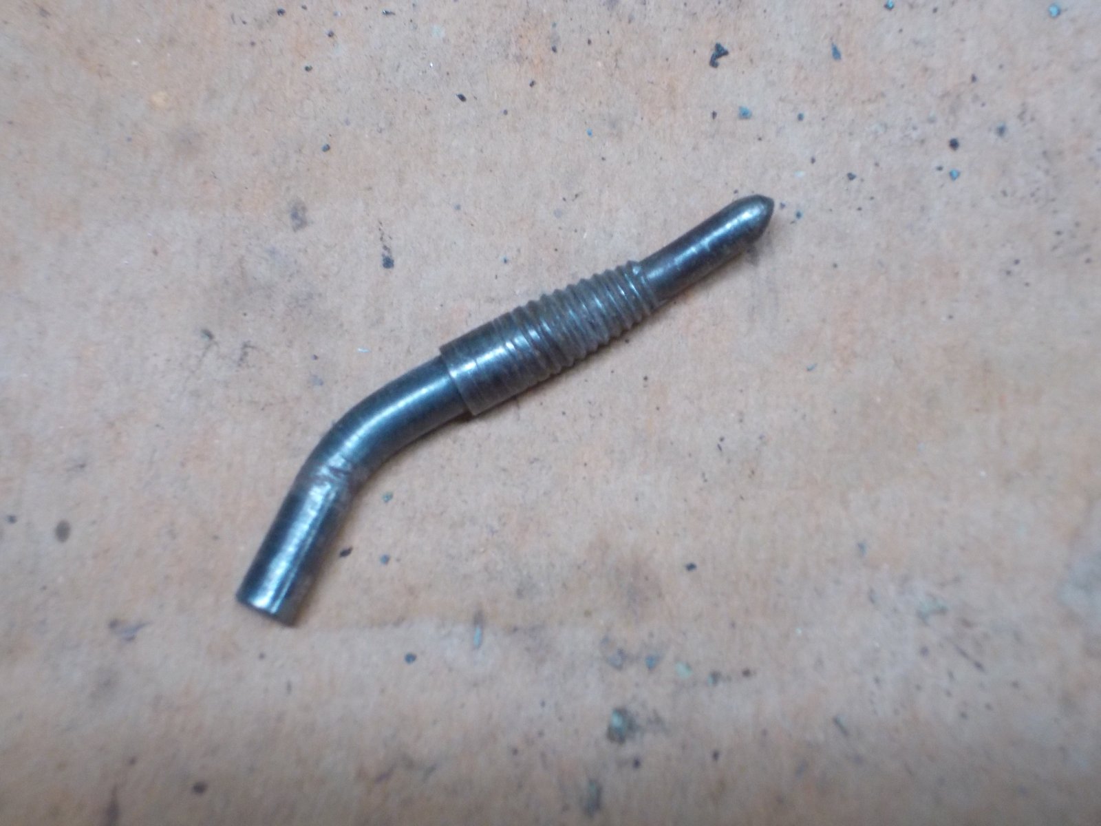

    No explosions, but this HF tootsie roll arbor failed @ 20,000 RPM. Darn near broke my wrist before I could jerk the grinder plug out of the wall. Beware

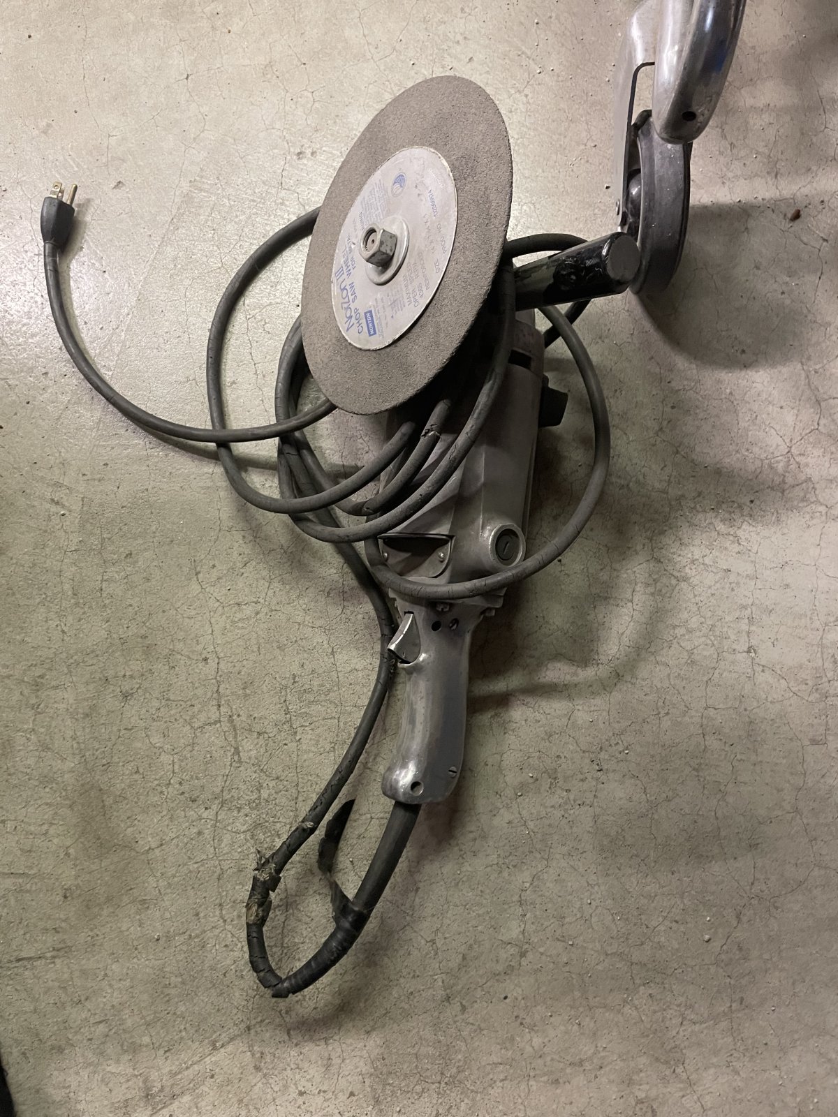

    IMG_3835.jpeg When I get serious about cutting something off, I use this. My brother used to use a 12 “ wheel. You better hang on.
