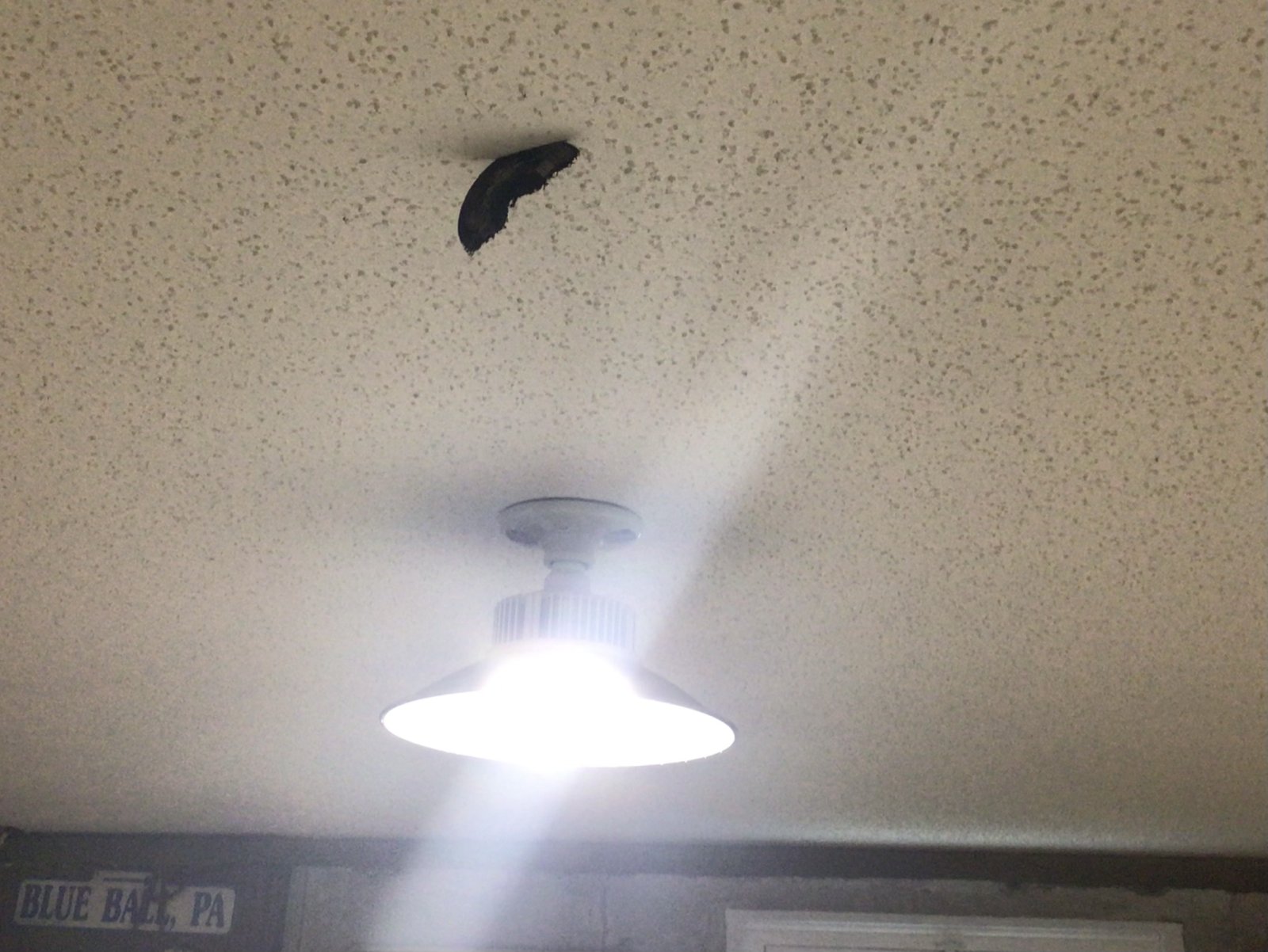

  20. edcodesign
    Joined: Mar 30, 2007
    Posts: 4,890
    edcodesign
    alanp561 likes this.
