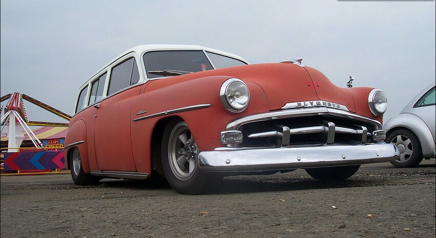

    A friends ride, I think its got stock 'rails', but front suspension has been changed to Jag.

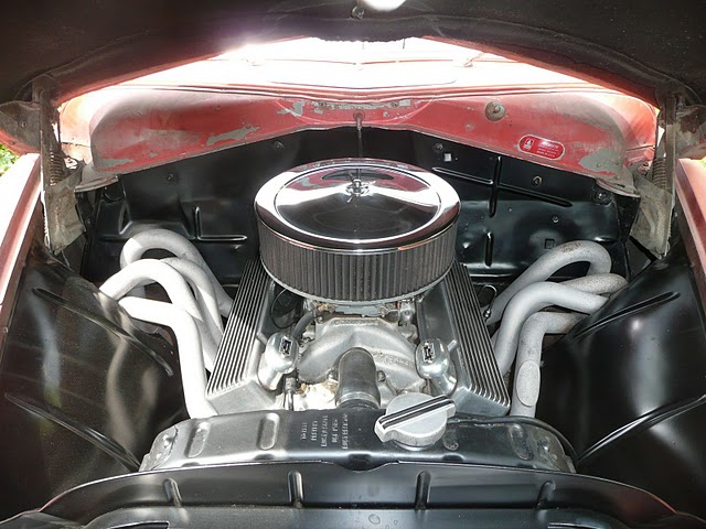

    I put a 283 in a '51 Plymouth with a/c even! 7.jpg
