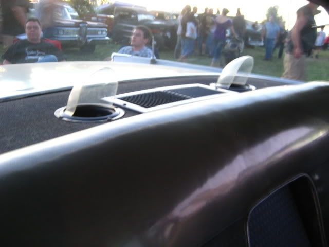

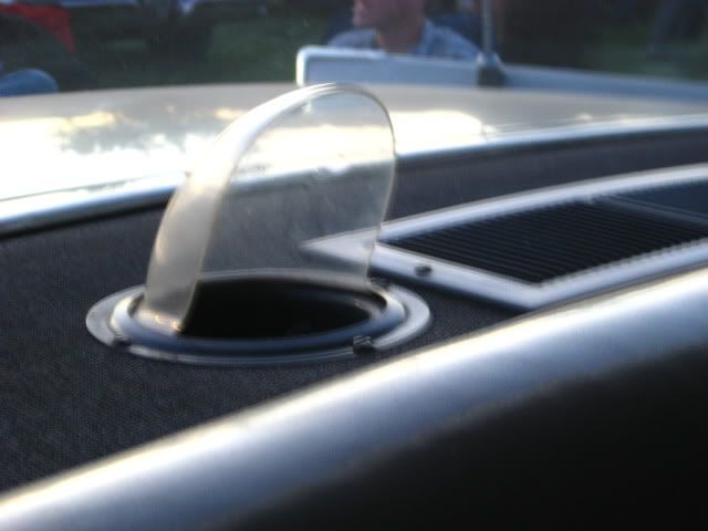

    This is now 3 pages and I'm the first to post pics???:eek:
    Here's what the Vents look like in the Package Tray of a Lincoln.
    (click on the pics)
