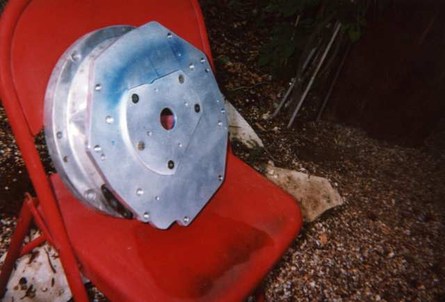

    I blew up my monza 5 speed at the track , and bought a new tremic 6 speed . 4 year`s ago , it was 2,600 buck`s , I love it . the shifter is in the case , and it`s at just the right spot ! for my 32 ! and the ol flathead pur`s at 2,000 rpm doing 70 going down the hwy, with a 3.80 detroit locker for the drag`s ! took me 2 week`s to make it all work ! but well worth it . the doug nash would be easer to atach , but I wanted this one . my girlfriend lafted at me when I was taking pictures of my tran`s adapter ! so I got rid of her ! hahaha .
