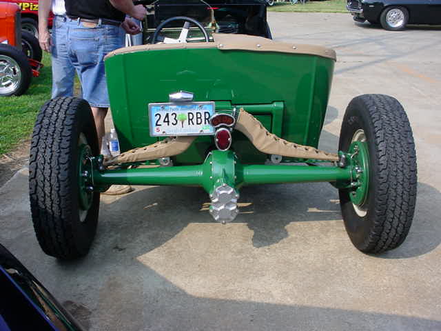

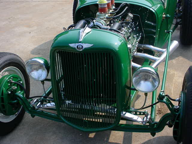

    Any more pics of the green mod above? ******in!

    Hey HRP where did that pic come from??? Thats sweet......

    Yeah,the Trackster belongs to Alex ,,,,he lurks around here from time to time,,,,HRP

    Alex lives in South Carolina and the car is small and he ain't,,,,,,a picture of it is in this months Rod and Custom
