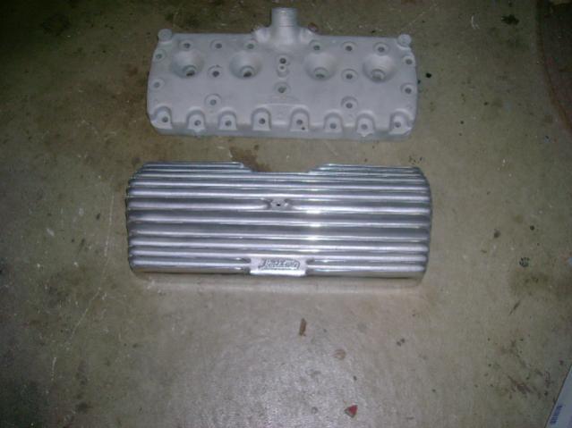

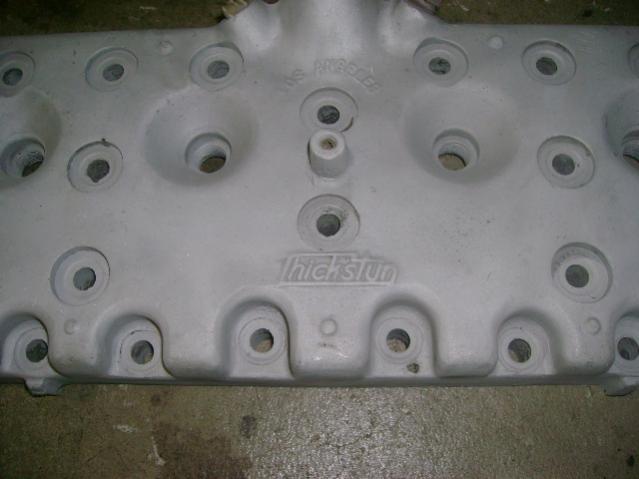

    When I first came down with the illness I contacted two Thickstun gurus. I got an air cleaner from Mike Russell who said he had never found a pair of useable Thickstun heads. And Jay Fuitzhugh helped me find these heads. Jay told me that he's never seen Thickstuns with provisions for two water temp senders. He thinks they were made after Tommy Thickstun passed away---probably in 1947 by Tattersfield. And Jay told me recently that he's switched away from his Thickstuns back to cast iron heads due to leakages.
    http://jalopyjournal.com/forum/attachment.php?attachmentid=532063&stc=1&d=1226538304
    http://jalopyjournal.com/forum/attachment.php?attachmentid=532064&stc=1&d=1226538304
    http://jalopyjournal.com/forum/attachment.php?attachmentid=532065&stc=1&d=1226538304

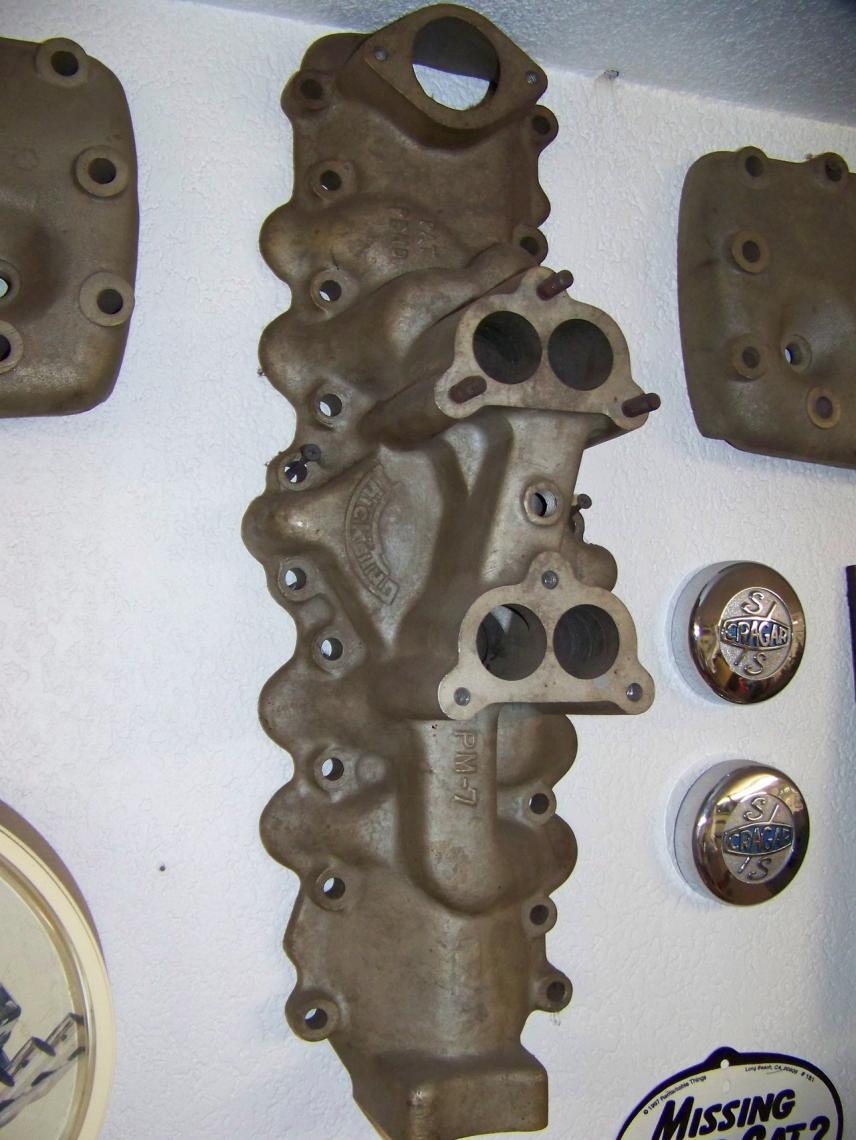

    Wall hangers? No way. There rare, but they aren't that rare. I've seen some go unwanted on ebay ...cheap. I got these from ebay and paid less than you would for a set of Eddie Meyer heads: [​IMG]
    RUN THOSE HEADS. Tommy Thickstun ment them to be ran, not hanging on a wall.

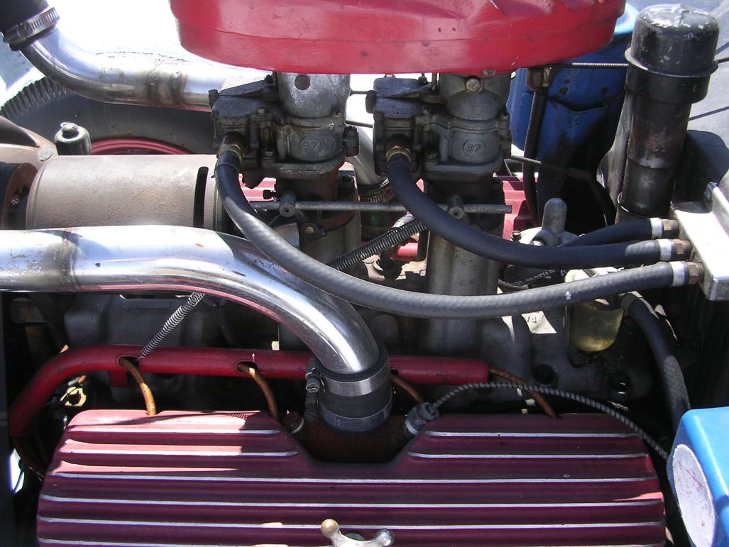

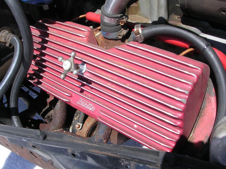

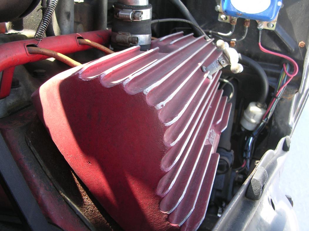

  11. The covers I have I think are repo (although they cost me a motza), but having said that they fit stock heads nicely, no wierd gaps, or unsightly problems....these are the only photo's (both of which are a few years old) I've got handy of my covers..
    Those heads deserve another chance at life.....willing to 'test' them for you on my flatty;):D

  16. a piece of plate with 2 holes in it that are sandwiched under the head nuts, which has a stud welded to it, which fits in the hole in the cover, with a 'acorn nut' (which I loctite in place) retaining the cover. I've seen a few 'dodgy' efforts done to hold them down, so I just made my plate out of a heavier section, machined down the area under the head bolts, and then tapped it to hold the stud, with a small tig weld just for overkill, as I'm paranoid about what would happen if it were to 'fall apart' whilst driving around the crap roads where I live.

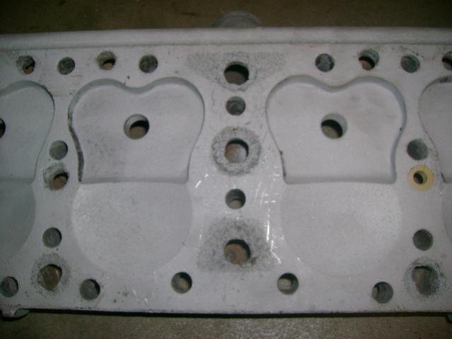

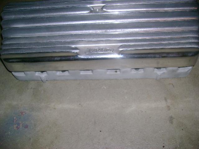

    Believe me I agree, they should be run. But I don't really want to be baling water out of the oil either. After hearing about the leakage problems here's what concerns me. Check out the porosity around the three center water holes on the one head. The combustion chambers look good. The other head has one tiny fixable crack but no porosity issues.
    http://jalopyjournal.com/forum/attachment.php?attachmentid=532107&stc=1&d=1226542813
    And here's how badly the repo cover fits an original head.
    http://jalopyjournal.com/forum/attachment.php?attachmentid=532108&stc=1&d=1226542813
    My heads are aluminum.

    I don't see anything there that can't be fixed on that head. However, the covers will never fit without a great deal of 'reworking'...
  19. ditto....whilst I think that the porosity is of concern and could potentially get ugly real quick, if you can find someone who knows his alloy and is willing to 'tread lightly', those heads are redeemable, and definately worth the effort.

    Kris. Thanks . I don't see a real problem in modifying the bottoms of the covers to fit the heads.

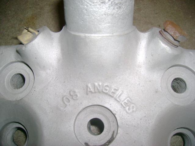

    Here are my wall hangers..........
    how come some of those pic's say L A on them, I thought they were made in Canada.

    You've got factory Ford aluminum heads made in Canada, also known as "cheater heads" because they were painted and looked just like the cast iron ones when painted.
    Thickstun heads are cast aluminum also, but look nithing like the Fords

    Funny that the heads aren't drilled for hold down bolts on those bosses, or are the bosses just rests for the cover corners? and the center bolt the only holddown?

    Correct. There is only fastener, in the center of the cover. The covers rest on the tabs on the outside of the cylinder head (top and bottom), not the bosses on the top corners. The covers were intended for marine use to keep the plugs dry...
