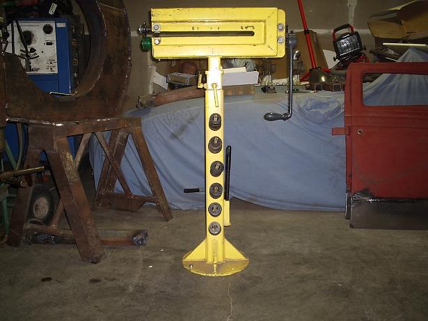

    you definitley want to beef it up. i couldn`t belive what a diference it made.

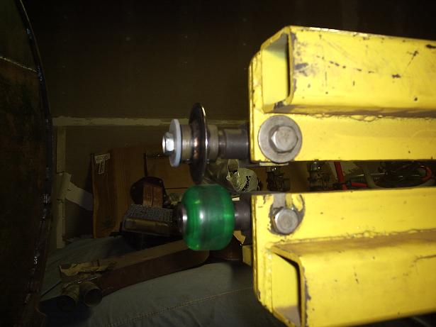

    here`s a pic of my modified hf roller and a pic of a tipping setup for it. the skate wheel needs to be a little stiffer. next up is motorize it.

    I have the HF beader and I am in the process of beefing this one up. I had one before and gave it to a bud, but I liked it enough to get another one. I stiffened the first one just like they showed on metalshapers. This one I'm gonna motorize and make a large frame for (also make longer shafts). If you want some tipping dies for cheap, just unscrew the shearing dies and screw on a hardend washer. Grind the edge of the washer for whatever tightness of crease you want, use a car bushing for the lower die.
