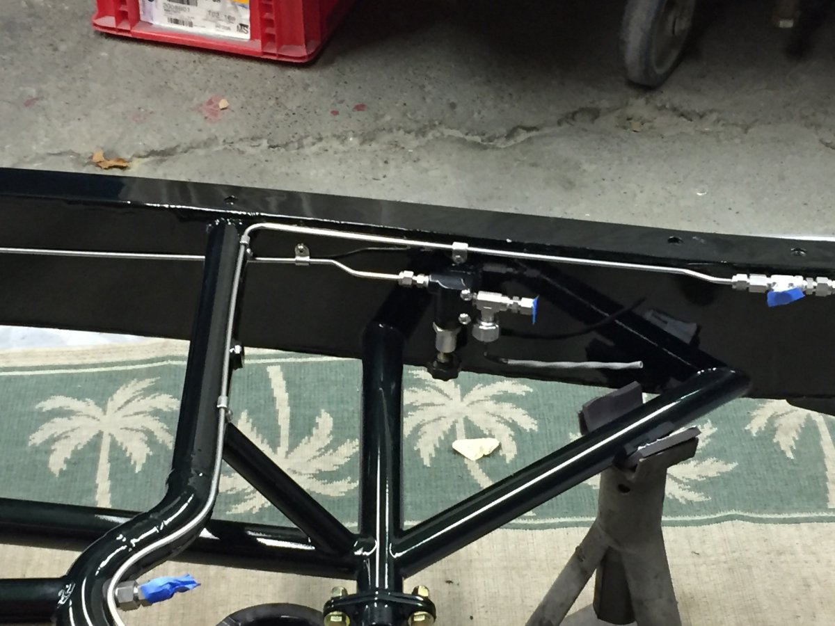

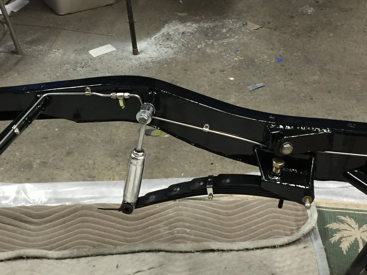

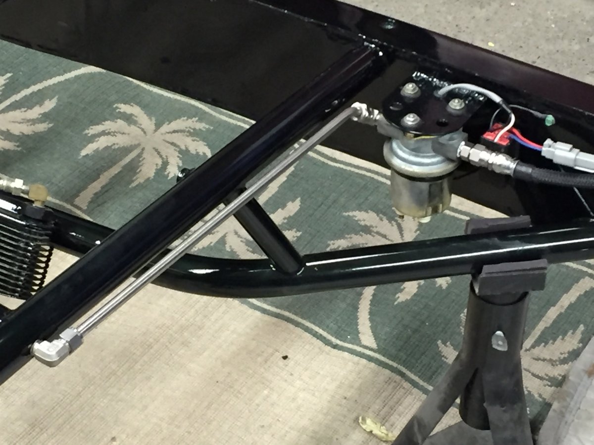

    from detroit
    A19261D6-C2BE-4DD7-9725-A6C10A2AD883.jpeg 1491DDA3-BFD6-4213-A723-72573B70A8C1.jpeg 0D5326B6-D047-40C3-A4B9-883FEC13DC39.jpeg Used them for fuel and brake last 2 cars
