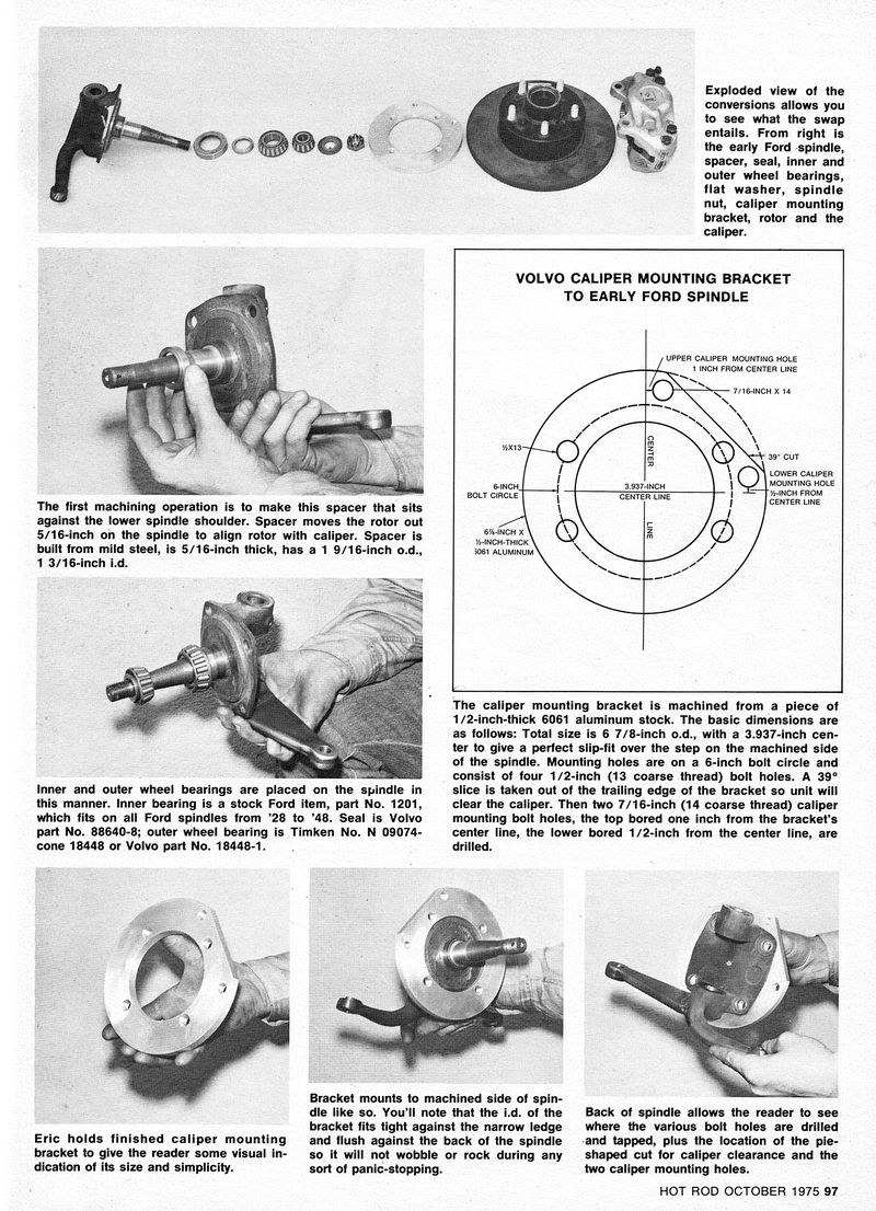

  9. Xdrag48
    Joined: Mar 1, 2009
    Posts: 477
    Xdrag48
    Here is a setup from Pete & Jake from 1975...

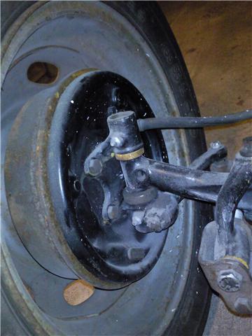

  18. hotrod-kustom
    Joined: Mar 18, 2008
    Posts: 57
    hotrod-kustom
    Ok Paul, now I have pics on Volvo 444/544/P1900 Spindels on Anglia axel.
    We did make kingpin whole 2mm bigger and a distance on ower side because Anglia axel its small. On left spindels we did make a steringarm Typ Speedways for steeringbox onthis pics we mock up radiator shell and see if its going down with new design on frame ends. We did come ower P1900 parts have a outer design on brakes then Volvo 444/544 and only made in 66 or 67 ex! Volvo have same bolt cirkle at USA Ford and easy to find wheels to and all its in inch
    Not the best photos:)
