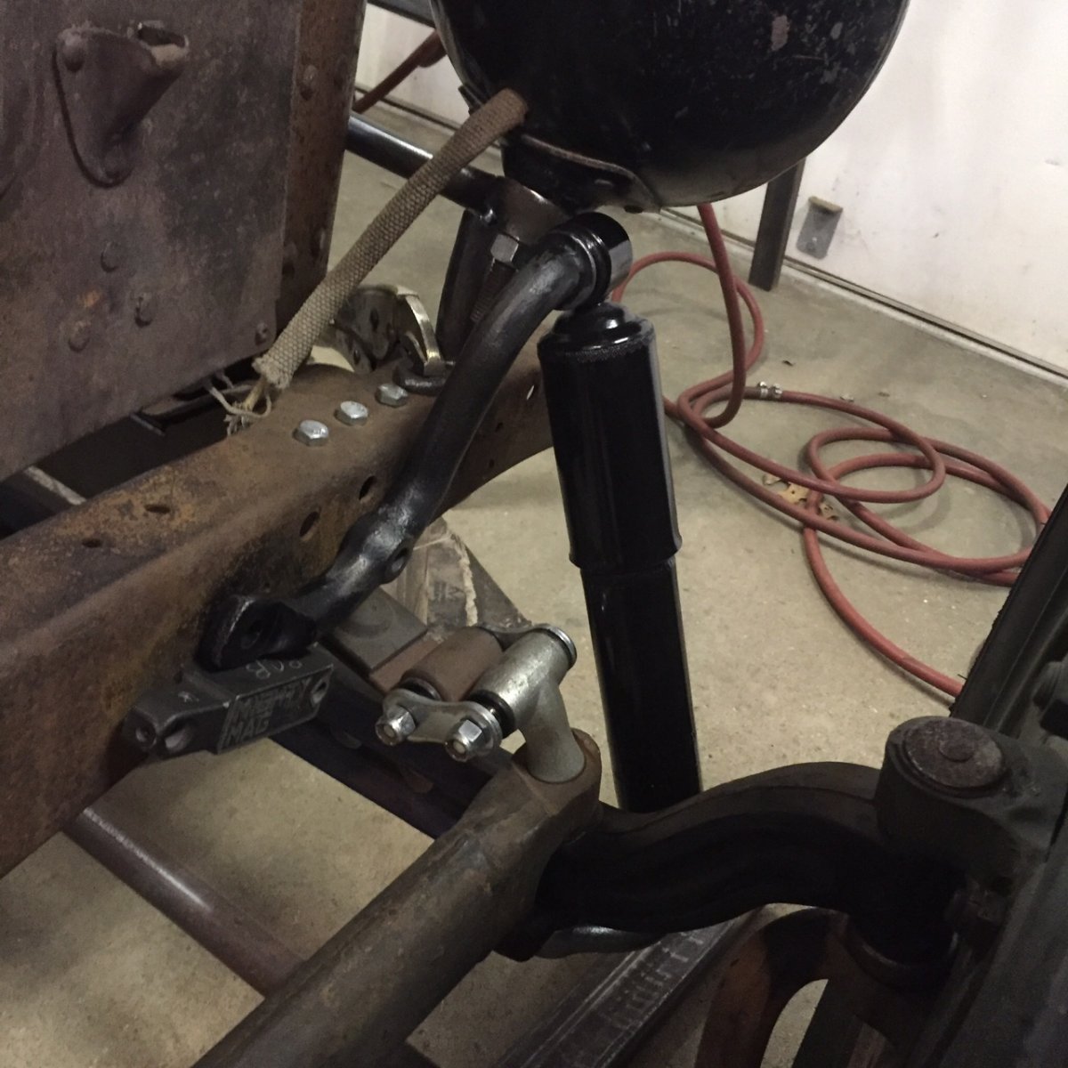

    shock.jpg Those shocks are listed as gas charged shock.I used a Monroe shock similar to the socal.I haven't driven the car yet but realized after I put them on and tried to bounce the front end there going to be too stiff.Really need to find an old hydraulic type shock.Ive looked for a few weeks and havnet found anything yet.

    31Apickup
    The Monroe shock would be for a 1950 Plymouth, have the part at home, run them on my Model A

    shocks are 5752 Monroe,cover a wide range of applications from mid to light weight front ends.I agree the only thing that made them look usable was the looks and the travel range.Had to start somewhere and they were pretty cheap cost wise.
