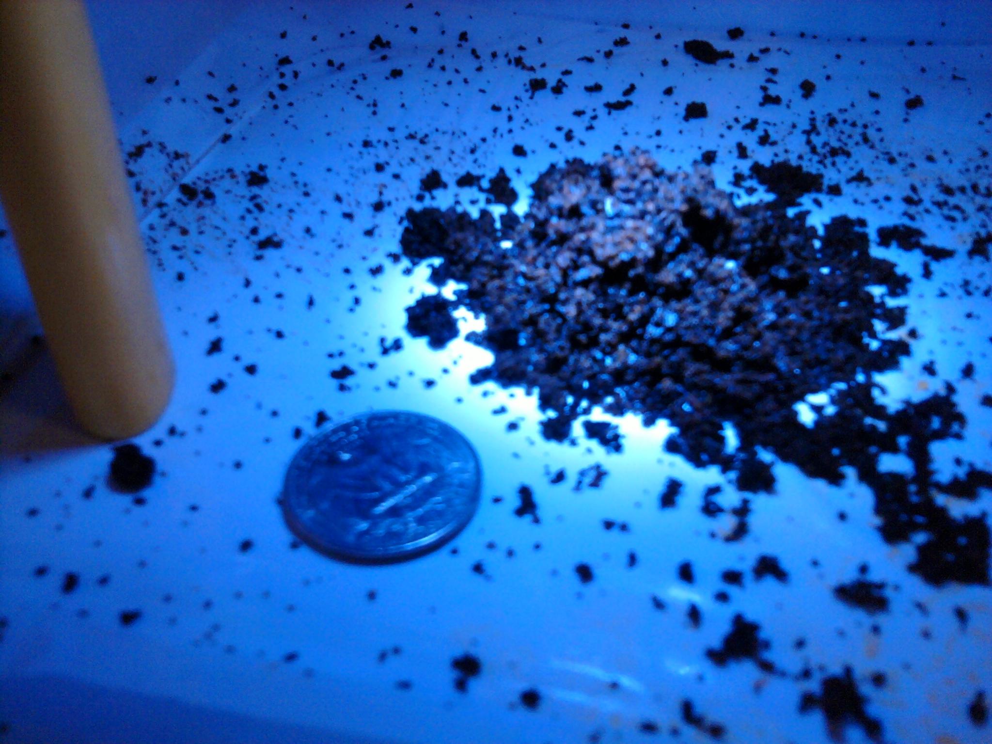

    So I tried the Nylon stocking trick in both upper hoses. I took the car on a 320 mile round trip. ( I also removed both thermostats so to eliminate any restrictions in flow) The first 160 miles it never got over 180. On the return trip after about 50 miles it started to gradually increase to the point that my last 20 miles were at about 205* after it cooled I pulled the nylon stockings out to see if any debris had been trapped and this is what I found.

    I think the handfull of rust confirms the problem. On the return trip the temp started to gradually increase from the stockings beginning to get clogged up from all the crap they were trapping. Besides the bigger stuff that I showed in the picture they the stockings were clogged with a very fine layer of stuff that I had to wash out of them after turning them inside out.

    Russco, seems like you solved your problem. Great! The loose rust seems to make sense considering the intermittent nature of the problem. Thanks for the feedback on what you tried and what worked. How about posting an explanation of how you used nylons as filters in the upper hoses. Did you stretch them tight, leave them loose like a sock, wad them up, or what? Did you put them on the heads or at the radiator? Filtering the coolant is a good, easy technique to troubleshoot/resolve an overheating problem.
