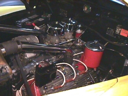

    Here's my '47. I've had it on the road about 2 years now after a 30 year slumber. Still sporting old paint and such. Running isky cam, and edmunds goodies.

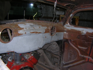

    Just finished painting a 47 ford coupe, molded in the rockers and rear fenders and roll pan, shot flat black. It's got nova front sub and sits pretty nice, drives well.

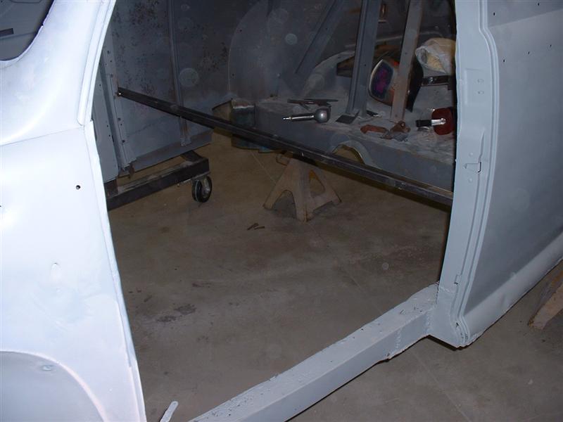

    Been working on a '47 for a bit now. New inner rockers front to rear on both sides were the biggest headche. EHS ( I think that was their name, can check if you need it)in Cleveland makes a nice piece for this, each side actually comes in 3 separate pieces.
    Completely re-wired but still 6-volt. Also installed a mono-leaf in the front, gave it a 4" drop. Have one for the rear as well and will put it in this wihter. Original drive train, stripped off virtually all the trim and filled the holes. I'll try and get some pics up.

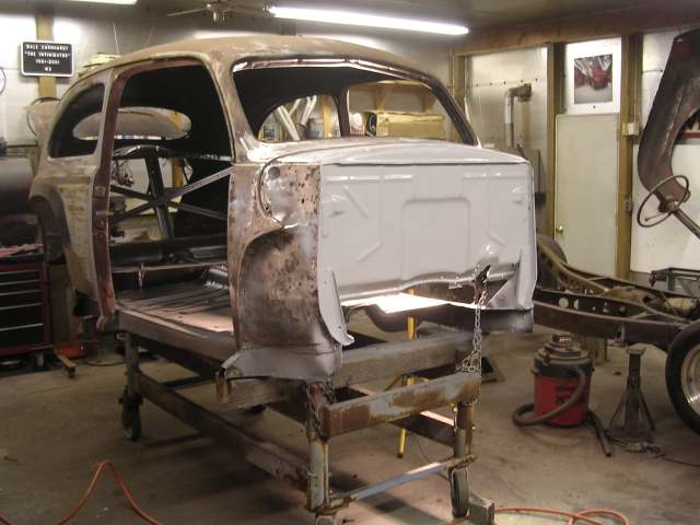

    Here's one were working on for a customer. It's a rusty sucker or should I say was. We installed new rocker boxes, floors and a firewall

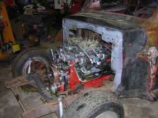

    It's got a 56 354 Hemi that was dropped in there in 1958. A Clutch-flite and 9 inch ford round out the drive train.
    I started with a Business coupe that I Chopped the A pillars 6 inches. Cut the whole roof loose and moved it forward to line up the A-pillars. then I moved the B-pillars back 8 1/2 inches and installed sedan doors. I cut up 6 doors to make two the way I wanted. So I now have a 48 3-window coupe that has sat in my shop since 1993.
