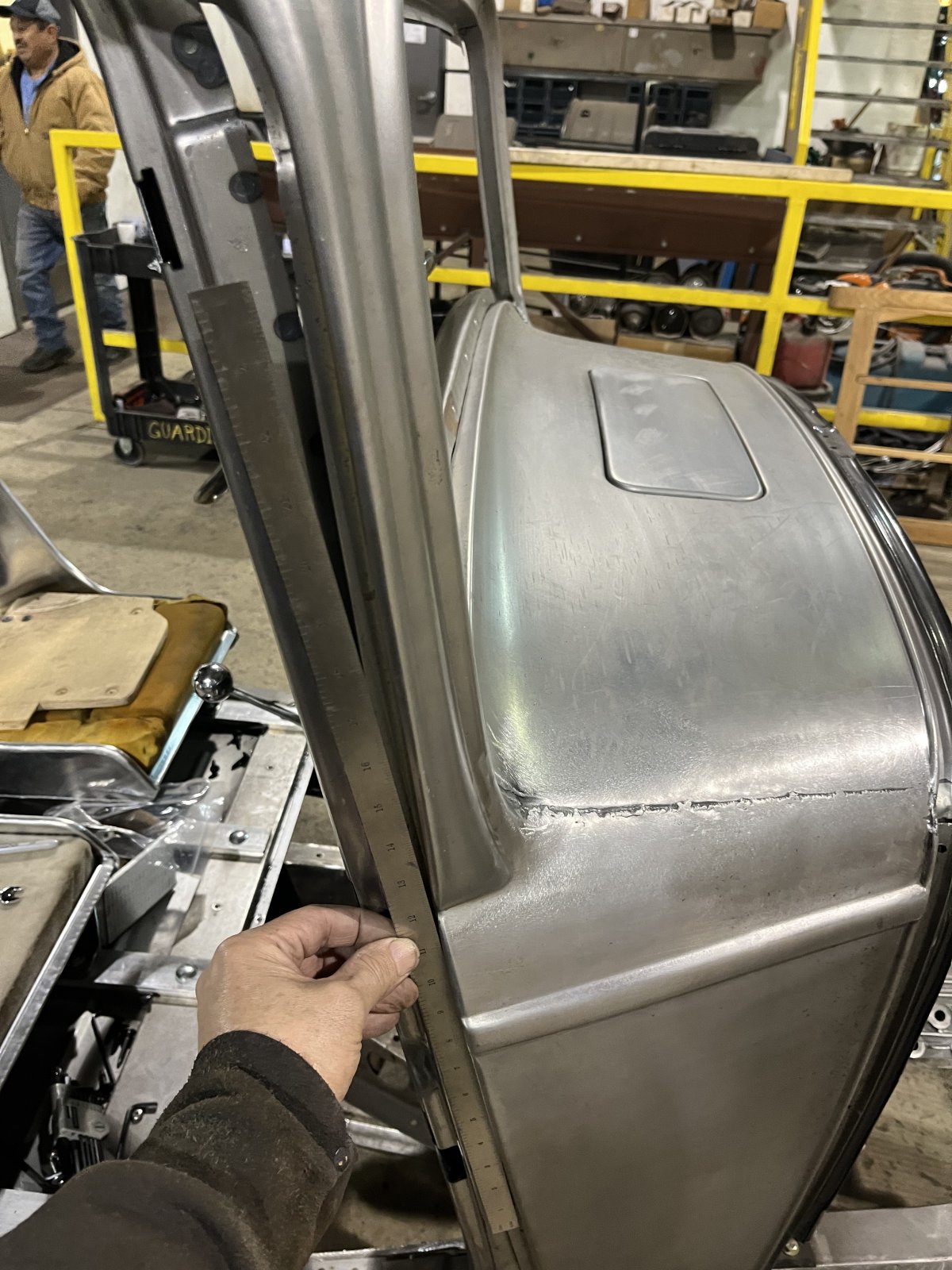

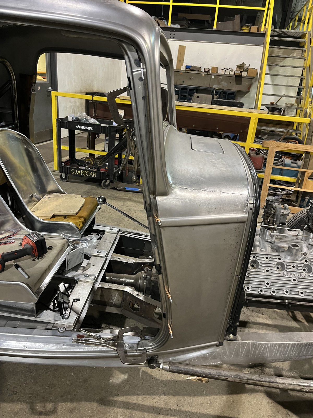

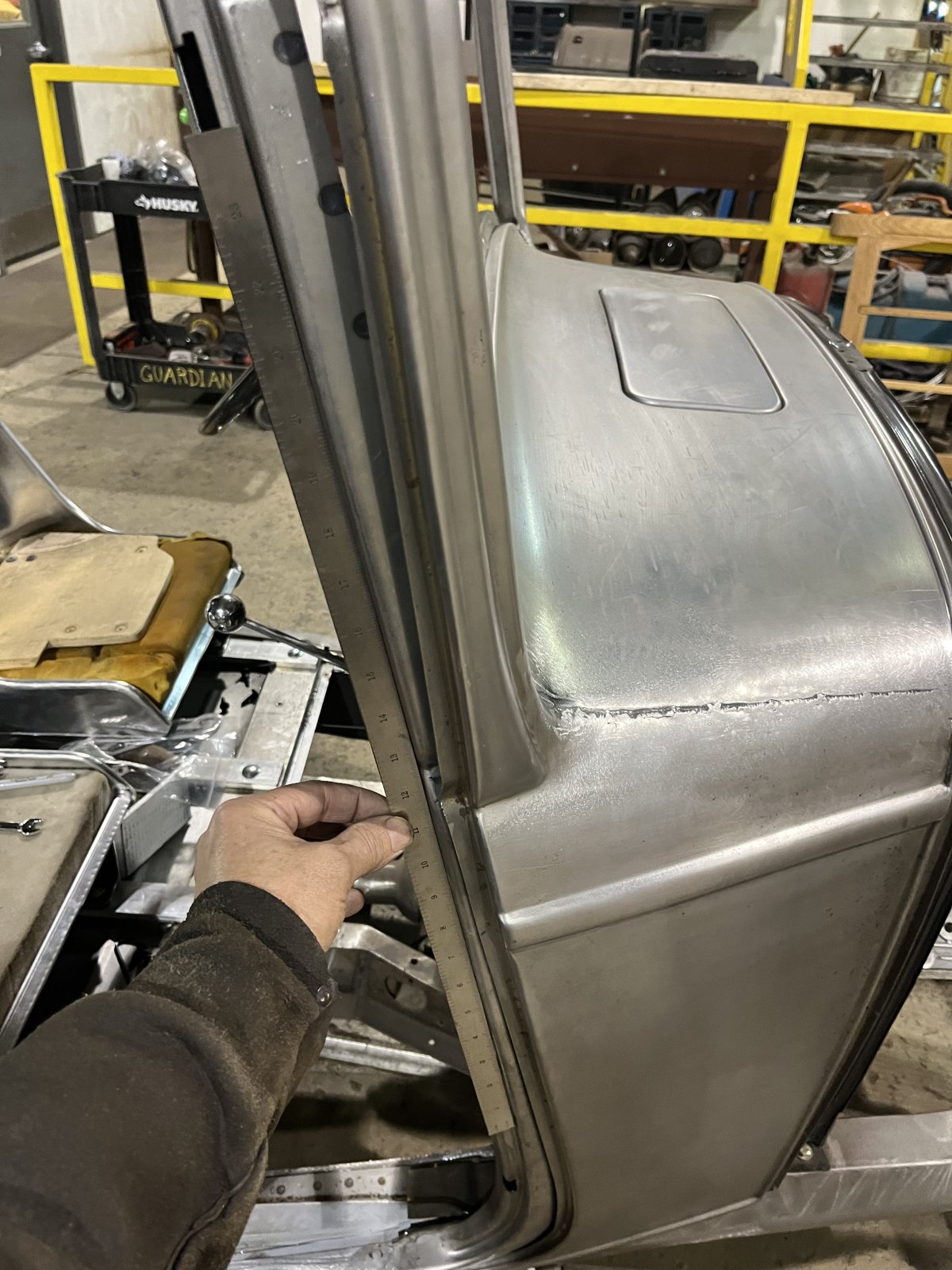

    D595AA98-CBE9-4C7B-AAE9-E2FCD3BB55E4.jpeg The A-pillar****embly is straight from top to bottom.
    The body has the windshield A-pillar leaning more forward and not a straight line. B942EB7A-17D8-479B-B21B-43E68D54468B.jpeg
    Just not sure what’s off and how to correct this issue.
    It just doesn’t follow the body side.

    Can someone run a straight edge on their 3-window and see if the body is supposed to be dead straight at the front edge of the door opening?
    Yes, The sides are stamped in one piece.

    Just checked on mine. Looks very straight. A 2 foot approx straight edge shows its straight accross the side molding on the A pillar, so about a foot either side.
    My door aperture (painted) measures a hair over 39" at the side molding height.
    Hope that helps.

    Here is a photo of my OG 3 window. Being black it is a little hard to photograph. I held a straight edge up to the jamb and the top of the door opening in maybe 1/4 or 3/8 forward of being dead straight IMG_1951.jpeg

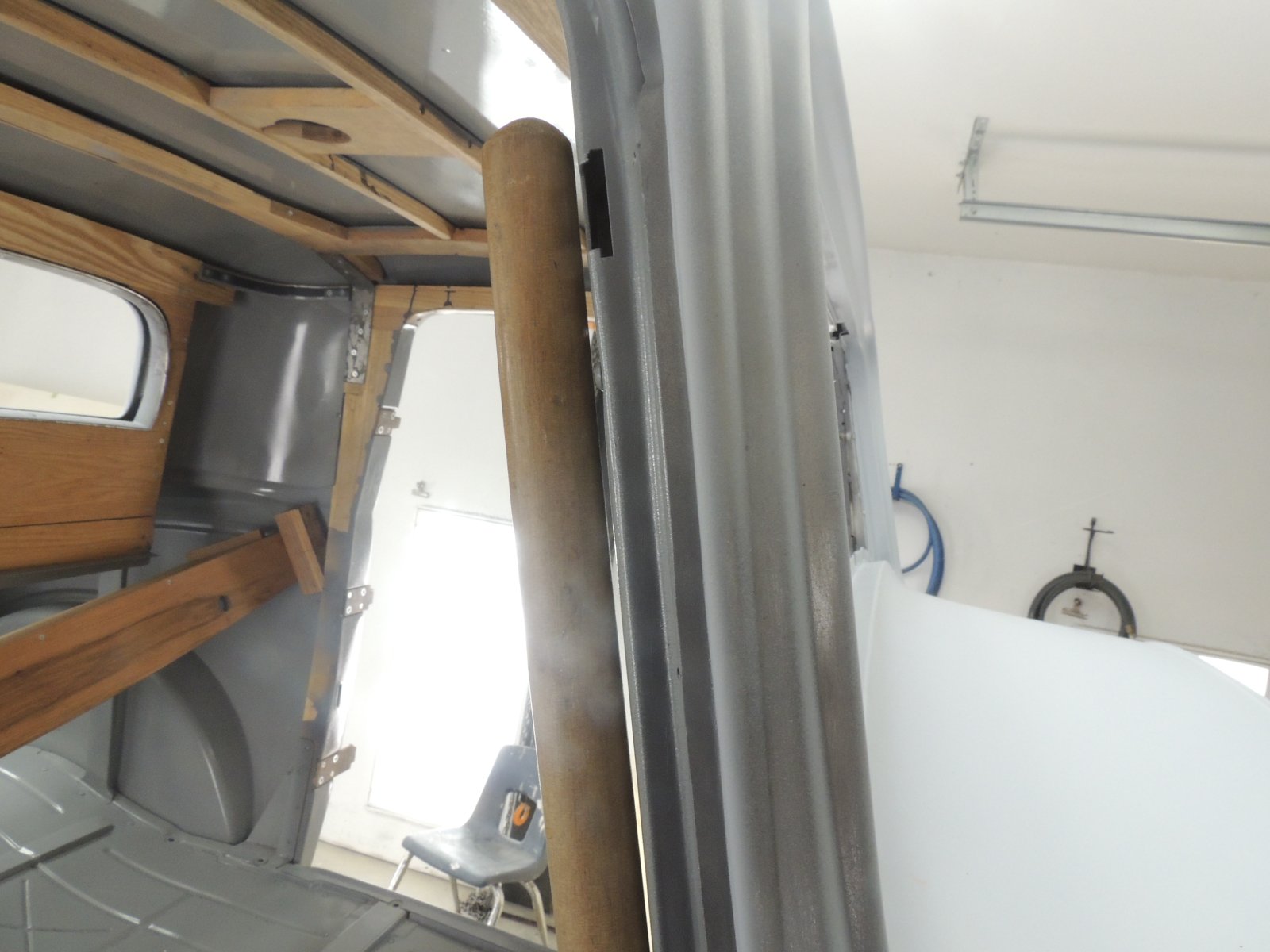

    Here are a few pics. The front is pretty straight between the arrows in the pic. Couple detail shots too.
    The broom handle was the only straight thing nearby............

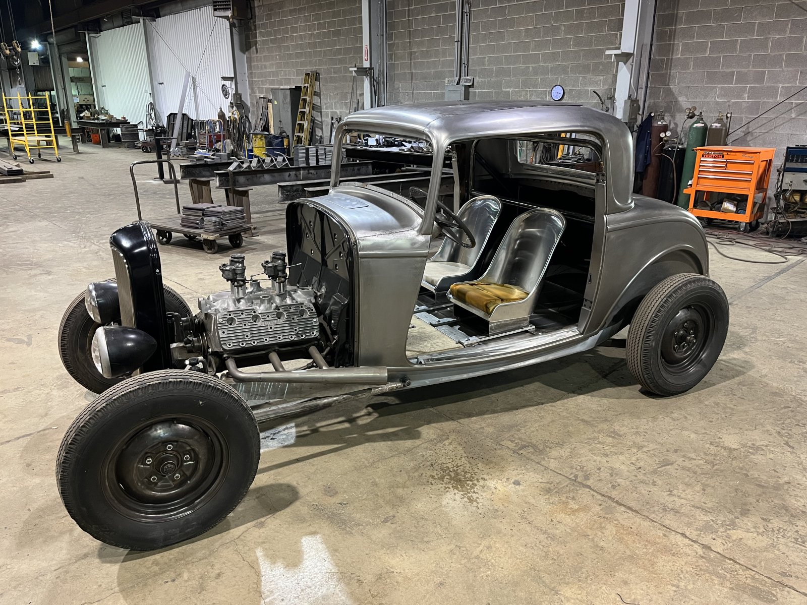

    DFA2995B-BF17-44A4-911C-25850A75BE64.jpeg Thanks for all the help. It looks like I need at straighten the body sides at the A-pillars
    this build is my personal project at work. I only get time to work on it at lunch. So it’s been 3 years already.
    3W Larry got me hooked and the Rolling bones guys keep me going. I’m going the full Schmidt here.

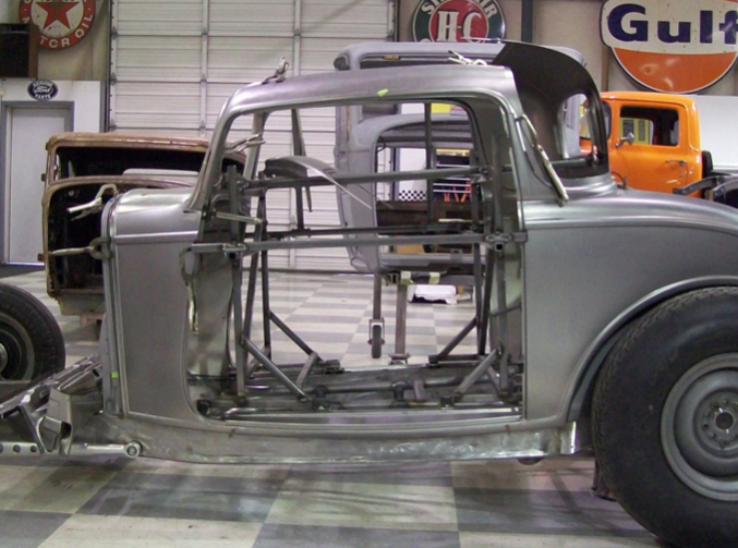

  21. Here is a side shot of one from with many moons ago.
    (Chopped)
  22. Could be the angle of the pic but the windshield post angle looks strange
    Stogy, clem and lurker mick like this.

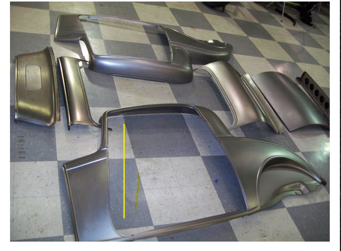

    here’s the parts.
    A-post look straighter

    I think if I push outward at the crease line it will help straighten the body out? The stamping must be correct and it just got pushed in at the weak area from stacking them on top of each other or pulling them out of the dies stressing that area or something?

    Either wait for your doors and chop it, or do heavy Rolling Bones style chop now, lean the pillars back, and then make the doors fit. I'd personally wait for the doors. Especially if you're already 3 years into it.

    Really difficult to tell from pictures, but my gut reaction when I first saw your pictures was the A pillar looks too upright. I didn't want to comment, because optics can be deceiving. Having said that, I agree with the others, wait for the door and use them as a datum. Especially if chopping, you can do whatever is necessary to make things right.
