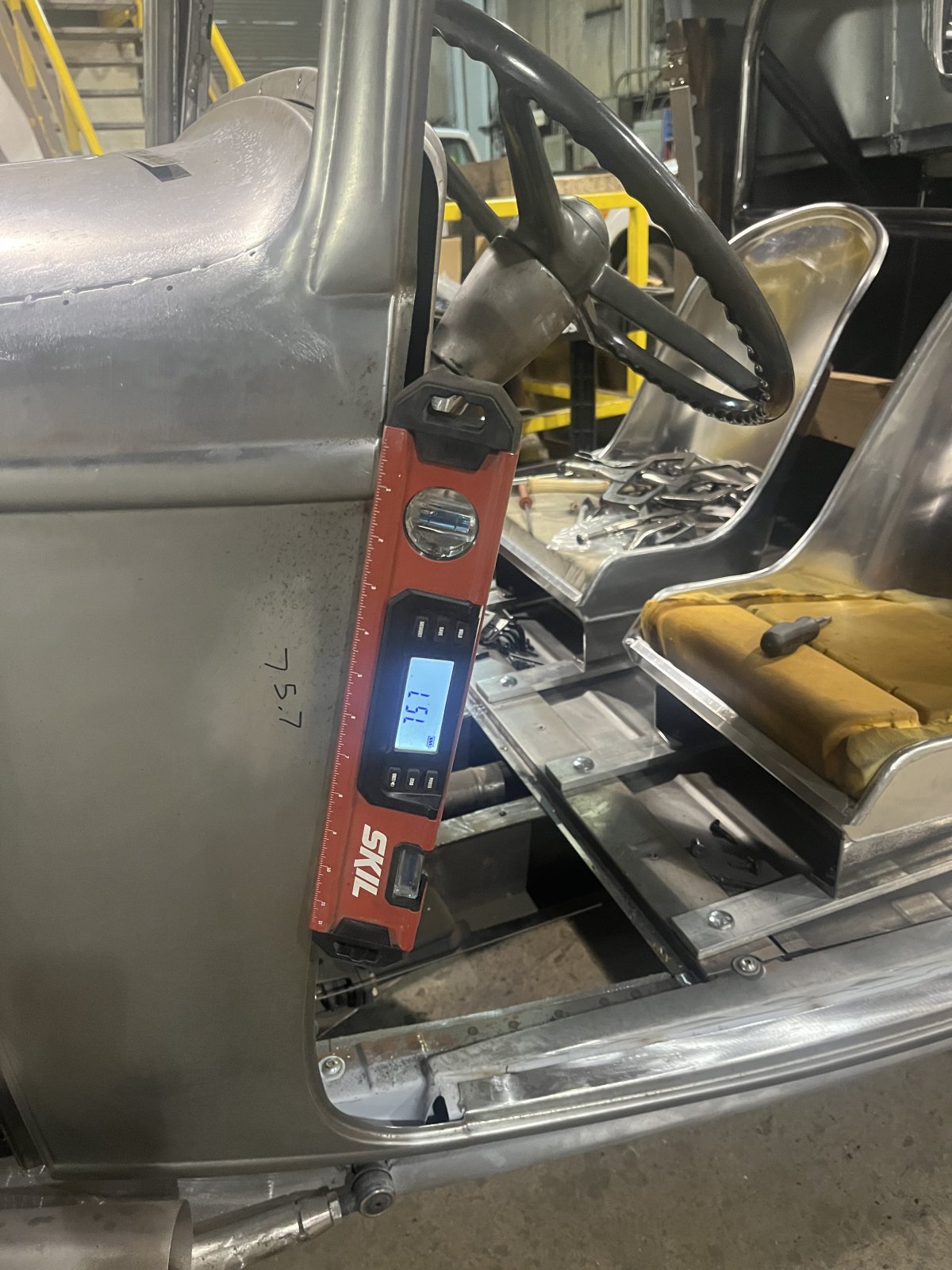

    FEE0956F-2475-42D6-B373-874D5548A309.jpeg 4566ECF3-F42F-4B86-A565-D4723B1A1A4F.jpeg E64A438E-50D3-49CC-A853-28E2191A9C7C.jpeg I have a 5 degree pitch difference.

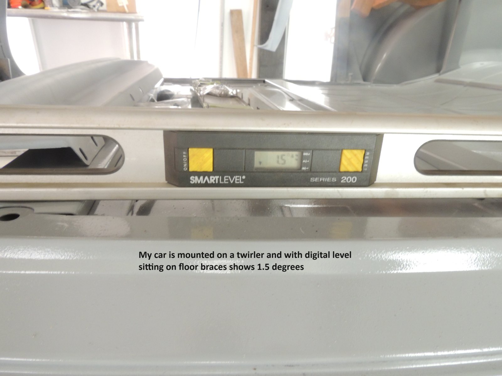

    Here are pics of what my factory ***embled body looks like.
    Chief 64, Chucky and 57 Fargo like this.

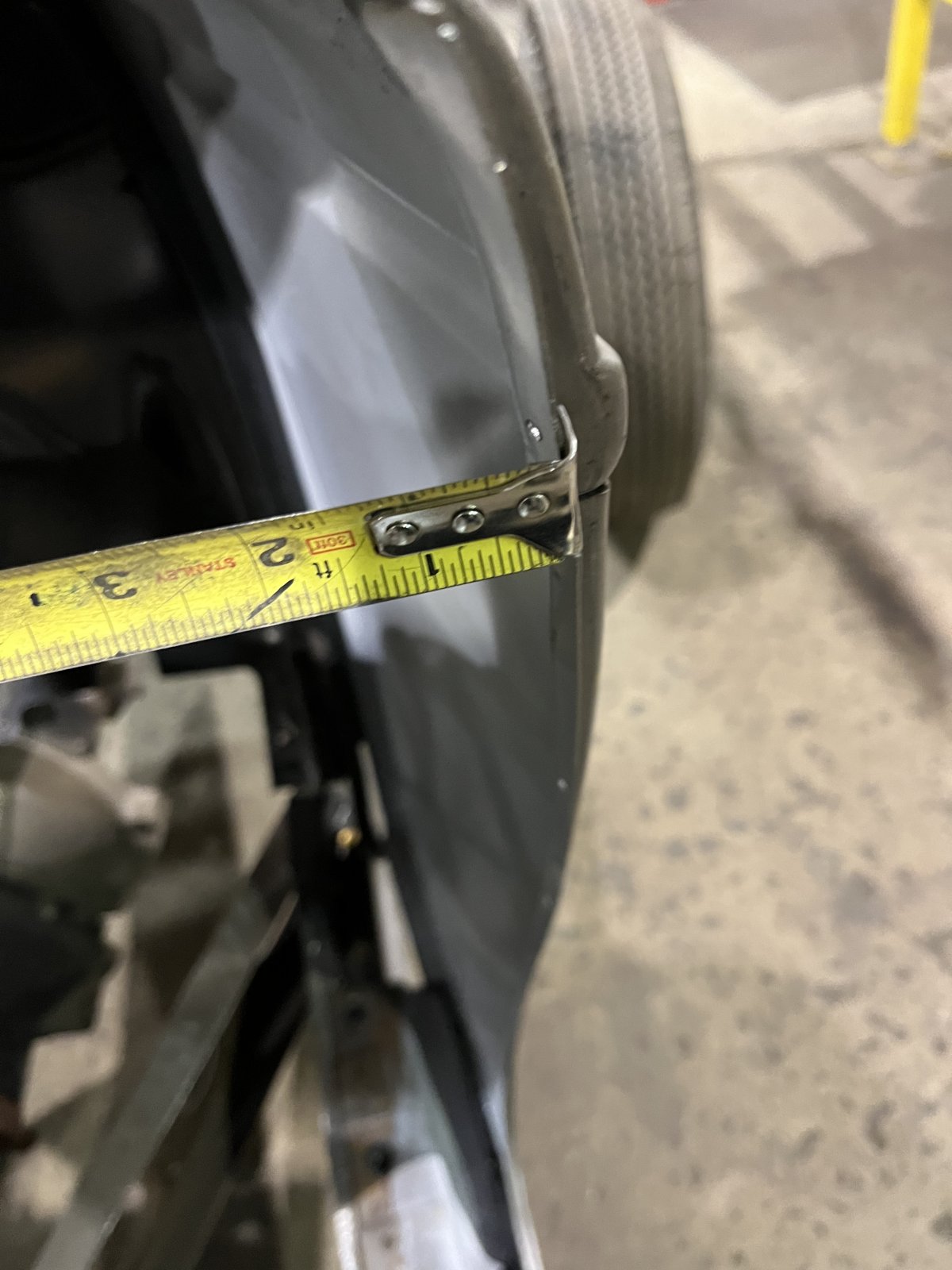

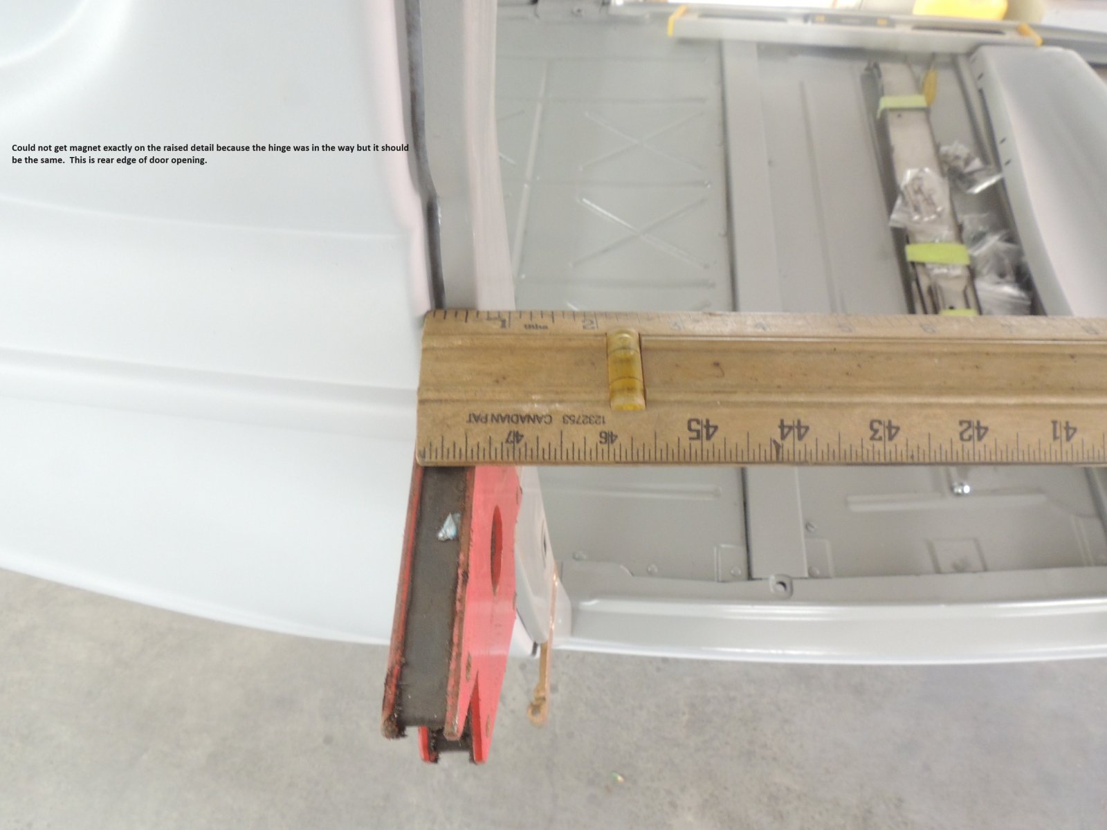

    Here are pics of the width of the door opening at the beltline.

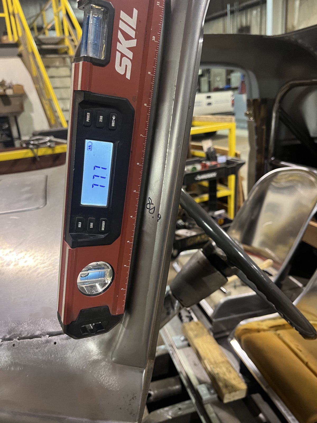

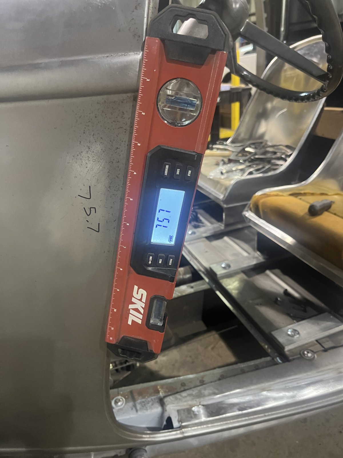

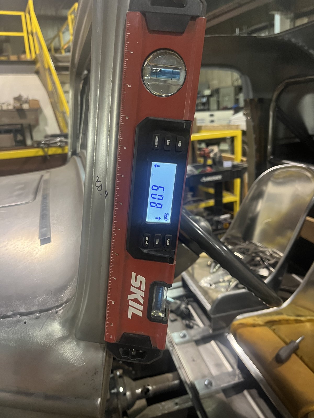

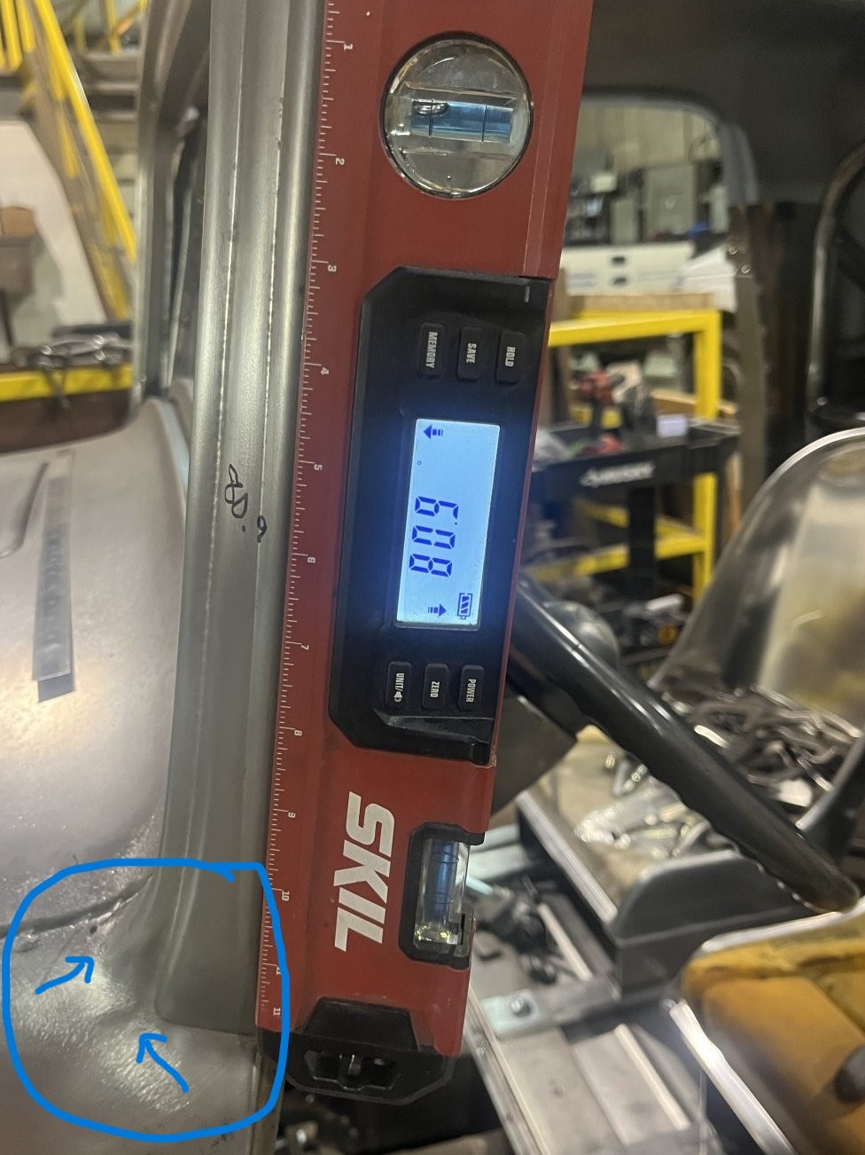

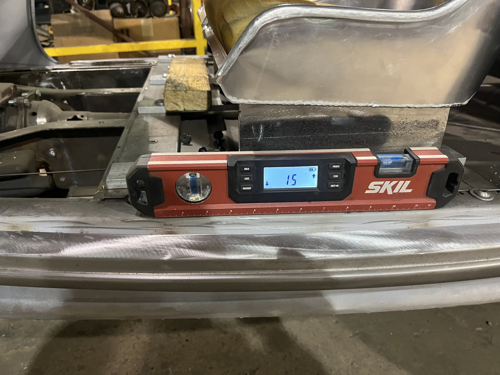

    9AE77B8E-24F1-4B55-86D1-66663A0C3AB9.jpeg 5936A976-0C0E-4F42-96B5-F71BC7D7E75C.jpeg Well I set mine up at the same pitch at the floor as Ekimneitbo at 1.5 degrees and here is my windshield post pitch.
  12. 65standard

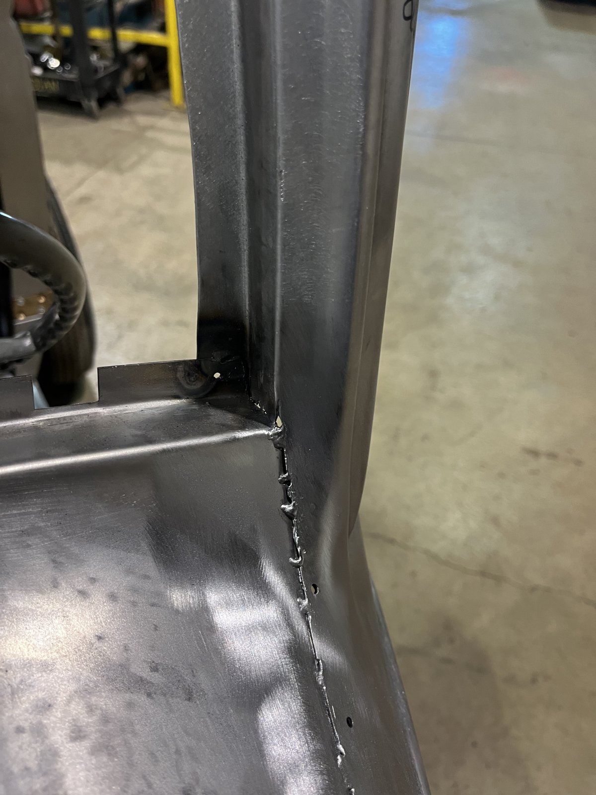

    2432664E-CA63-4321-9B9D-B7C9EB7769E5.jpeg BC83E029-F74A-46A6-B075-912CFC65F849.jpeg From the body crease line.

    Just for information, when I took my picture I was slightly lower than what your picture shows. Down to the raised belt line ridge........or whatever its called. What would really help you would be a cardboard tracing of the shape of an actual door. Do you plan to chop the top ?

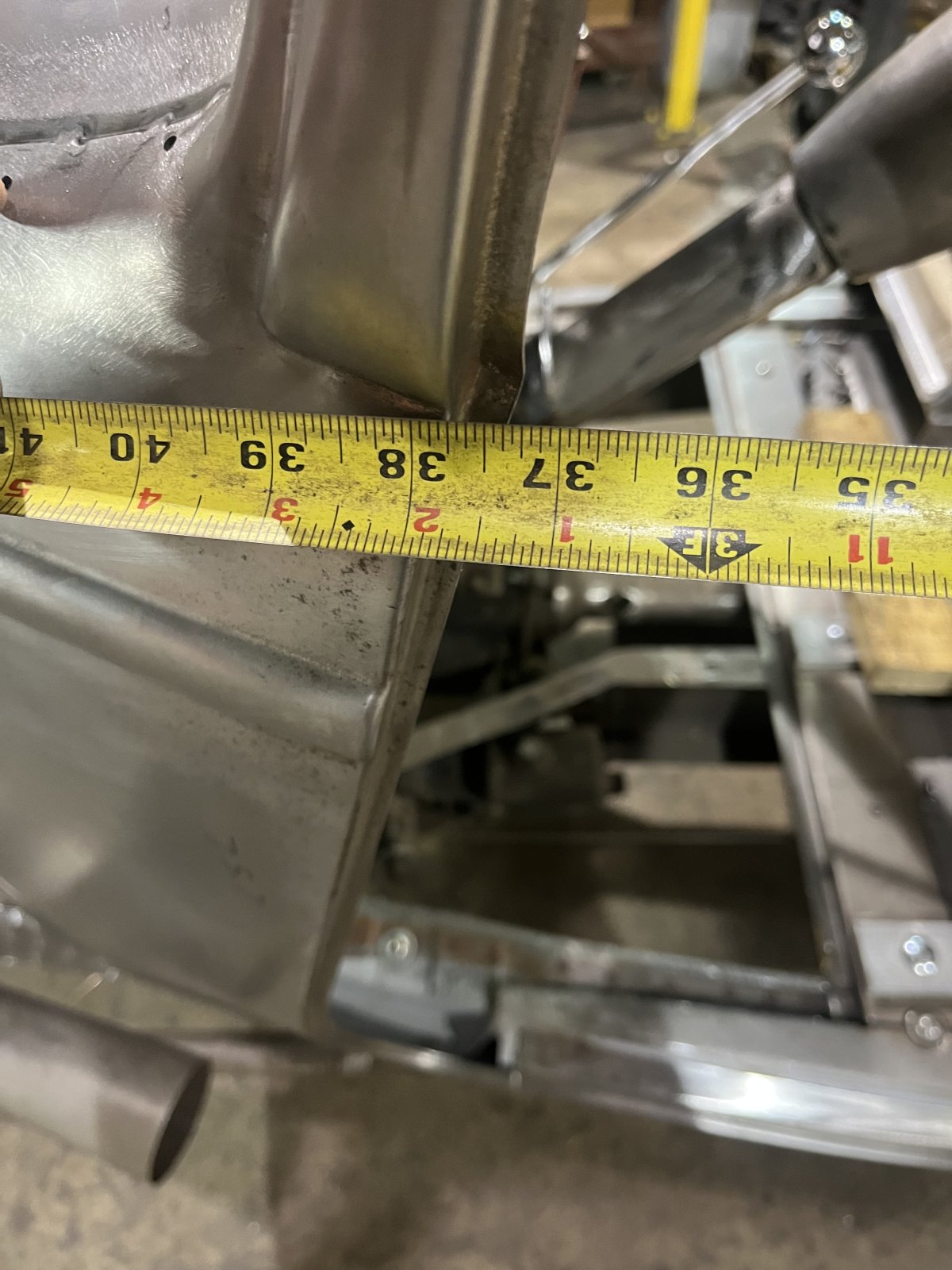

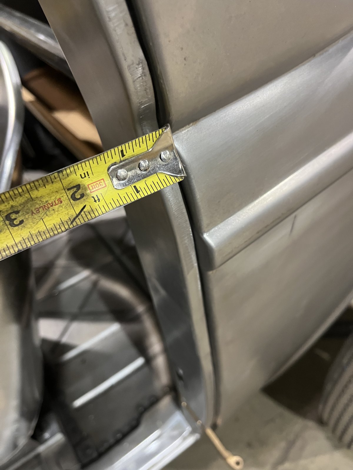

    Even at the belt line I’m at 38-3/8”. A full inch smaller than yours.
    There’s no way I can manipulate the opening that much.
    I am going to do a hard chop like Bens car and will lay the windshield back. But I need fitted doors working before a start the chop.

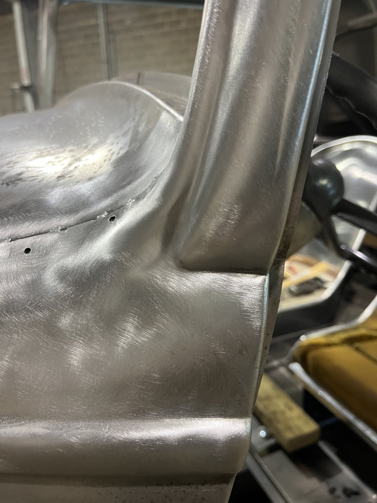

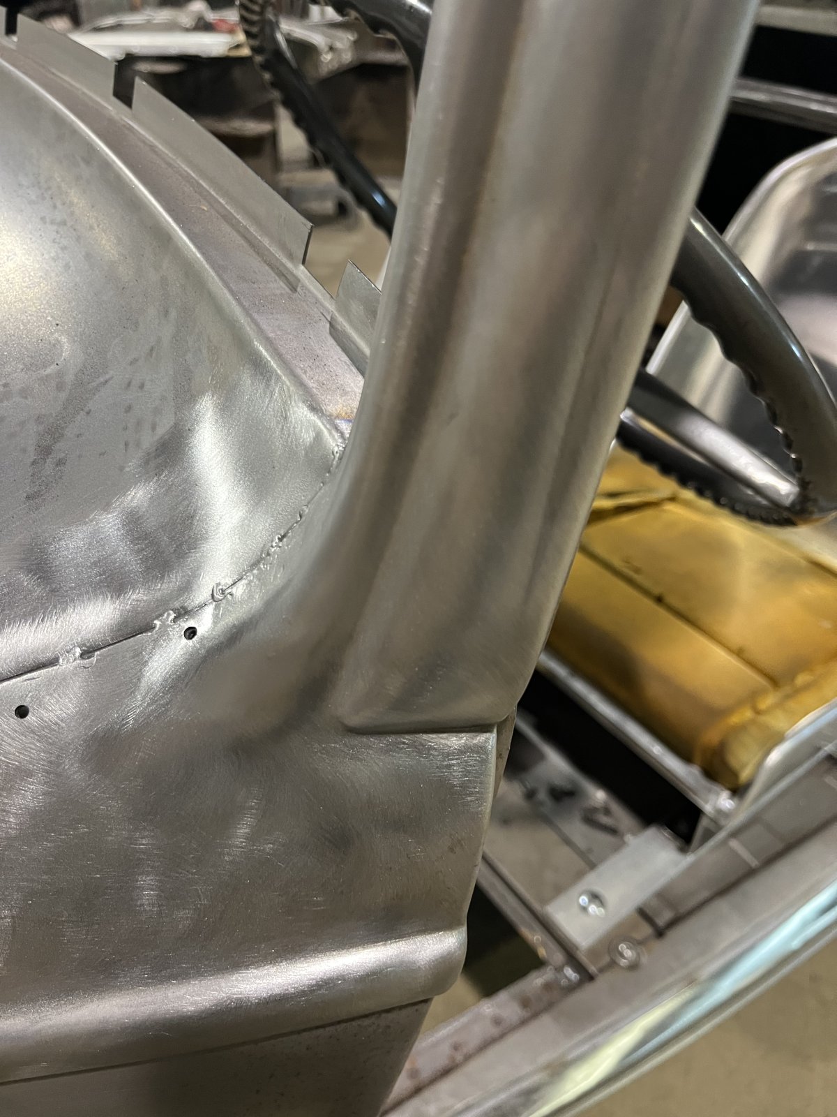

    The inner A pillar structure is pretty much impossible to bend due to it's shape so in my mind that is what is correct. The body panel would have had a much easier time hinging at the bottom of the window pillars or being pulled in that area due to welds to adjacent panels.
    The metal around the base of both of your A pillars does not look right compared to the other pictures offered up. It looks like there are waves in that area compared to a relatively smooth transitions others are showing. That would be consistent with the pillar trying to fold in towards the door opening.
    You need to make sure the body panel hasn't folded in towards the middle of the car as well. How does the opening line up with the inner door jam panel on the other plane of the A pillar?
    You probably need to cut out the cowl panel and get your A pillars back into the correct orientation before proceeding.

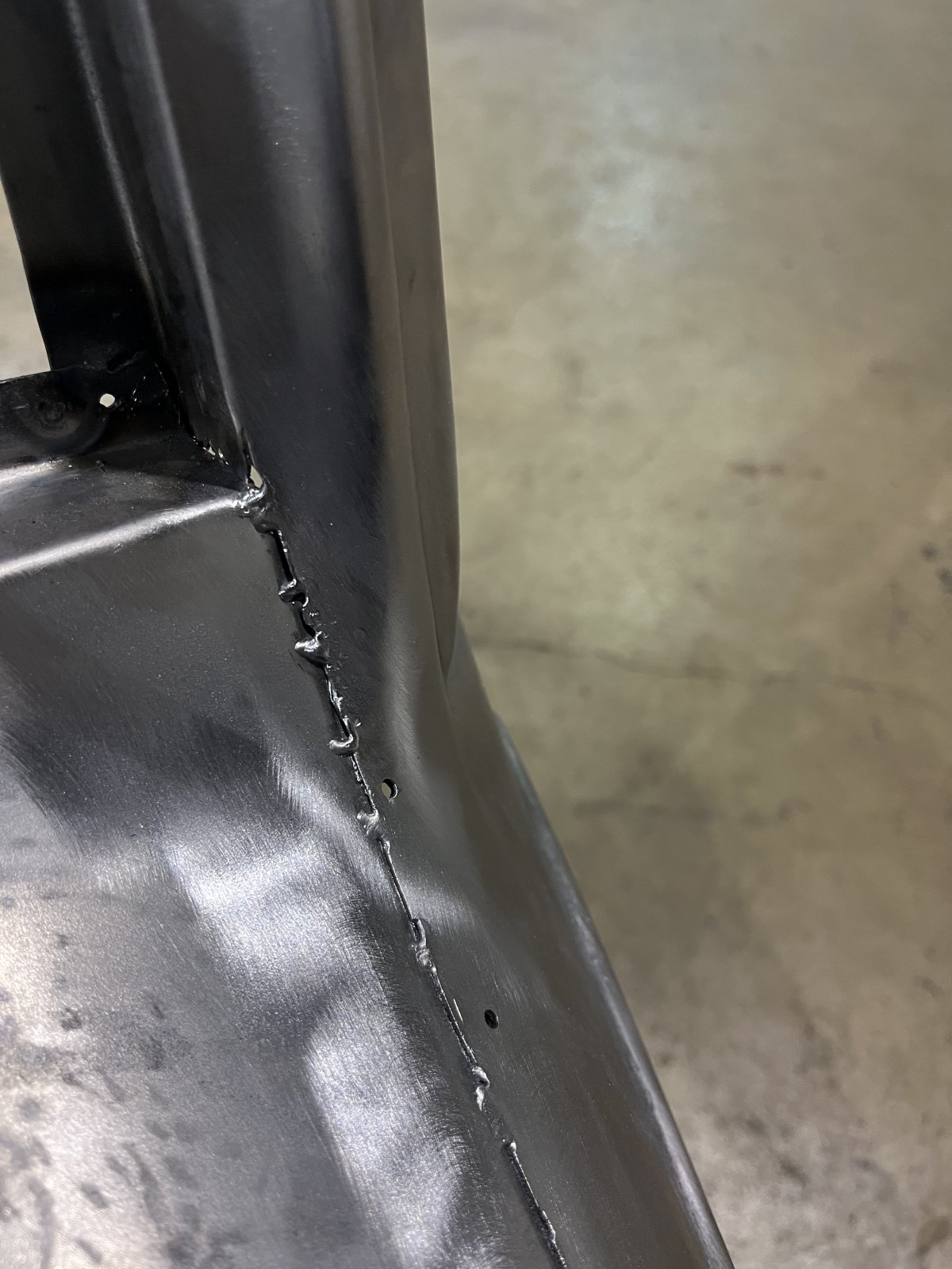

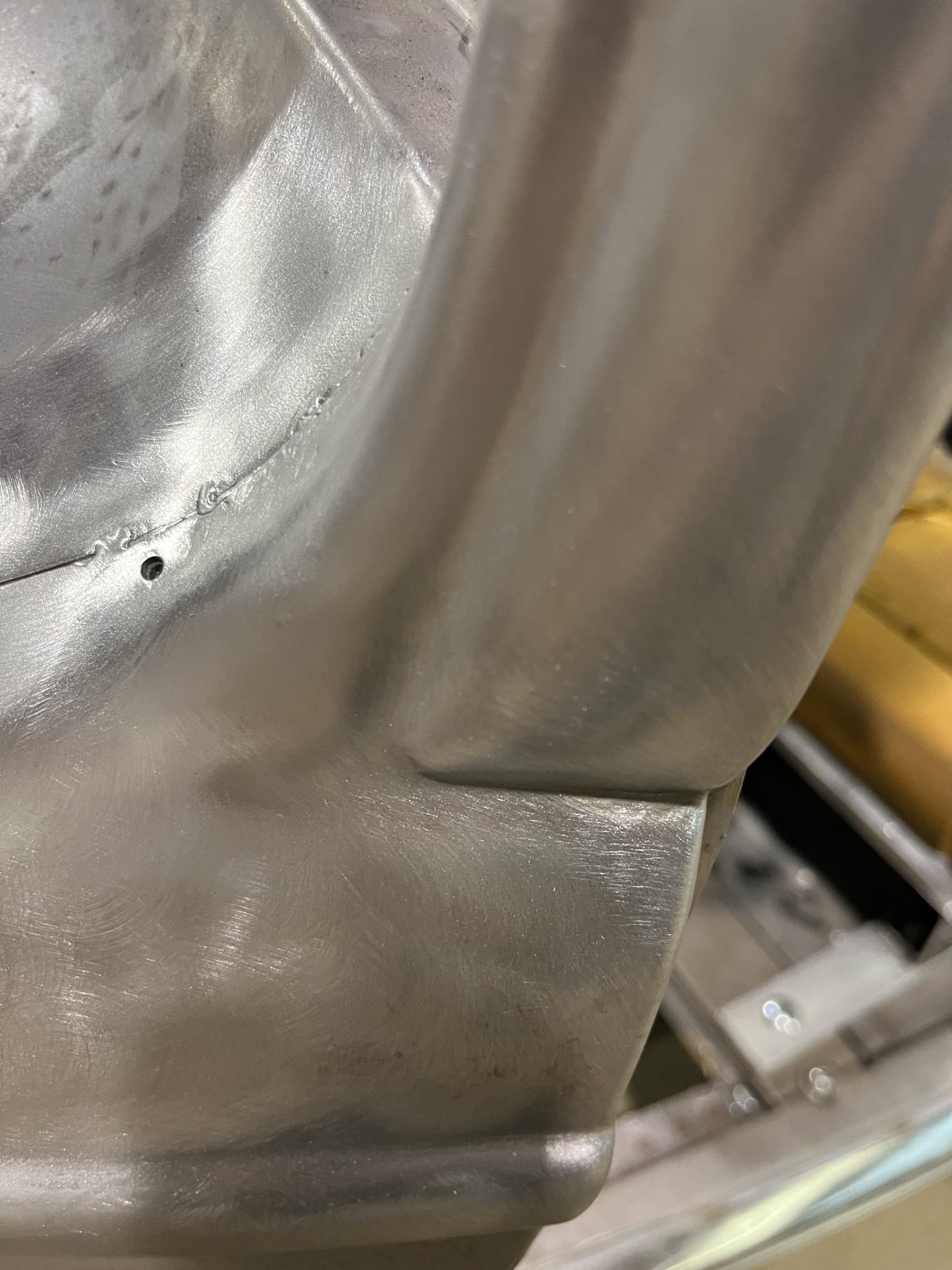

    It's hard to tell for sure with the picture due to lighting and the grinding that has taken place but this area looks misshapen to me. Like it has tried to fold in. FEE0956F-2475-42D6-B373-874D5548A309.jpeg
    lurker mick and Bcap55 like this.

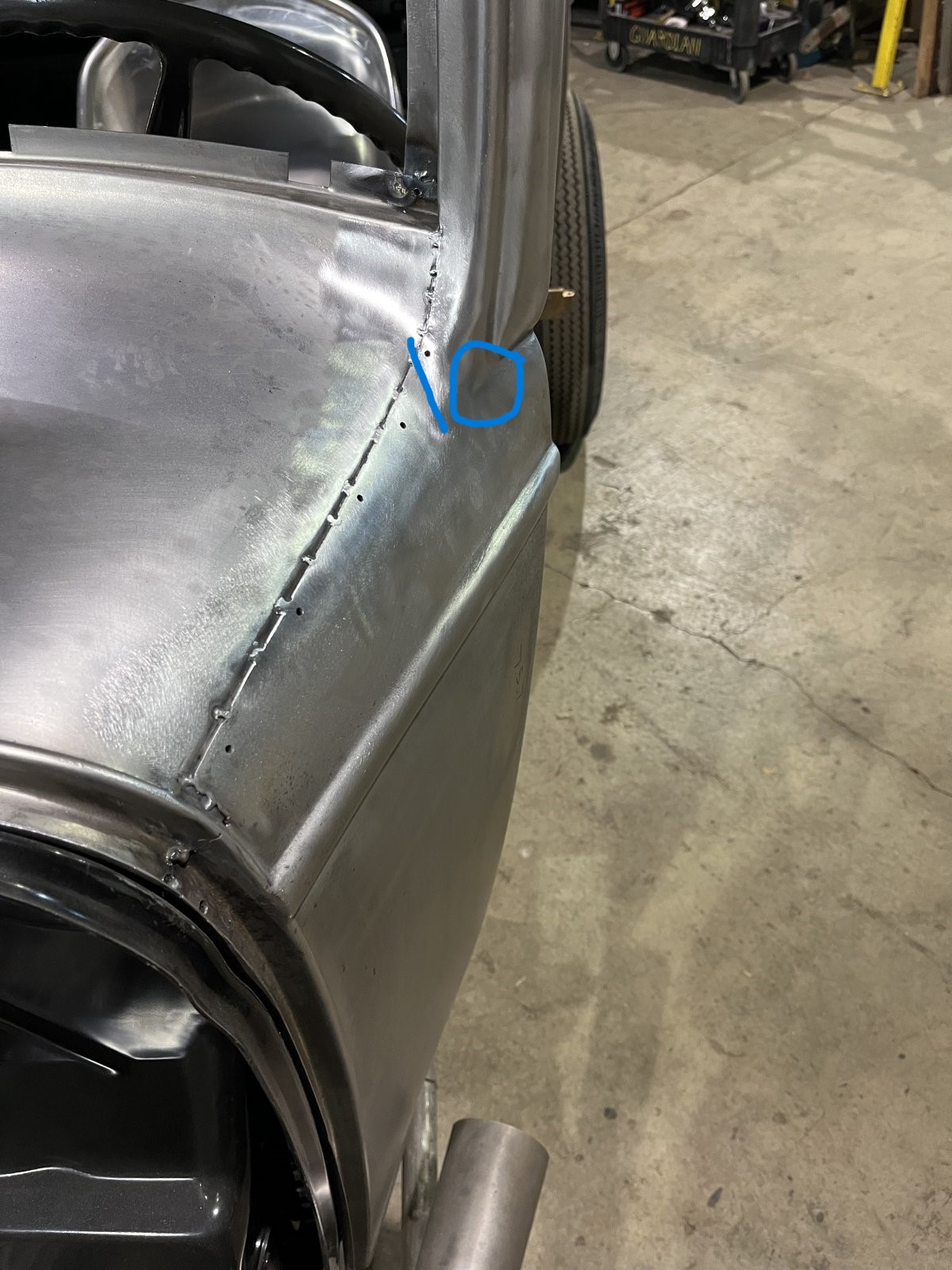

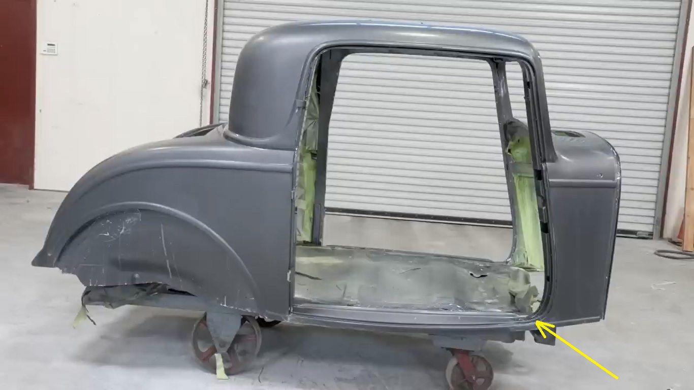

    Again super hard to tell for sure with pictures on the internet but to my eye there is a crease where I put the line and an indent where the circle is, showing that the metal folded inwards in that area which would be in keeping with what is going on with the issues with the vertical line of your A pillar.
    You clearly have A pillars that have been bent in that area as every other car that has been show is a relatively straight line up the inner post and yours is not even close.
    You definitely need all the parts to get things to fit properly but it certainly appears that the A pillar will need to be straightened.

    Perhaps I didn't explain what I meant very well. There is a major difference between the measurements of the door width front to back in the OPs picture and my picture of a factory ***embled body. It appears to me that the front of the door opening needs to moved forward . Rather than try to force it forward a whole inch, I'm suggesting cutting the cowl free at the bottom attachment points and moving the bottom forward (not back) which should increase the windshields (A pillar) angle and widen the door opening. I may be wrong, but it looks like moving that forward would solve the issue. :)
