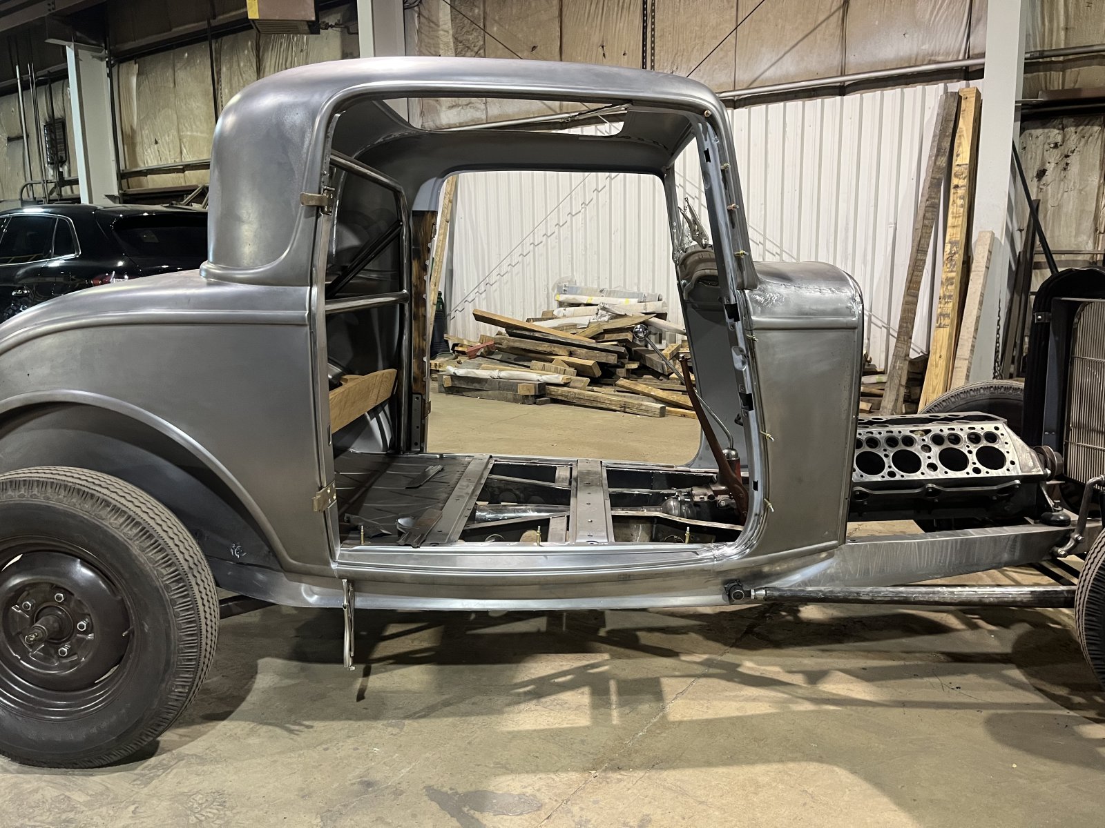

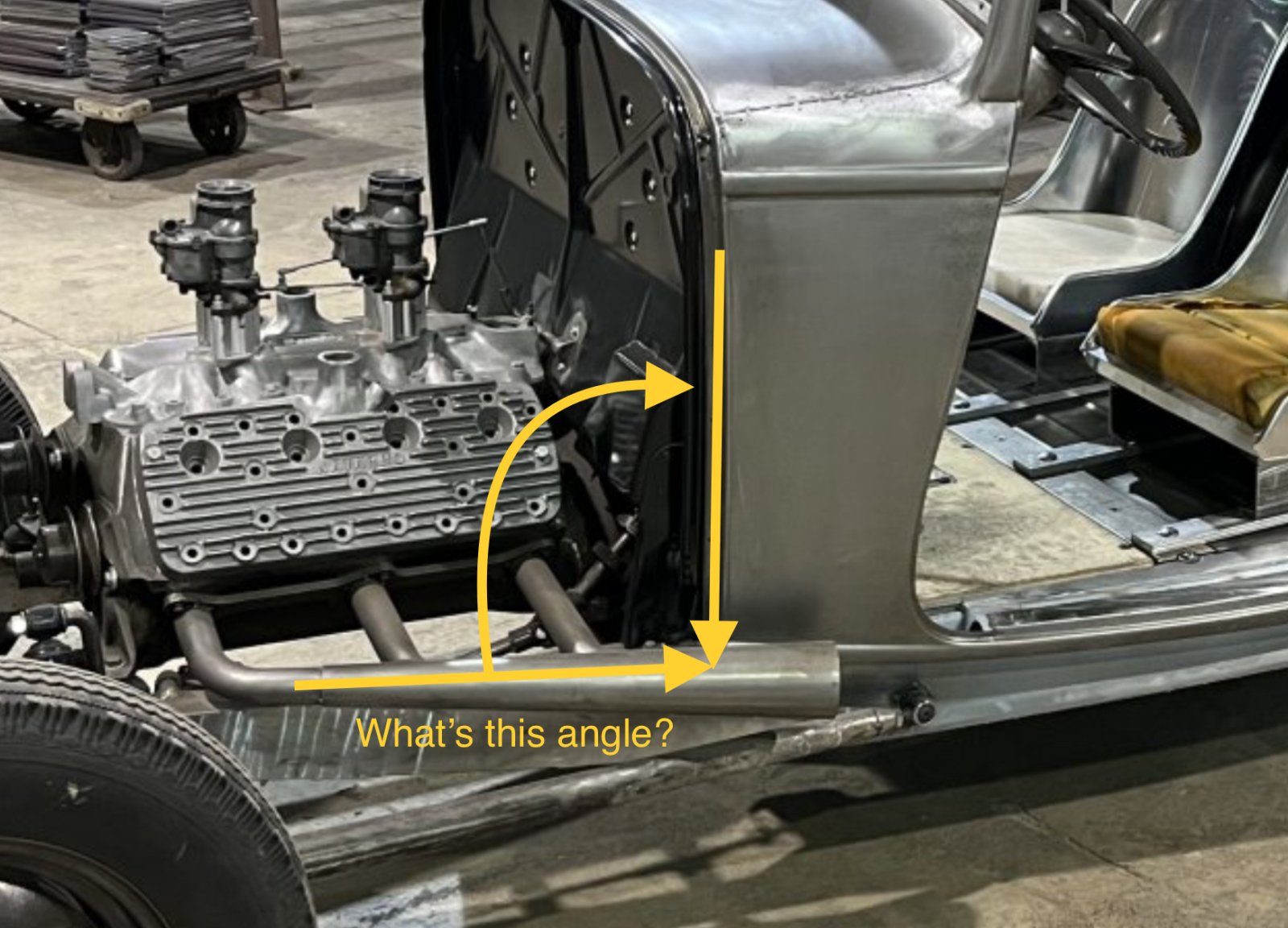

    How sure are you that the firewall/cowl fit is correct? And is the firewall correct height and angle? I needed to redo an aftermarket firewall once that was out of whack and getting it correct height and then angle to frame (so body seal and door fit all worked properly) was a challenge.

    I understood what you are saying but that's doesn't seem to be the primary problem here. His A pillar is a V shape with the point of the V being at the bottom of the windshield post. IT is not a relatively straight line like every other body that has been shown. In your drawing the inner line is not straight on his body so it doesn't matter how far forward you pull the lower part if the V isn't fixed it will never be right. Without fixing the A pillar alignment pulling it forward will absolutely align the upper A pillar but then the bottom half will kick forward from the cowl down. Now once the A Pillar is straightened it may very will have to come forward as well but that is certainly not the main issue here IMO. D595AA98-CBE9-4C7B-AAE9-E2FCD3BB55E4.jpeg

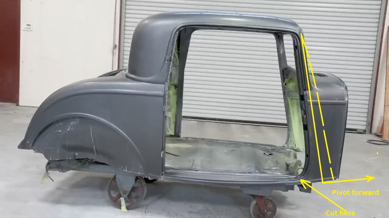

    @65standard can you get a picture that gives us a look like this one?
    I think we are going to see something like this:

    Op , not trying to be Negative ,
    You Need doors or another body as reference close by !!
    Im No help on 3w , but have done a 5 w & roaster , its almost impossible to set /align and put together without all the sheet metal parts, Very , Very few places on 32 that are straight for measurements,

    Almost looks like, if it were chopped, and the outer posts leaned back, the roof would not need to be lengthened very much.

    The other thing I will add is looking at this picture, which again is hard to tell because it is not a direct side shot, but the belt line bead on the front looks like it is heading down hill towards the back and not across to meet the one at the back of the door which further indicates to me that the A pillar is bent at the bottom of the window pillar. Put a straight edge on the bottom of that bead and see where it ends up on the other side of the door opening. DFA2995B-BF17-44A4-911C-25850A75BE64.jpeg
  9. The arc of the body and angle of the pic can be deceiving.
    just get doors on it some how
    Then you can diagnose

    Looks like cowl needs pushed ahead at belt line. That would help with getting pillar angle right. x measure door openings top to bottom and side to side like others have said need doors to get it right

    I’m starting to think this way too. John from Brookville suggested this after I sent him a whole bunch of build pictures.
    I’ll try and remove the firewall and see if the body springs back correcting this A-pillar issue

    That is what I initially thought and am not disagreeing that it might be whats wrong. What comes to mind is wondering how two panels on opposite sides would both be out of shape without some outside force pulling/pushing them. Maybe weld draw, but can't picture how that happened unless attaching the dashboard or something caused shrinkage. I came up with the idea that maybe measuring some other references would at least produce something to compare to. I took a tape measure on the drivers side and hooked it to the molding for the rear window..........cause it was a convenient place.

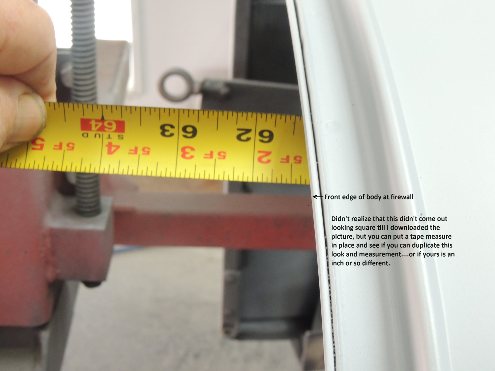

    Hooked to bottom for a couple of measurements.
    Then
    Then measured to the flange for the windshield
    Then the front edge of the body at the firewall
    Then moved the tape measure to the top of the rear window flange
    And measured to the upper windshield lip
    Ok, not the best way to do it, but probably close enough to compare.

    Yes. John was helpful. I followed his advice by unbolting the body from the frame and removing the firewall. That helped the panel relax and let me m***age it back where it’s supposed to be.

    The original firewall should bolt to the original frame and provide the perfect angle for the cowl. Which one was wrong on this car? Was something modified from original?

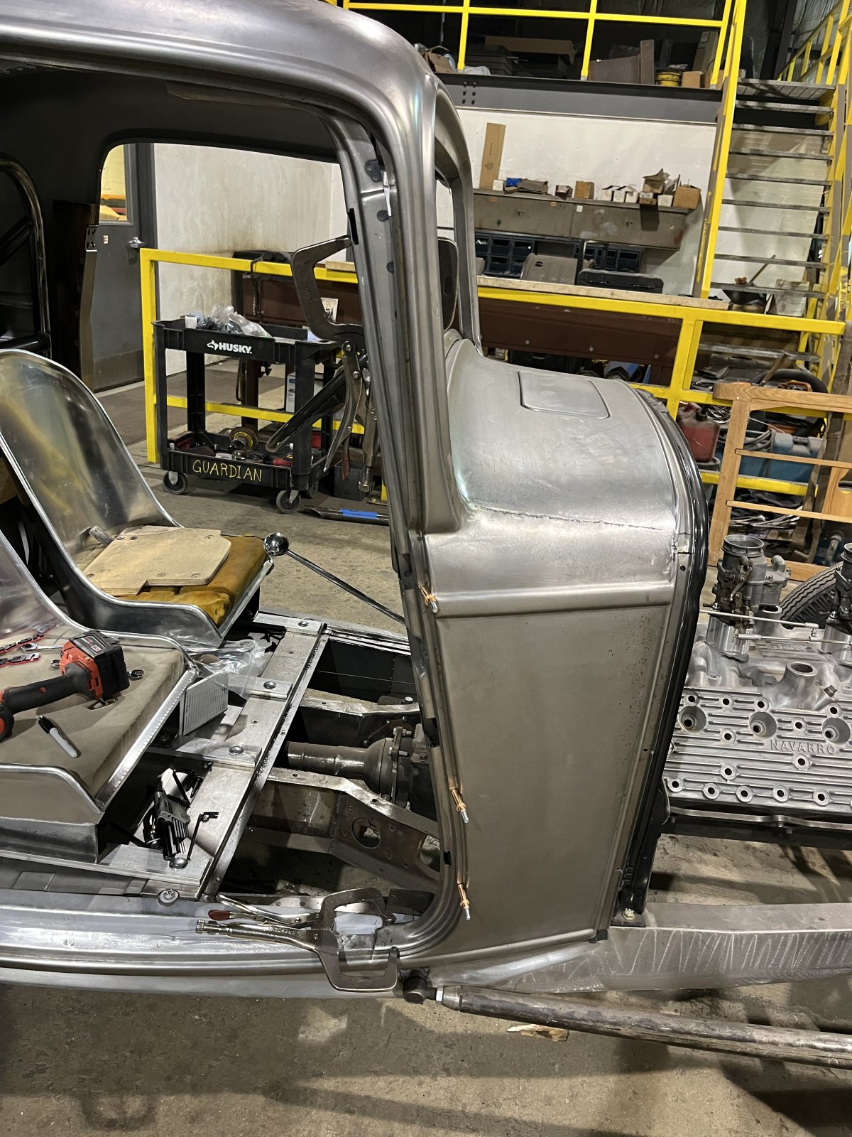

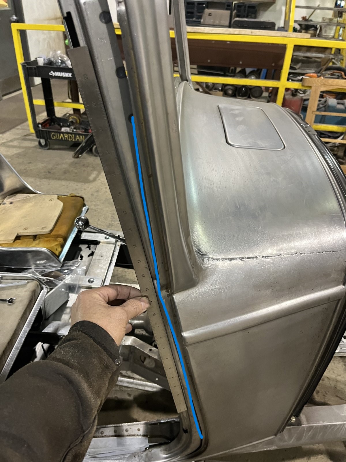

  21. 65standard
    Joined: Jun 14, 2011
    Posts: 1,096
    65standard

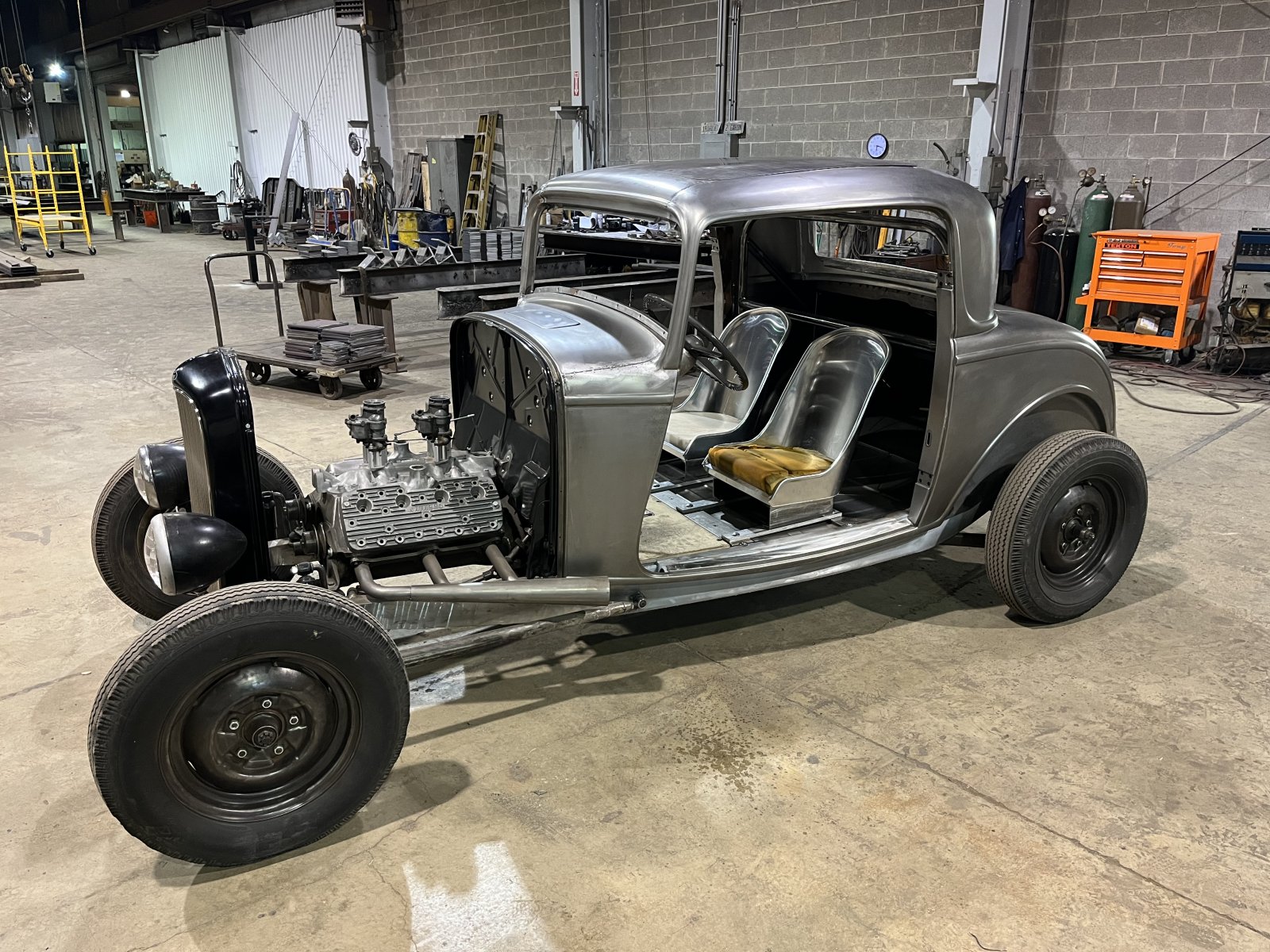

    The only issue was the a-pillar was push in about 3/4”. Once I removed the firewall and unbolted the body from the frame like John from brookville suggested, it was easy to push the pillar into its correct position. Then the A-pillar ***embly fit

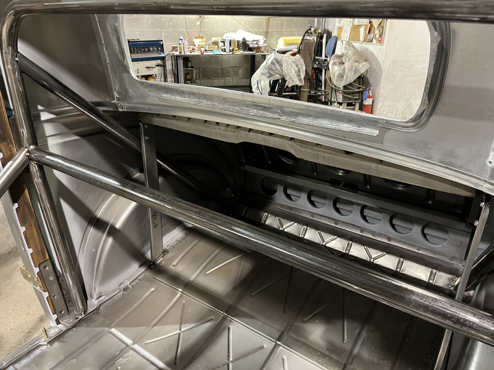

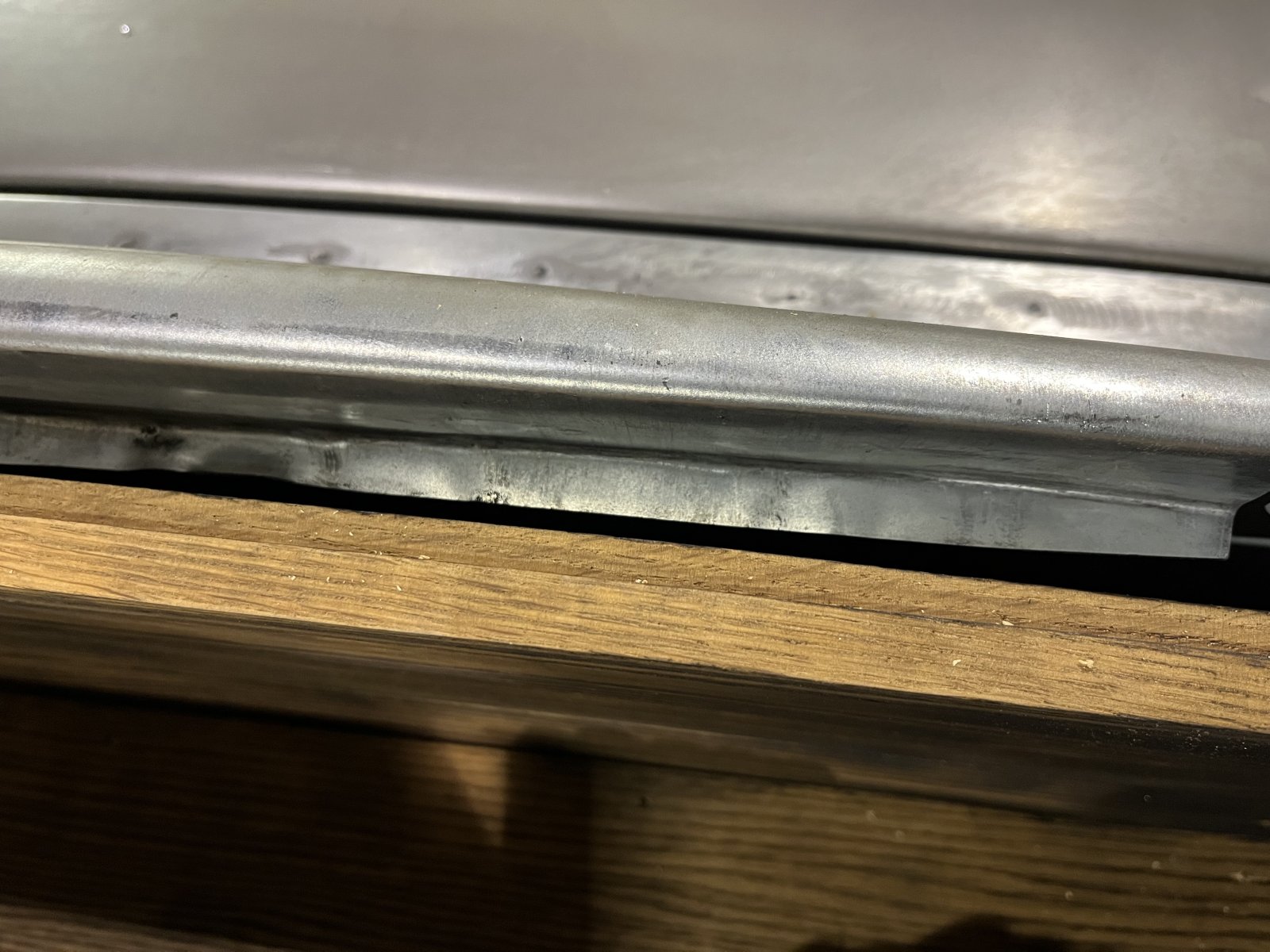

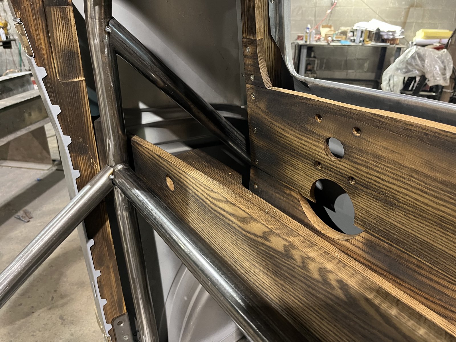

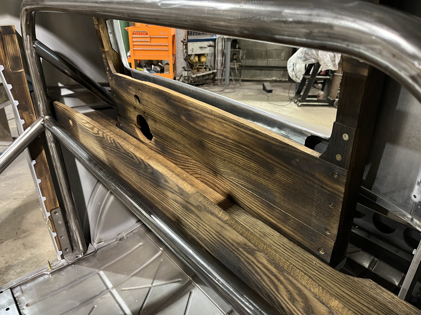

    14762DF0-2AC7-40B1-8637-5B8BB81F294A.jpeg 1666743C-C829-4775-B694-A68DDAAB1AD5.jpeg E2117638-6E68-4240-8021-D69EA5C335B9.jpeg 8A9111D8-7371-4CBC-B79D-CC7E1B544839.jpeg Does anyone know about the roll down back window? Do I need to cut off this flange by the rear window. It seems like it would be in the way if the back window goes down
    also, does the rear window open all the way or just a few inches?

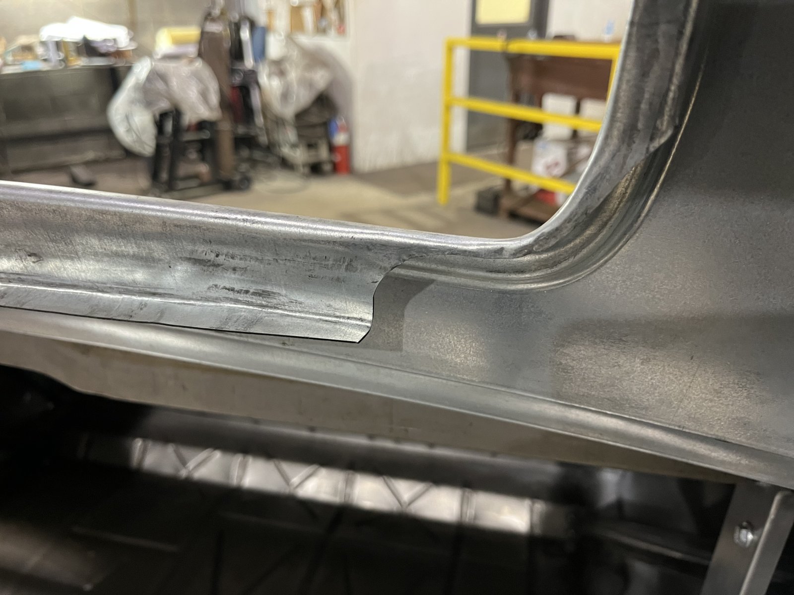

    Looking down the rear window opening you can see that flange in the way?
    C7BDDEE7-65BC-441B-B292-8D9A11D08AE2.jpeg A10C3E43-C121-4BFF-AD45-52D4E08143DA.jpeg 1CD88039-CF98-4D77-9FEB-F9199E9A8673.jpeg
  28. Happydaze
    Joined: Aug 21, 2009
    Posts: 2,378
    Happydaze
    The lower lip of the window aperture does hang down some; I guess it forms a drip edge for any water ingress to fall into the trough. But yours appears to also have a 90 on it facing forwards. I think that requires removal. The verticals of the wooden frame are screwed through the side wings of the aperture and there if a forward facing flange at the top of the forward face of the trough which sits on the top rear part of the wooden shelf / cross support. This supports the weight of the unit. I replaced my shelf with a box section brace to gain legroom, and my trough sits on that. Looks like you'll need something coming off the rollbar brace. Armed with what's attached to what you'll easily see what is in the way!

  29. Happydaze
    Posts: 2,378
    Happydaze
    Must type faster! I see you have retained the wood! The flange I referred to I think has a slight swing toward the rear. Probably prevents drippage on the lifting mechanism and surrounding woodwork.

    Bobby Walden used to have an occasional open house and one of the most interesting jigs in the shop was for ***embling the 3W body. You are attempting a monumental task and with perseverance will prevail. Looks like you are gettin good info from Brookville and members here on the H.A.M.B.
