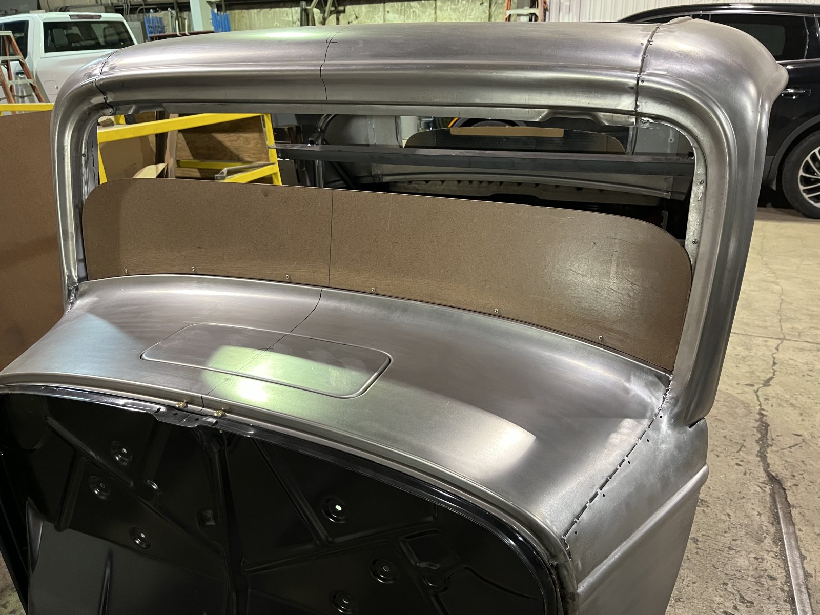

    So what happens if your body is still a half inch (or even just a quarter inch) still squished through the door opening? You’ve built everything else solid and now will just slice up the doors to fit? A well built car is done by minuscule fractions of an inch.
    If it was mine I’d go for those original doors posted above and do the necessary repairs.

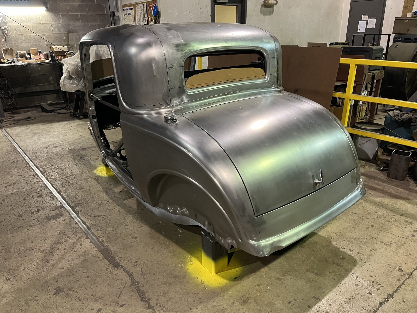

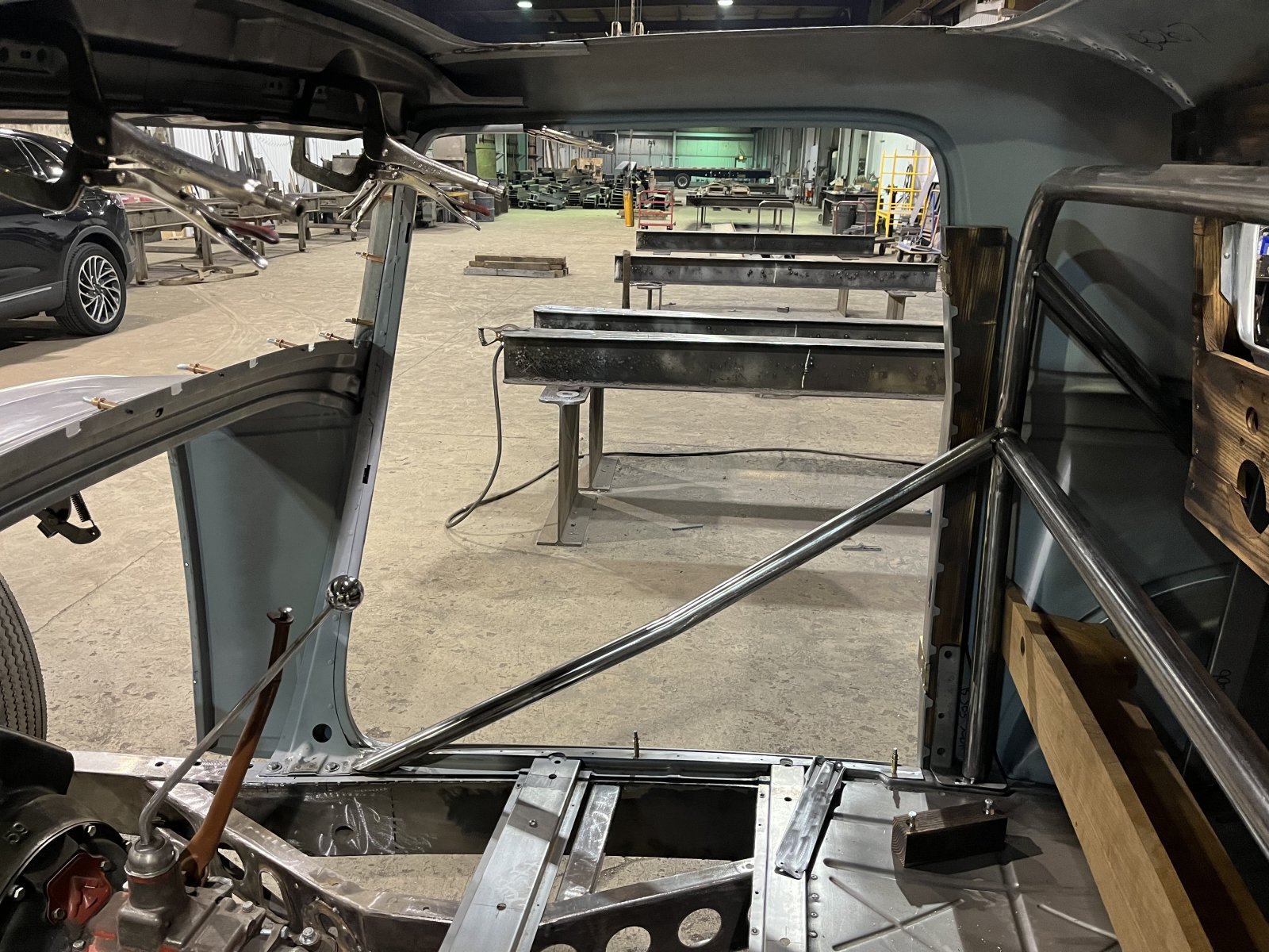

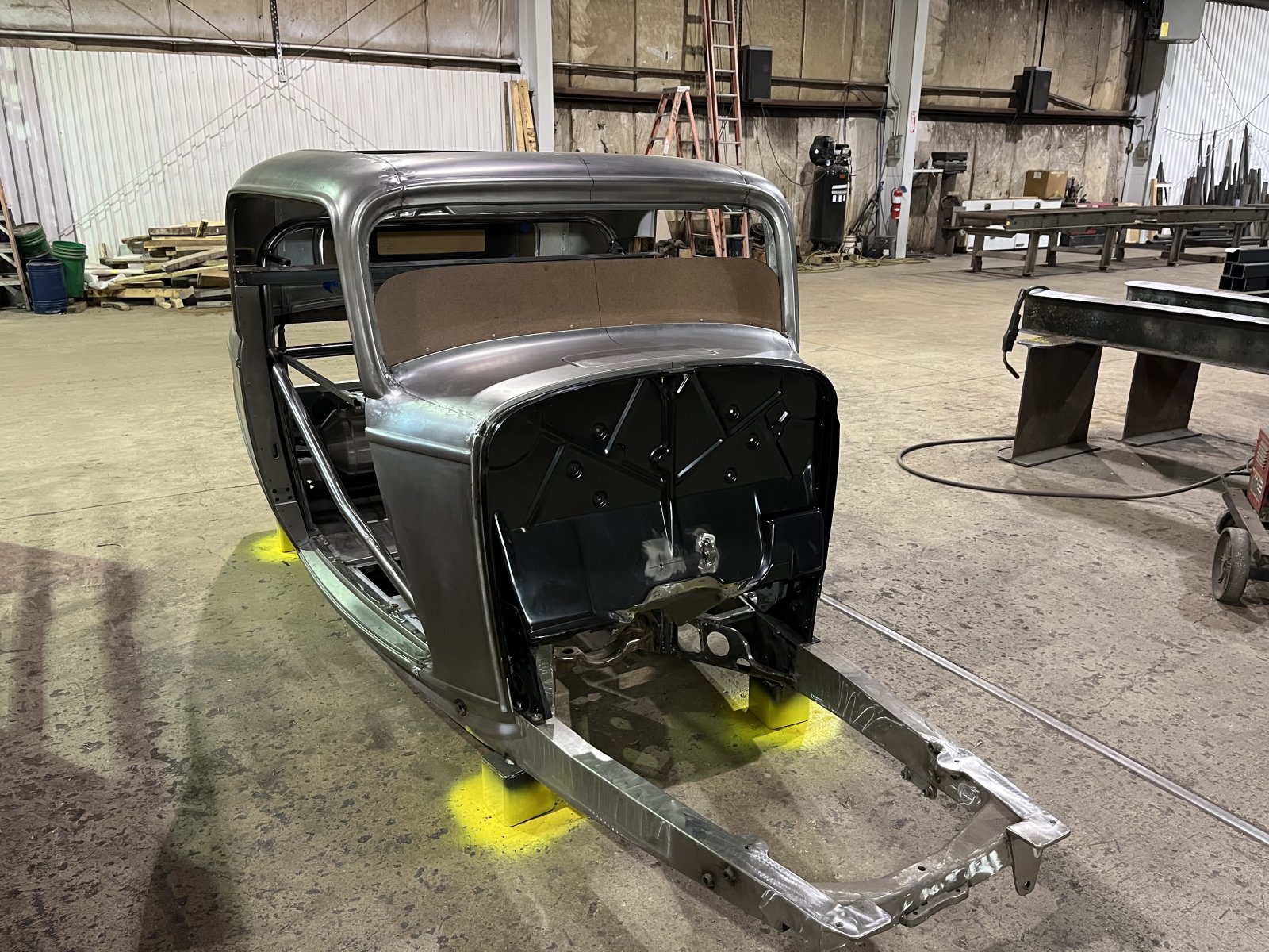

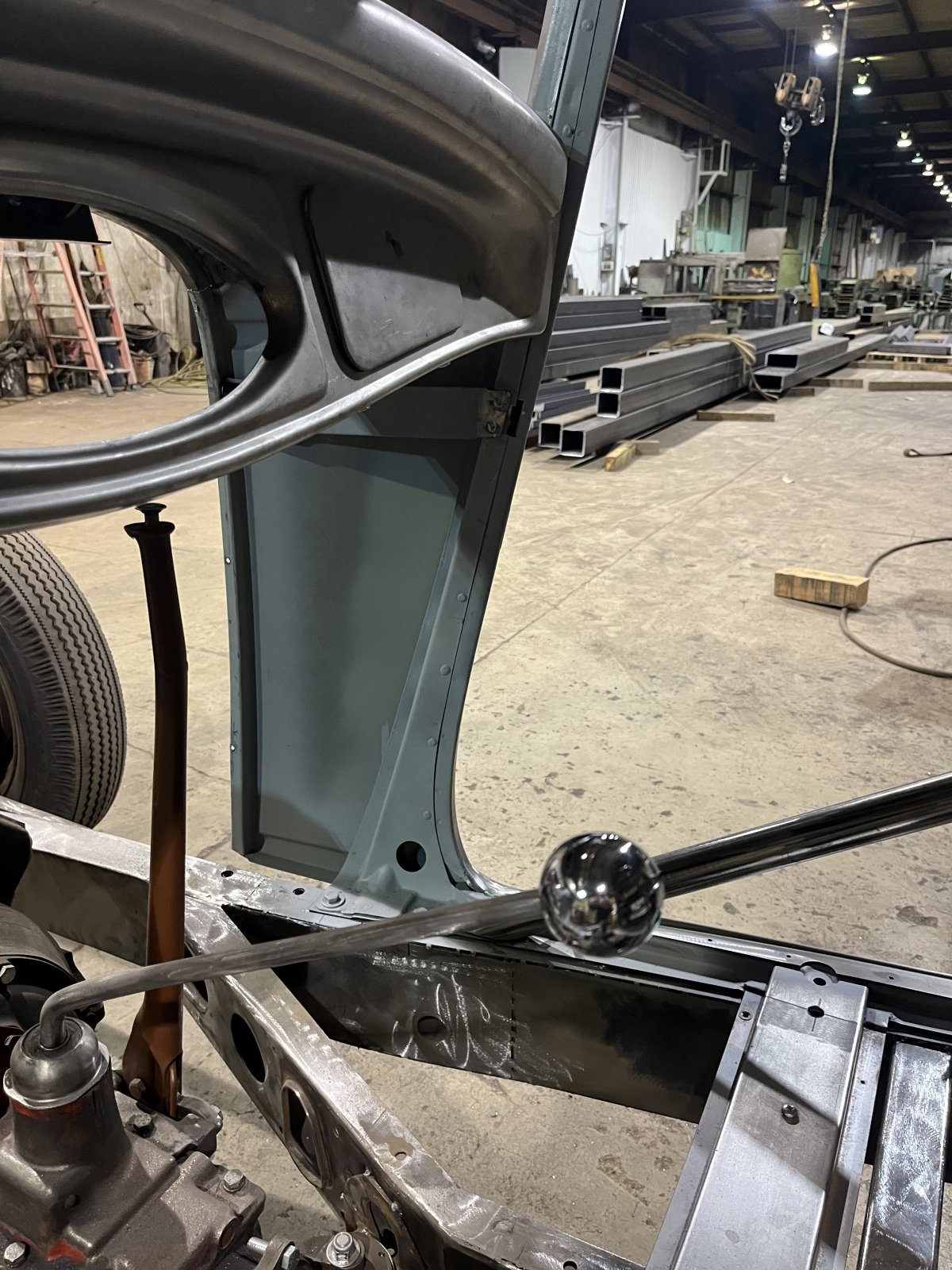

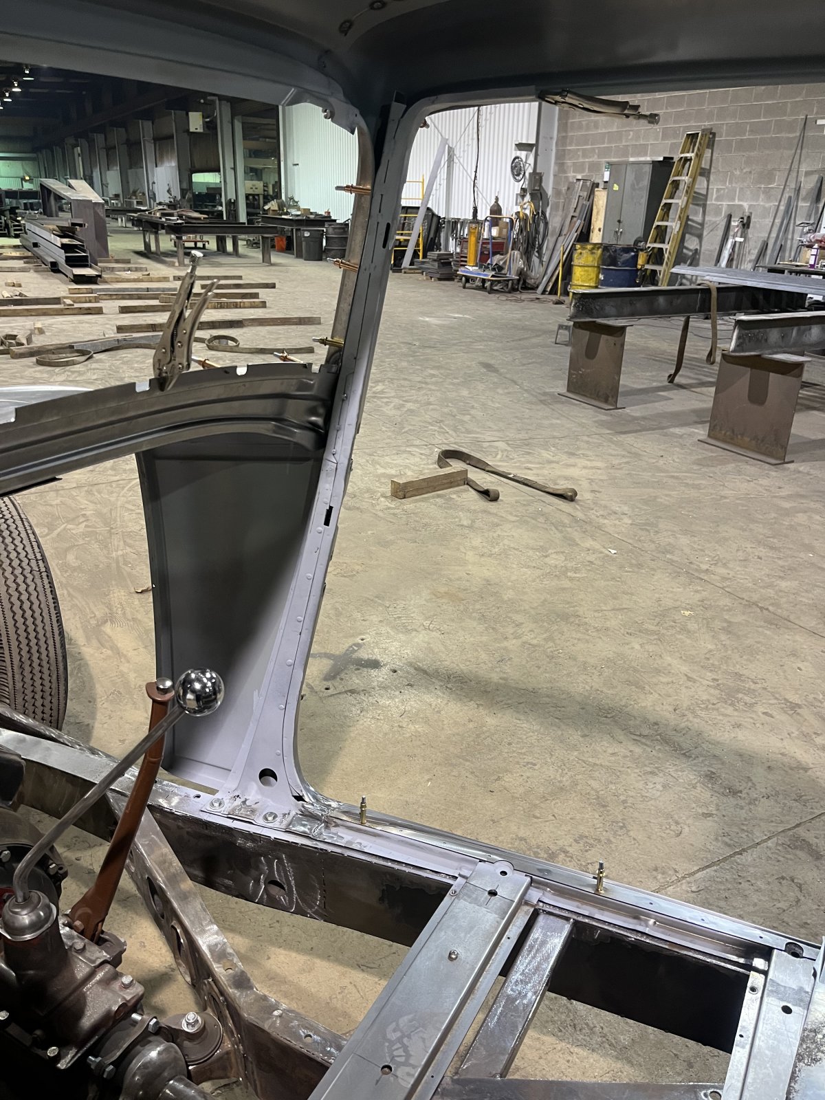

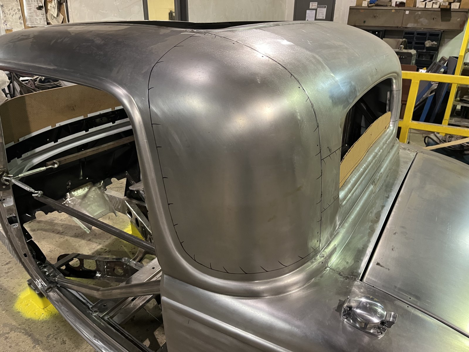

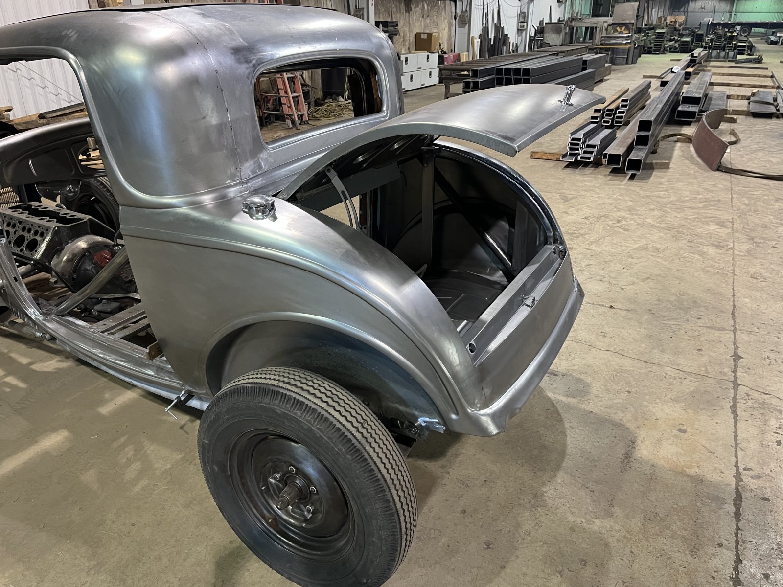

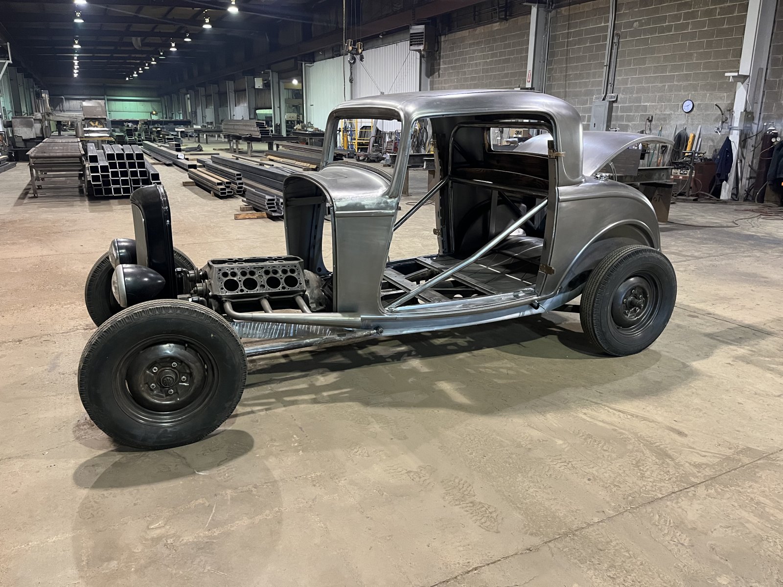

    34EB0C98-584E-40E8-BC7D-BFD359232ECE.jpeg AC6A2E8B-5B2C-4610-A409-0B9687B151E4.jpeg 51A4328E-E98A-426F-94FE-2908353BDDAF.jpeg 89FB4D49-BDC4-4B48-8C4A-ABD9230889B8.jpeg B2F1A964-A560-40C0-AE96-67F04CA29959.jpeg 6F67E411-1A79-4F5C-9869-A536AB57824A.jpeg I will make the doors fit the body. Here is where I’m at so far.

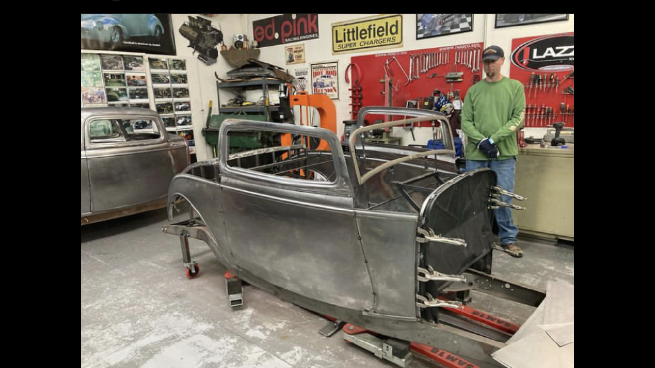

    A guy I know built a whole 32 3 window body in Lazze metal shaping cl***, including doors
    Mabee you could contact Lazze and he or one of his students could make you a pair
  7. F-head
    Joined: Oct 20, 2007
    Posts: 1,482
    F-head
    Here’s a couple in progress pics E166F120-ACA4-4EC5-BF09-C98D6E05D796.png 34AFEEB3-0FBB-446A-8D3E-1AFA6AC7DB81.png

    It looks like you plug welded the A pillars. When the body is done and the doors are ready to go in we squeeze that A Pillar to help set the door gap then weld.

  11. 65standard
    Joined: Jun 14, 2011
    Posts: 1,096
    65standard
    35BBC383-9A89-4AD5-9C74-C4B82DCA89B8.jpeg FBCBEEF6-7557-454B-A0C3-B3501B336238.jpeg 9FC2211B-649D-400E-B50C-33C3EC3EDD76.jpeg FBCBEEF6-7557-454B-A0C3-B3501B336238.jpeg
    I knew about the two piece A-pillars not being fully welded so the inner door gaps could be dialed in. Ben told me about this feature.
    But after careful examining an original 32 3-window, I decided to weld that part.
    thanks for the tip.

    Between supply issues and ***embly issues, it's a mess and I really feel badly for you. The outlook is grim for getting them any time soon from Brookville-and if they have 18 cars waiting for doors and can't get them,can they survive-and what then if they can't? There was a suggestion earlier about 'gl*** doors as a temporary fix.. Maybe you could get them, then find an original steel car close by to compare and modify them. These are available- https://www.ebay.com/itm/224566258300

  16. 65standard
    Posts: 1,096
    65standard
    3F3D4BAE-A7B9-47DB-878D-A6A2BA8D9FB6.jpeg 29F92943-D08E-426C-B67A-5C620B1C6C92.jpeg FA379716-6330-4508-B358-A1595B96C6A3.jpeg 21231E56-B9A3-4D74-AA59-CD16BB60C910.jpeg Thanks for the tip. Yes, I’ve seen them and talked with mrmerc. I will be at Brookville on the 11th talking to Kenny about my doors. I’m picking up my 2” longer hood there. If the Brookville doors are year off, I will buy a set of these early reproductions. They will be a lot of work making hinge pockets and everything else for them.
