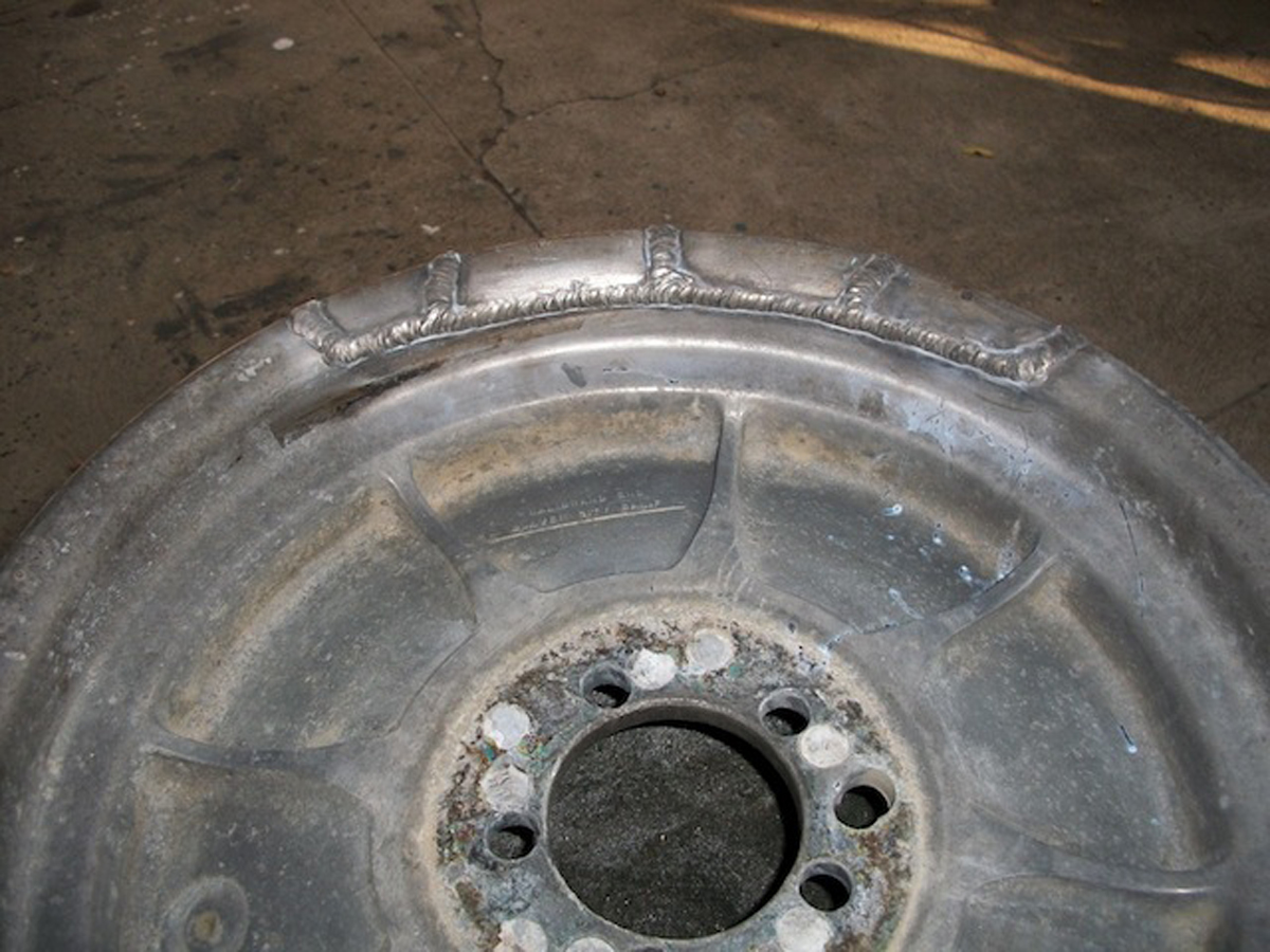

  17. Stan Back
    Joined: Mar 9, 2007
    Posts: 2,736
    Stan Back
    Wheel1.jpg "You are on a roll Jim with the zingers ;) How many miles does your Merc Sedan have on the Salt?"
    On and off for 30 years. Trailered it once from Southern California after one of the 18" Halibrands failed on I-15. Never had it on the salt when I was running the roadster. Never went thru water unless I had to.
  18. I remeber when the Halibrands faild
