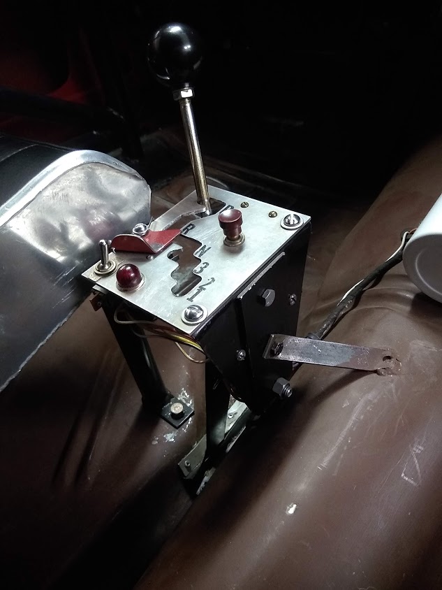

  16. squirrel
    Joined: Sep 23, 2004
    Posts: 59,929
    squirrel
    that's a neat picture of the star shifter....here's mine, in my 59.
    1Nimrod, Deuces, lostone and 2 others like this.

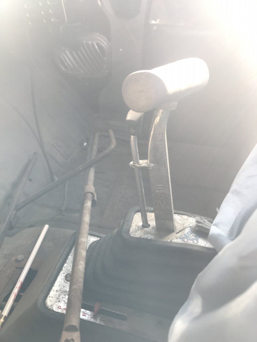

  20. Elcohaulic
    Joined: Dec 27, 2017
    Posts: 2,213
    Elcohaulic
    Hurst beat you to the punch. They brought out the Autostick I. It looks and feels like a four speed. The gates are very positive, it bolts to the transmission and has solid linkage.. I think its the cable that makes most automatic shifters feel sloppy..
    Theres a decent one on e-Bay right now for the Turbo 400/350. But they made them for Fords and Mopars too. A change in a few brackets is all thats needed..

  28. Budget36
    Joined: Nov 29, 2014
    Posts: 15,303
    Budget36
    Ha! Mine may be a year or two older. I put this in my ‘57 in 78 or 79. My buddy who had one a few years before used to give me hell about it, I think it was something to do with a sticker or engraving/casting. Too many years
    1Nimrod likes this.
  29. squirrel
    Posts: 59,929
    squirrel
    mine is from 79, I made an aluminum lock out handle and pointer, and added a couple switches to the handle.
