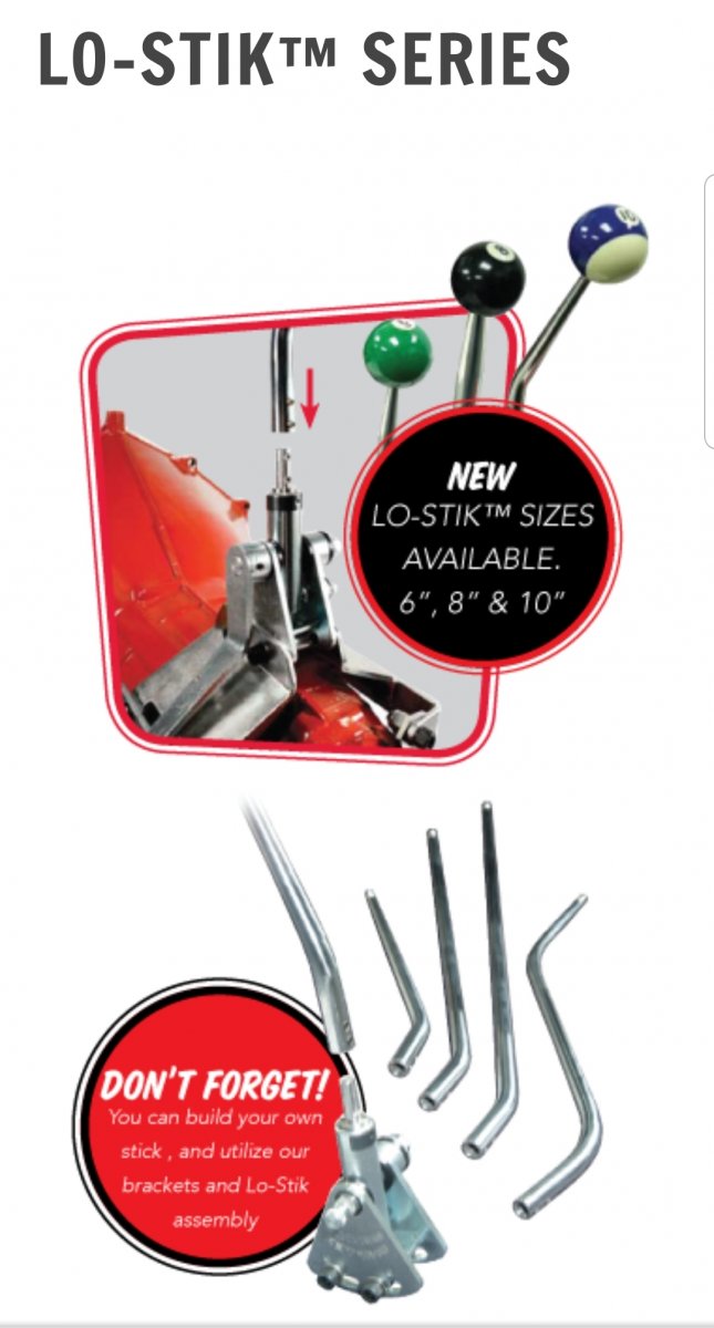

    Nice find on a modern version of the automatic transmission shifter. Our high school shop project was not as fancy as the one in the photo ad. But, the key to making a manual shifter on an automatic transmission is the threaded fitting that moves the lever forward and back. Any size rod, curved or at an angle, will thread right into the opening. The bottom of the mechanism can be homemade or any one from one of the s**** piles or swap meets. Our technology at the time was to get a steel rod, cut it to length, thread the end and see where it was going to fit.

    The neat thing was, after our trial and error models, we did put in a threaded shifter unit, so we or anyone could interchange any size or shape stick shifting levers. We even made another shifter lever that looked like a 4-speed curved one. That brought a ton of laughs for the Pontiac sedan.
