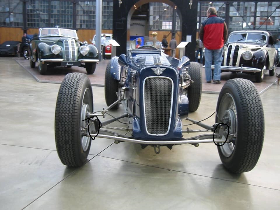

    Holy hello! That last photo did the kingpin snap? The p***enger side tire is laying on the ground at speed!

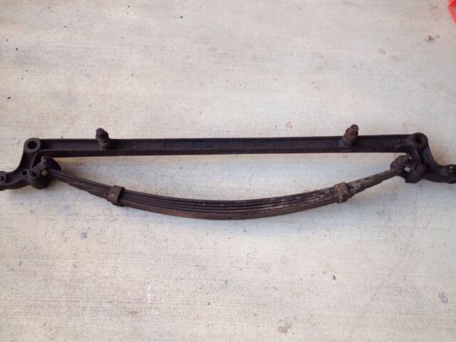

  13. brading
    Joined: Sep 9, 2019
    Posts: 833
    brading

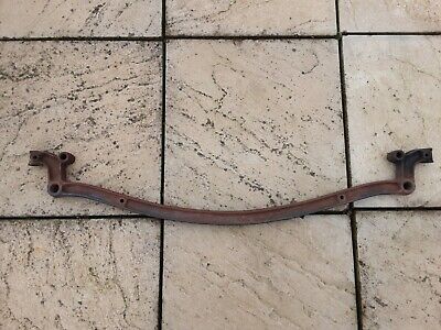

    Here are a couple of pictures of the Austin Seven axle. I take it what you are talking about is the plates I have marked I think these are just brace plates.
    Okie Pete likes this.

    The later '39 to '48 Austin front axles were parallel leaf springs, but also a dropped axle. But they changed the design of the drop to make it a more gentle angle that started at the spring mount and gradually dropped out to the kingpins.
