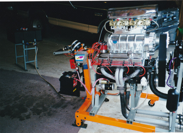

    I am building one, and using a 4 speed bell housing also. I feel better with the flywheel covered.

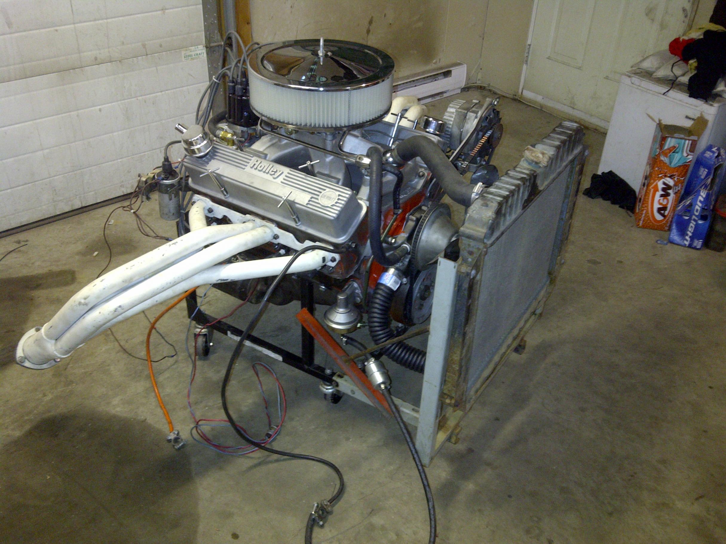

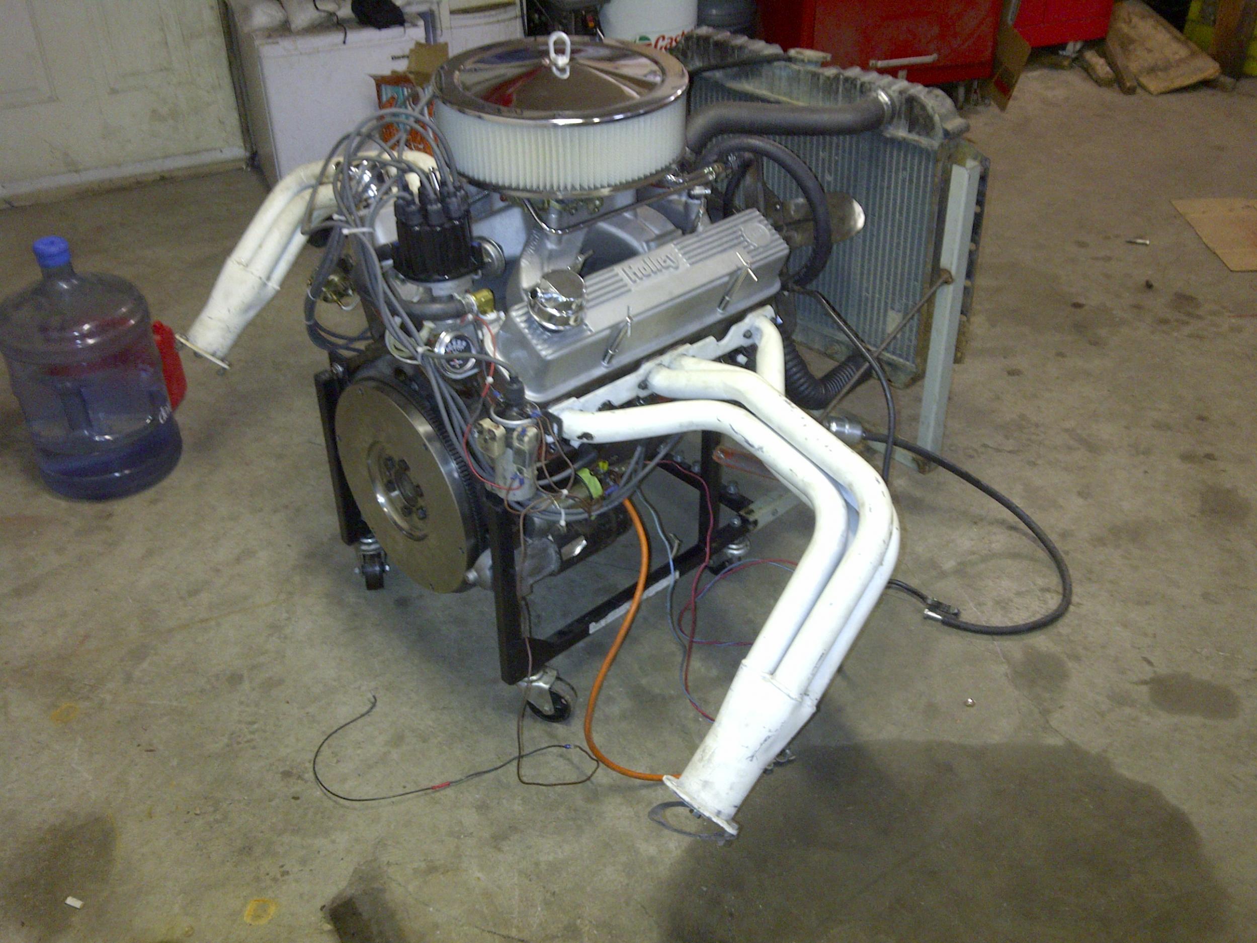

    Mine is very similar to that, except the control panel is in the front, for two reasons, away from the bellhousing area and exhaust, and much easier "loading" of an engine as one end of the stand is "open". Started with a warehouse cart with HD solid rubber casters, and have another HD flat table about 30" high that's just slightly larger than the castered cart (actually a motorcycle engine assembly table that came from the Indian factory in Gilroy ;)) that I can set the whole assembly up on to work on it at normal height, 2', then pick up the whole deal with the hoist and set it on the floor to fire up and run.

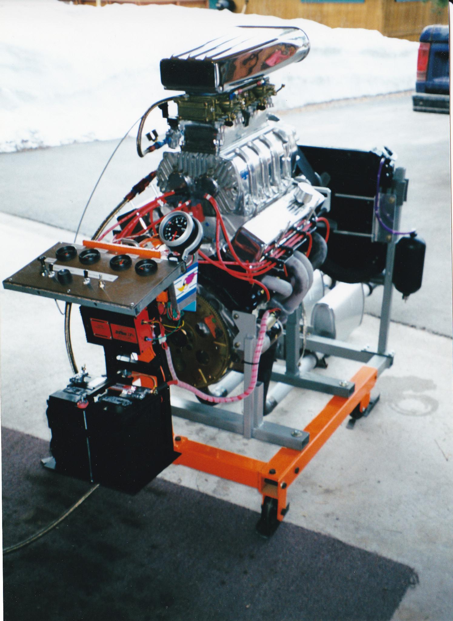

    This is one that I used to run my engine in before putting it in my truck.Just modified the existing engine stand as it was already on rollers and pretty easy to do.
    Roger

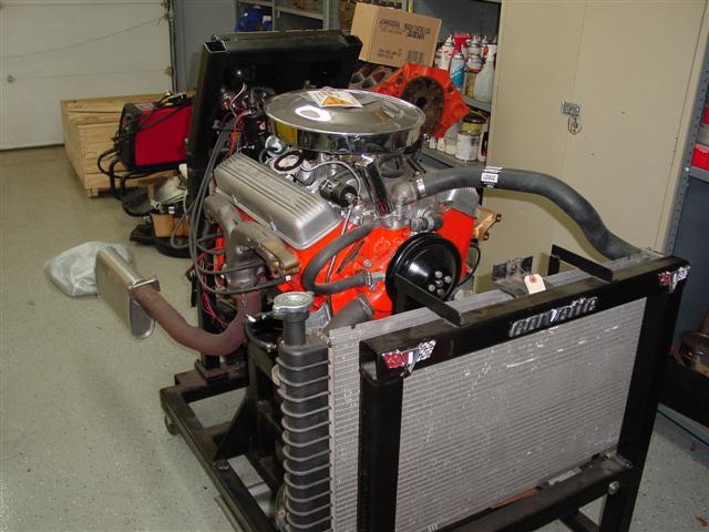

  21. 47.Poncho
    Joined: Nov 16, 2010
    Posts: 67
    47.Poncho
    I built mine out of a Princess Auto engine dolly. Me and my buddies have used this idea about a dozen times and works everytime. Much easier to find the problem on the stand then compared to in the car all hocked up and you have to pull it out again. Thats the 400 in the car and it hasn't come out yet. Just make sure to go over your flywheel bolts and fan bolts cause it's scary when it's running.

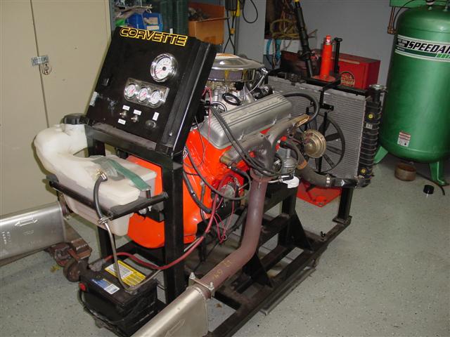

    The one I built from scrap and drops. Ron
