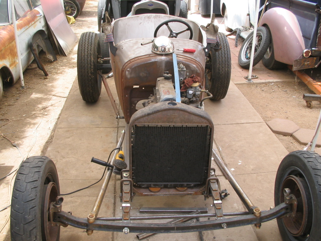

  4. need louvers ?
    Joined: Nov 20, 2008
    Posts: 12,901
    need louvers ?
    It's a 2300cc Ford, and the rear will sprout a quick change here pretty quick when the weather cools a bit. I just realized those photos are kinda blurry, and you cant see the bead rolls at the tops or any thing. I just flat got tiered of looking for a touring front half that I could afford, so i made one. You could do the same with any cowl.

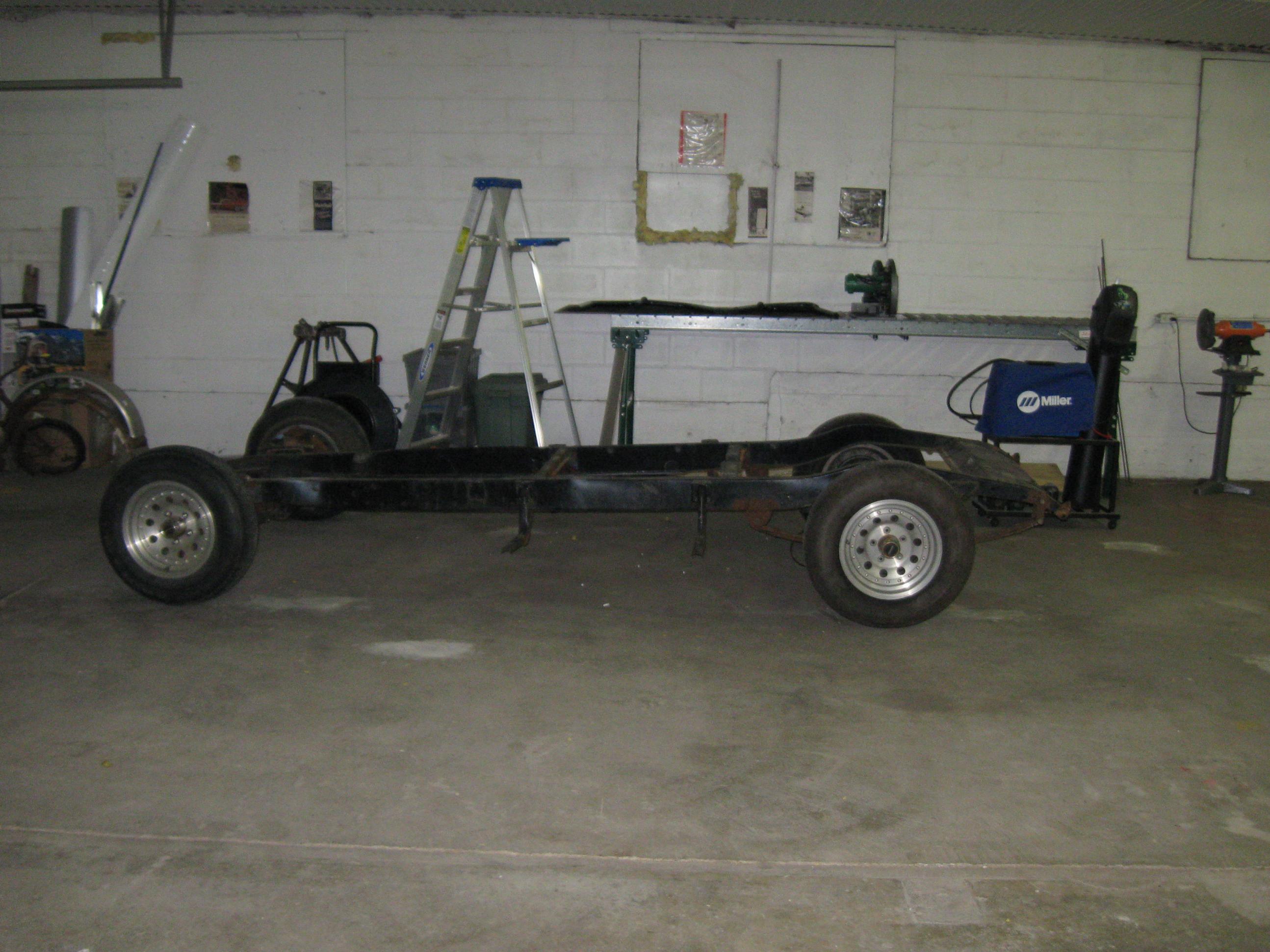

    I am about to start a body. I have a ch***is. Still trying to decide on a design that I like.
    Probably a roadster. I like that Howerton Indy Style Roadstster.
    Any Suggestions?

    Sounds like fun with the four-banger.I've always liked how these sound with a gl*** pack and a decent amount of tailpipe,kinda like a British sports car.:p
    Gonna have a clutch,right?
  11. need louvers ?
    Posts: 12,901
    need louvers ?
    Awww!! Ya got me! I worded my last response so carefully so NO one would know that I have an automatic in it! Trust me, that is basically against my religion, but originally when it got on four wheels my girlfriend claimed it as hers. Catch is, as much as I love her, She is not a complete human being because of her lack of ability to drive a car with a real trans! Right after she planted her flag on this car, car a louver customer offered to trade a completely rebuilt 2300/c3 combo for louvers so I said yes. And so there that trans sits. Now, when I set up the pedals in it, I did include a "dummy" clutch pedal, mostly for a foot rest. The good news is by drilling one hole I can bolt on a master cylinder and put a five gear in at will in the future. Good thing too, 'cause she has moved on to a Falcon Ranchero to play with. So yes and no! The exhaust is going to be a single 3" tube up the right side exiting just beyond the rear spring about mid wheel and fairly high. Should be great for the hearing! There has got to be some advantage to being half deaf... I didn't post a picture of the front suspension, just standard quarter elliptic and early ford stuff...

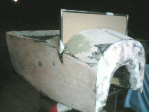

    im building a scratch made body based off a model T and A. im a big guy and really wanted it low but wanted a model T style body. as we all know Ts are really narrow to a channel with a huge trans and drive shaft tunnel. so i built a card board body based off a real T body that i own. i used the same size firewall but widened the cowl as well as arched the cowl higher.i also love the flat back look of the trucks so i did that. i also stretched the body to keep from crunching my legs up. this is my first one. i built the body out of cardboard first then traced the 5 sides onto wood then wrapped it in fibergl***. i made the floor into the body so i when the car is fully completed i can dis***emble the entire car in 30 min down to the frame. still in the body work phase. the waves in it would make you sea sick. but its getting close to being done. the frame is a bob tail 2x3 with buggy spring. front is ford drums with split bones.

    Good job Kingpins !!!! That thing is gonna look great!!

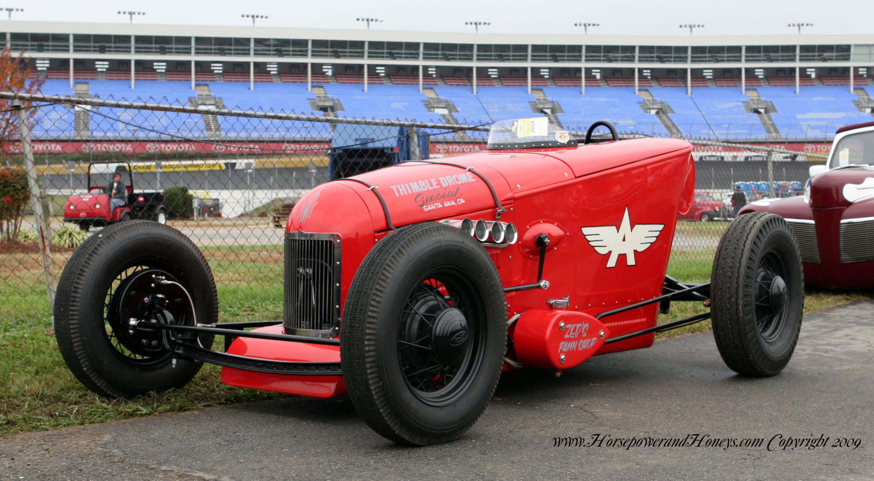

    Aluminum body...A little number I call the Thimble Drome Special...
  26. [​IMG]
    Barry- excellent work! It reminds me of a Cord- do you have any more pics to share?
  27. need louvers ?
    Posts: 12,901
    need louvers ?
    Retroridesbyrich, Whate was you build thread called on the Thimble Drome special? I was looking for it the other day and couldn't remember. Super neato by the way!
  28. Wow. Astounded by the replies, which is awesome by the way, Keep them coming!!!! Ive got about half the steel needed for my ch***is, will by another length once the wife stops spending dosh on landscaping supplies Grr....
