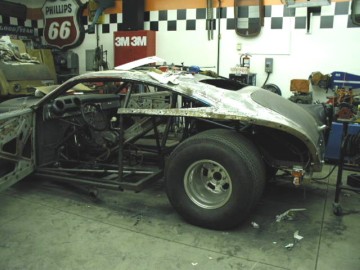

    I've always had a soft spot for Henry J's, but I always thought they looked best with a small chop, say 2 to 3 inches. Then I got to studying the lines of these cars, and thought it must be a real challenge to chop one. With that continuous slope down the back, there must be quite a bit a metal "re-arranging" going on.
    I don't own one of these, but I was wondering if anyone has ever do***ented chopping a Henry J and the steps involved. I'm just curious to see how it's been done, and what's involved.

    Here's a few pics from the link above. It looks like the metal shaping can get quite extensive from these pics. How do you address it when they have a trunk/deck lid?

    This is not a hard chop if you have decent metal working skills. You just lay the roof down without cutting it, just like a 40s torpedo back GM.
    This is a 2" chop. If you're serious, send me a PM and I can talk you through it on the phone.

    Like I said, I don't own one and I'm not planning on chopping one (at least now right now), but I'm curious how you reshape the slope on the back. When the roof drops down, that angle has to change. I suppose you'd have to cut out some of the metal around the sides of the deck lid, lay that panel down until it lined up with the up with the roof, and probably make some cuts in the rear window to tie the roof angle and rear panel angle together better. It would be cool if someone had pics they took during the process.
