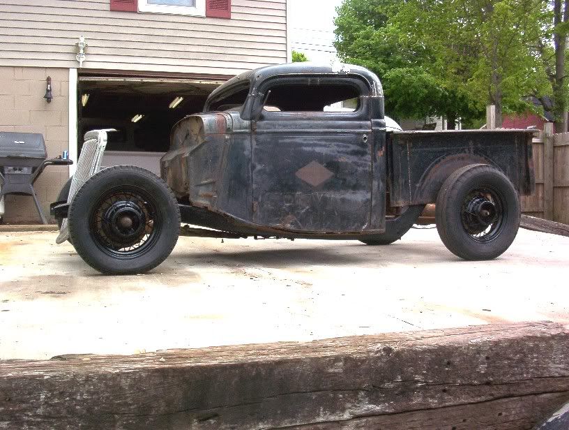

    There has to be someone who has done an article in a mag or taken pics as they went. My dad chopped his by leaning back the posts. I think it looks ok, but I am a hack.
    Here's my pop's 36.

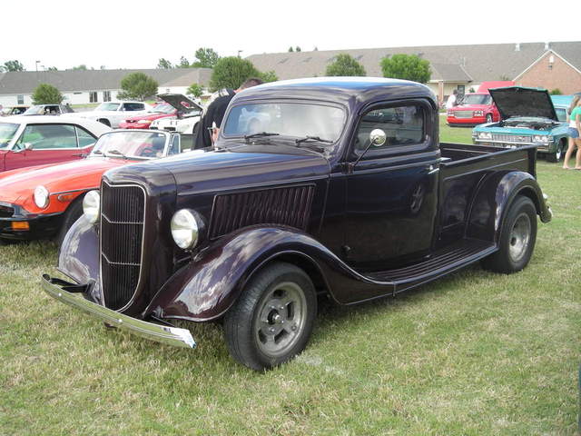

    sorry .not much help,,i didnt take pics as i went...,but i chopped this one about 3 years ago,,,i dont even rember how much i chopped it as its been a lil while,,,,,,but i didnt lean the post back,but added 2"(?) down the middle

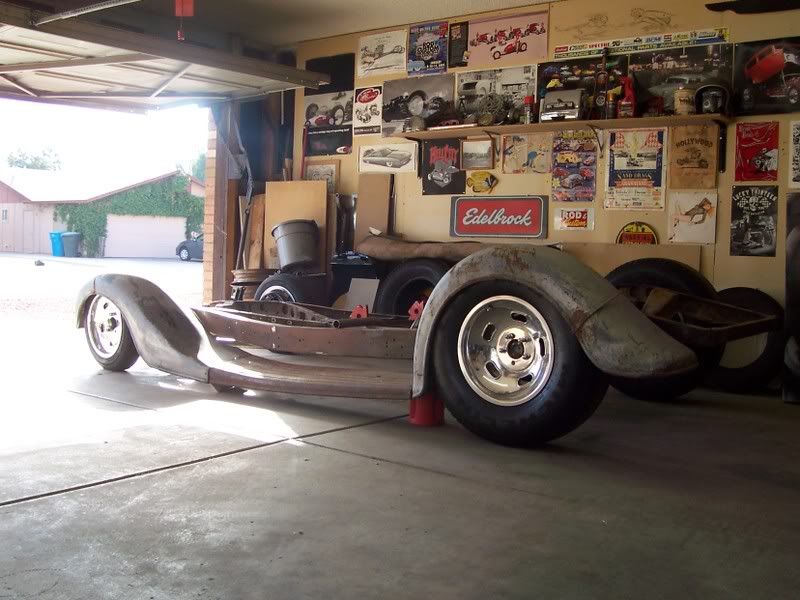

    Sorry, no photo documentation, but here is a good argument for leaning them back. Butt Reynold's chop looks good, but I like my chop more (haha)!
    ...and here is a mockup of where the fenders will reside after the channel....
    I'm running fenders and I think the angle chop helps the flowing lines of the truck. If it's going to be a fenderless deal, you can probably get away with adding material to the top, as a matter of fact, I think it probably suits the look better anyway.

    That turned out pretty good Sam.

  10. Sam F.
    Joined: Mar 28, 2002
    Posts: 4,225
    Sam F.
    thanks,i sware,,that is one that i've regretted selling,( i got laid off just after those pics were taken),,i WILL build another one one day if i can find a good cab!

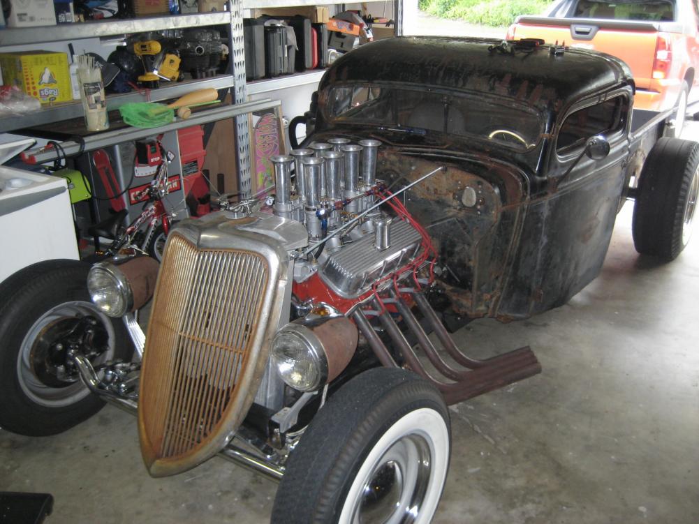

    I have progress pics of mine if you want to see them:
    5 1/2" in front 5" in back, rear window chopped 3" sectioned 2"

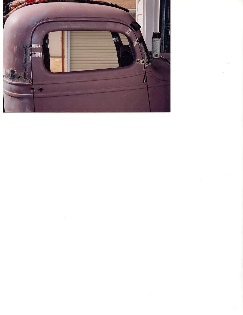

  17. I agree with Jeem if you are only going to cut it that much lean the posts. here is my 37 Chev about 2 1/2" out of it super easy.
  18. Roothawg
    Joined: Mar 14, 2001
    Posts: 25,661
    Roothawg
  19. Thanks. This was the first thing I ever tried to chop and it was fairly easy. Try to make all of the cuts in the straightest sections and then set the top back on and tweek the posts until they line up again.
  20. krashman
    Joined: May 8, 2005
    Posts: 144
    krashman
    Here is that truck now. Just starting to finish the chop now.
