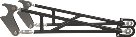

  5. I do know that this is not the reason for your post, but I have to agree with another poster ... you are creating a bind by not using leaf spring floaters.
    One other thing I noticed ... it may not really matter but I notice you are using "drag race" style ladder bars. It appears as though you have installed them upside down. Generally the lower bar of the ladder bar holds both the lower rear AND the front rod end. It may not matter in your application though, just thought I would bring it to your attention.

    Like 'BTL' said, leaf springs and ladder bars need to be seperate from each other with a floater kit. I think the ladder bars are right-side up but they are running uphill and generally they work best when bottom bar is about level with the ground. Configured the way that you have them (running uphill) you will have a ton of 'anti-squat' in your rear end geometry, so much so that when you drive around the rear tire will seperate from the rear body - the suspension will lift the body away from the rear tire.

  9. Look closely at this pic ... the lower bar is threaded and accepts the front rod end and the upper bar is fitted and welded to the lower bar. It appears to me that the Original Poster has the ladder bars upside down with the upper bar containing the front rod end.
    I suggest the Original Poster contact the maker of the ladder bars for verification. As mentioned earlier, it may not matter in this application (***uming street and low horse power) but it is definitely not the "generally accepted correct way" to mount the bars.
    I do agree that the lower bar should also be horizontal or close to horizontal though.
