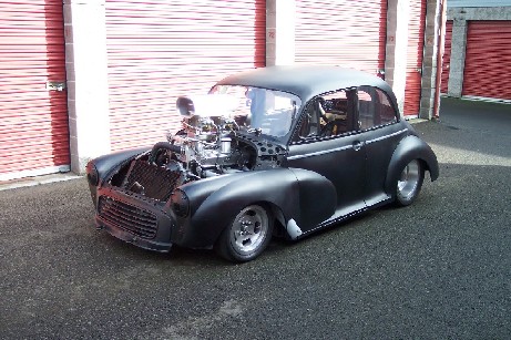

    Without a pesky engine/trans, eh? Less stuff to get rid of. My brother [Janglehead here] built this '61 Morris some years back. I welded up his ch***is from 2"X4" box tubing..used a complete 69 Opel GT front suspension, a narrowed 8&3/4 mopar rear axle, trailer rear springs [parallel leafs] and a 406 SBC with a powerglide. It eventually went 10.32 in the 130s in the quarter. WE putted it around Omaha 'till he moved and he putted it around southeren Oregon. [/ATTACH] Scottysmorrisfront.jpg scottysmorrisrear.jpg

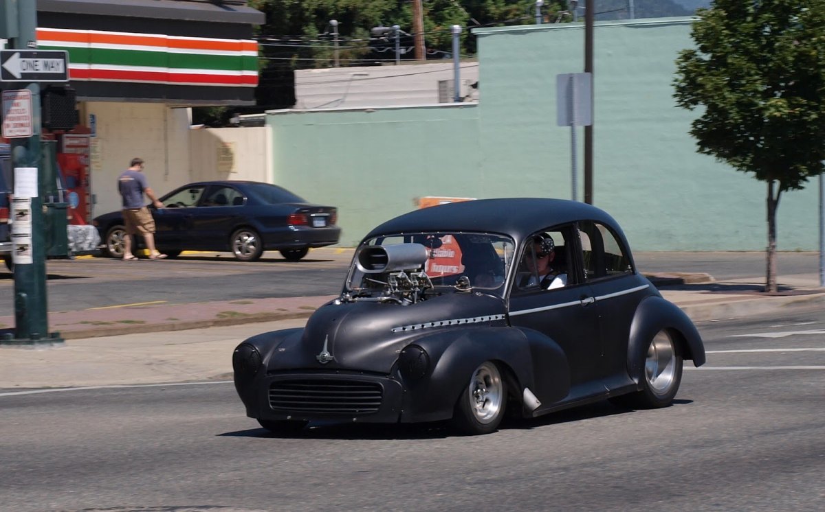

    My good friend Scotty ( Rocky's brother) built this one and "It RULES" ! Just google Scotty Gosson Morris Minor and see lots more of it.

    Ho;y ****, Glen! That's a better photo than any I have of Scotty's Morris....I'm stealin it.
