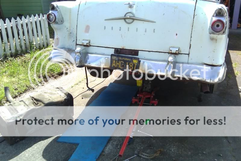

  3. UnsettledParadox
    Joined: Apr 25, 2007
    Posts: 1,107
    UnsettledParadox
    i dont think i can modify another tank because the one for this car is unlike a regular tank. heres a pic i have on hand for reference
  4. CJ Steak
    Joined: Sep 23, 2008
    Posts: 1,377
    CJ Steak
    from Texas
    As long as you use clean metal and your welds aren't porous I don't see a problem with that. You can use an exhaust pipe as a filler neck. Your rectangle will probably have sharp corners... but it'll fit.
    Just make sure the sending unit is in the same place and the pickup tube/float arm are "clocked" the same direction as stock.
    The only issue I can see you running into, is the steel won't be treated with anything. You might get rust in there pretty quick I think. Especially from the back sides of the welds??
    I'm not sure when they started galvanizing tanks, so I guess you'll be ok...
    -Chris
  5. Chalupa55
    Joined: Feb 3, 2008
    Posts: 152
    Chalupa55
    from So-Cal
    Looks pretty straight forward. You could put baffles in it while your at it. I would use 18 or 16 gauge if you do it.
