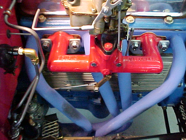

    This is a rare Stromberg-Bendix downdraft circa 1931 that was powder coated red eight years ago. Thought Ford blue on the engine would be trick. Looks awful and will redo it next year along with the blue headers.
