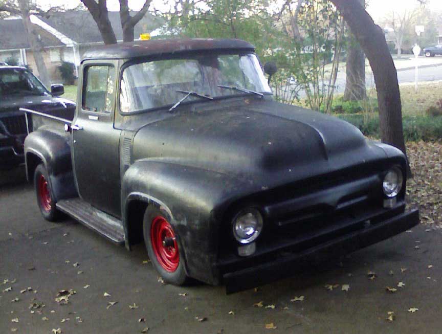

    That looks great compared to mine, here is my 56 f100 project. I've got to do some head work and I'm going to clean the whole thing up so it's coming out anyway. I want to run 3 Holley 1904's, I have 2 but they leak like crazy. Had to JB weld one up to get it home. They don't have the glass bowls (wish they did) I'm looking at the Offy intake for it.

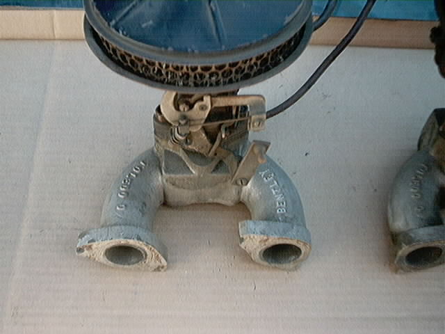

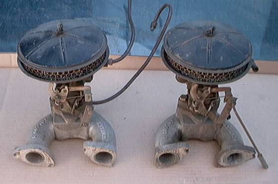

  8. Thought you guy's might be interested in a rare vintage 223 dual carb set up my dad had on a '55 Ford wagon years ago . It is a setup made by Bently out of Toledo Ohio, I have never seen another one of theses set up's. Here are a couple of photo's.
    CBB

    That dual Bentley carb setup is trick! The ad on 'for sale' says the linkage is missing, I won't how much of a pain in the ass that would be to figure out, but if it could be done that would look sweet riding on top of any I-6. :D
