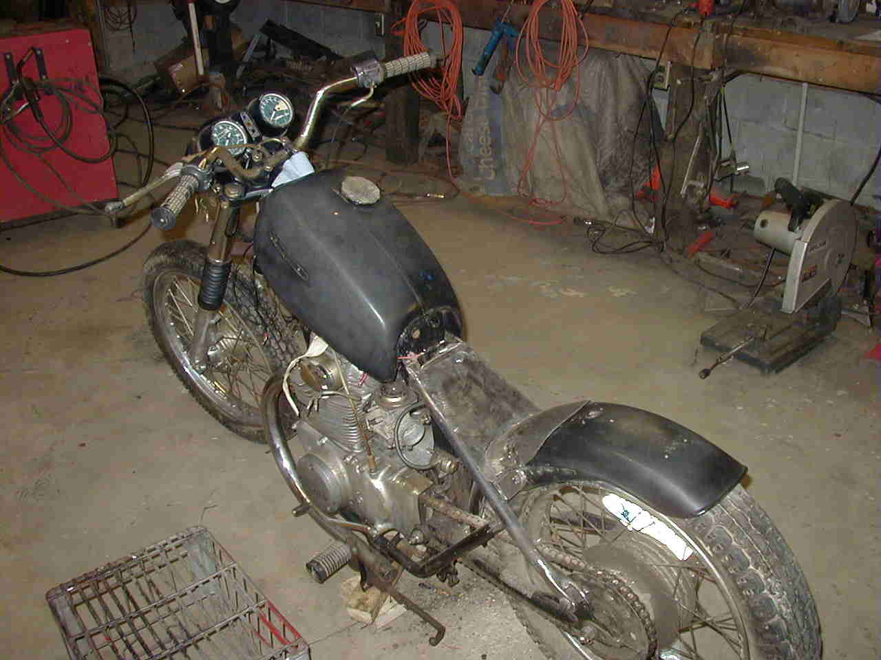

Anyone ever seen a honda bobber?
Discussion in 'The Hokey Ass Message Board' started by Kustchops, Dec 14, 2003.
  1. the modifcation to the frame was pretty simple. you just buy some pipe that is close to the origional frame size. then you cut the frame off right behind the gas tank mount, and leave the two tubes going up long so that they can be fitted later. the pipe will fit inside of the origional frame section. you have to kinda bend it around the rear fender and build brackets to bolt it on where the origional shock mounts. build the chain side of the bike first. it could give you the biggest problems. heres some more pics. also when you cut down the fender keep the leftovers. they help when building the seat pan. thes pics are from a while back I will take more tonight.
