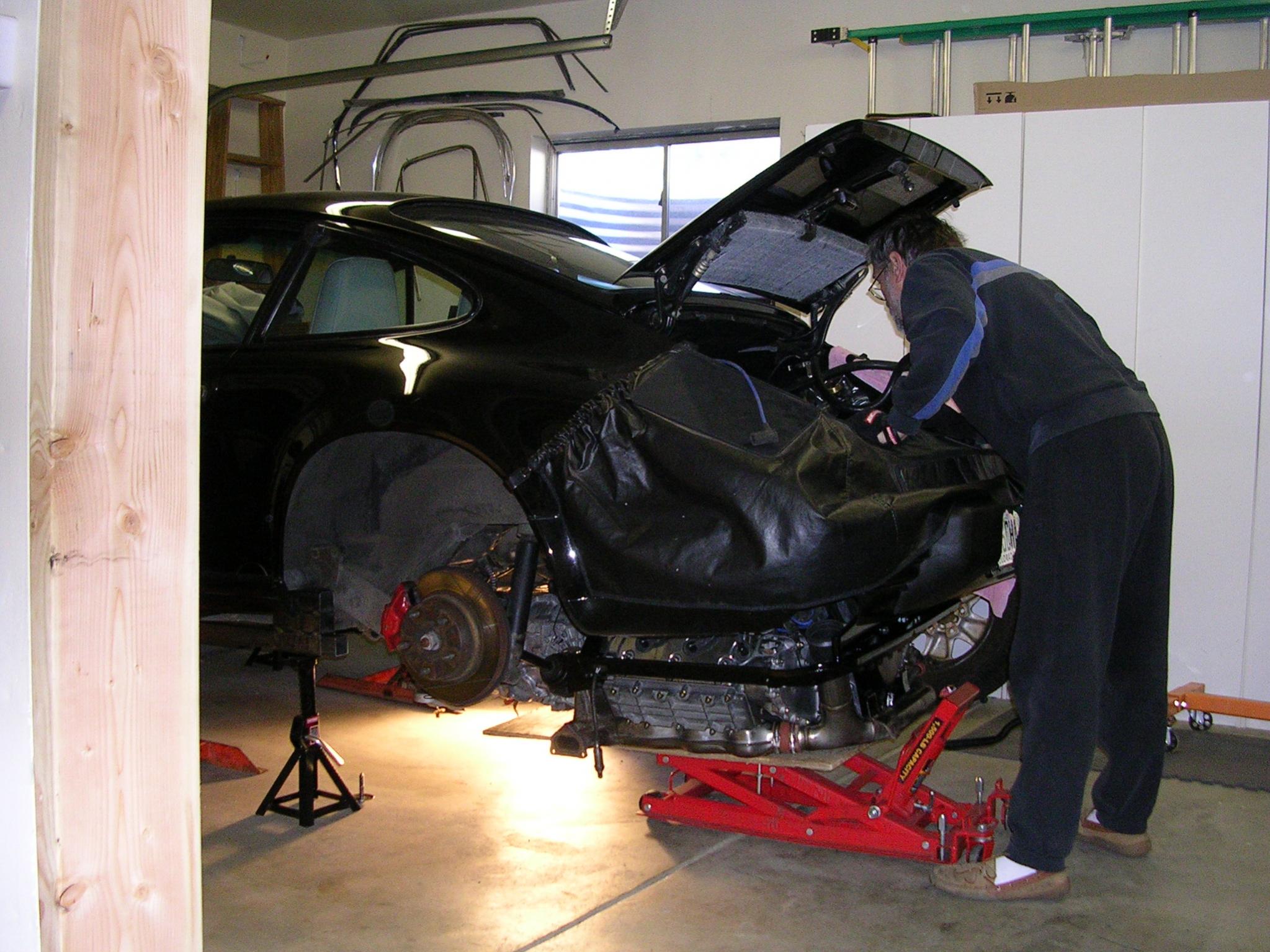

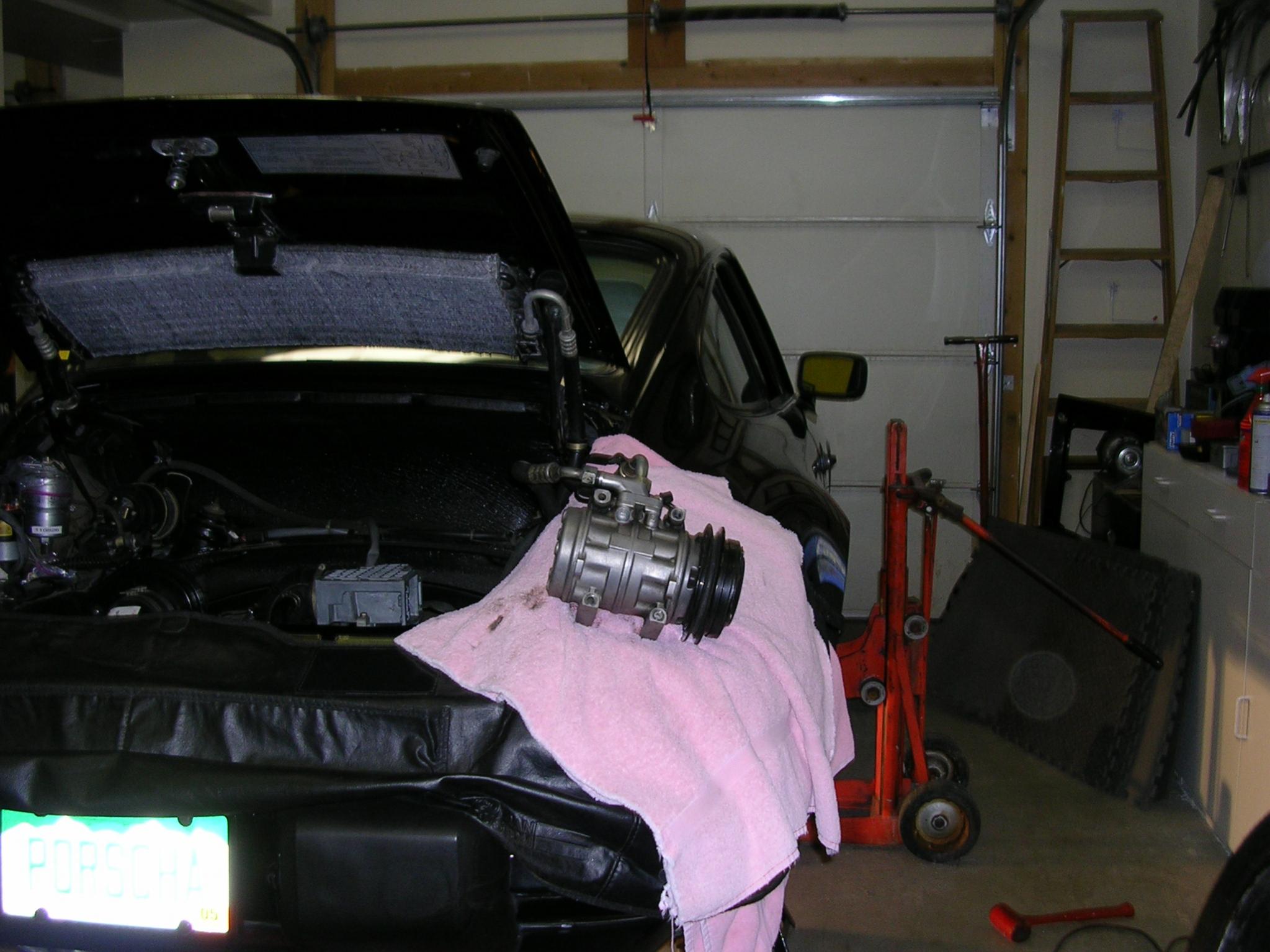

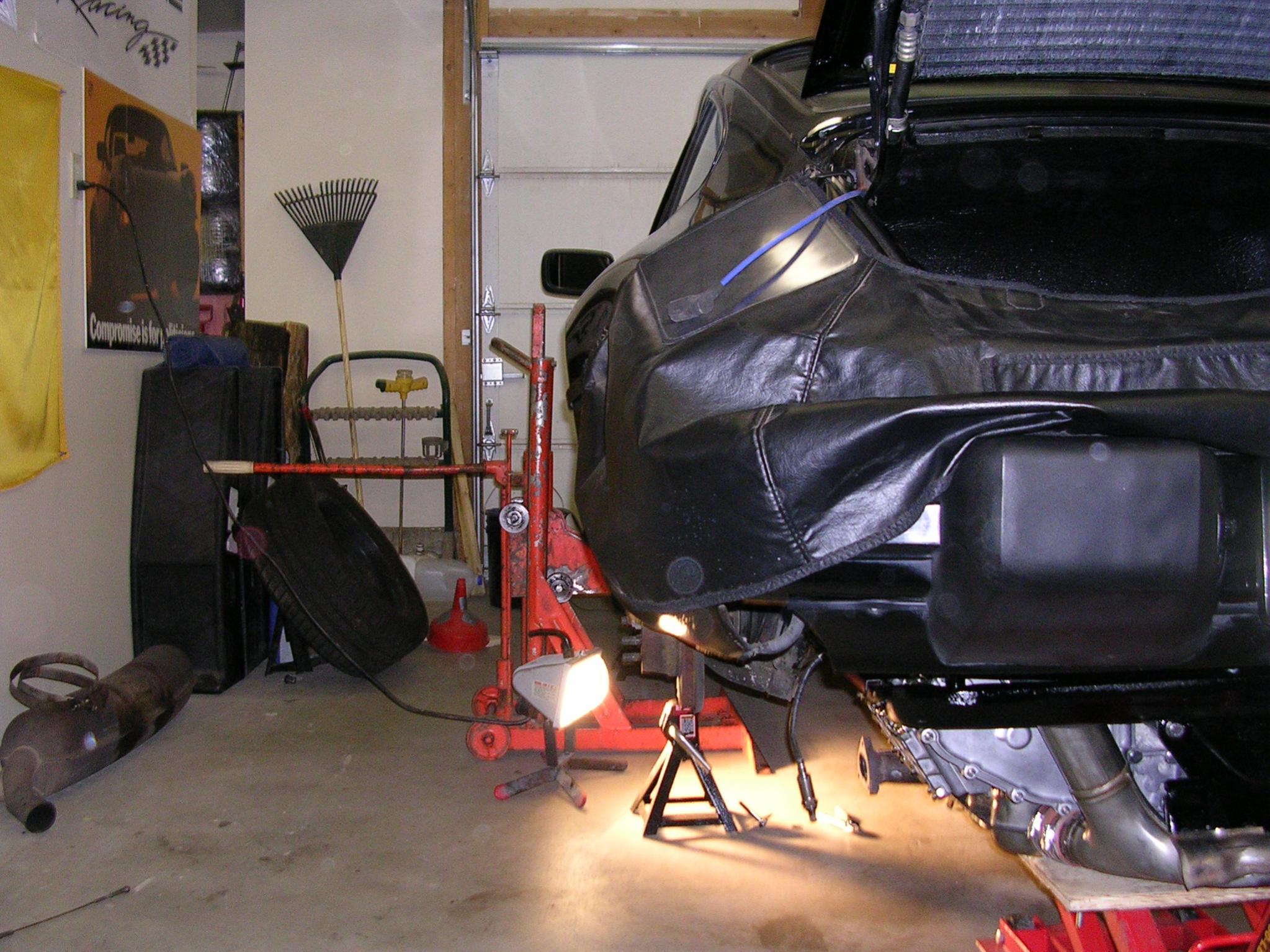

  22. Merc cruzer
    Joined: Feb 26, 2009
    Posts: 286
    Merc cruzer
    from Colorado
    I used two to remove a Porsche engine ( the car I eventually sold to buy the 53' Merc). Notice there is a jack stand under the cross member of the jack. I do like the idea of lifting the body off the frame....thanks, I was wondering what to do with them now. You have to be creative when there in only one of you to do the job.
