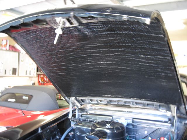

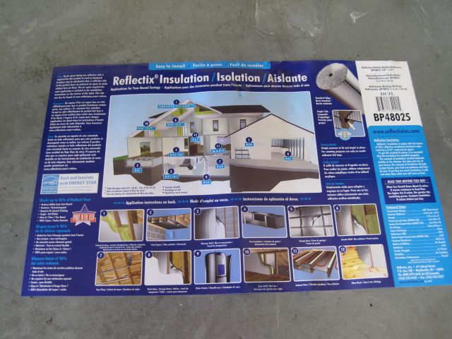

    New here and first time posting, so I hope the attachments come through. I used the foil wrapped bubble type insulation material from Lowe's on the inside of the hood of my '55 Clipper. I used it to replace a filthy and degraded fiberglass mat. I used three layers of the stuff glued together with 3M spray adhesive and glued to the inside of the hood. Spray adhesive not too good on holding the insulation to the hood. Ended up with some 3M trim adhesive and this stuff held. I rattle can painted the insulation black so as not to stand out too much. All in all I like the way the job turned out.

    Why did you go with 3 layers?

    That's the same product we used on the floor of a 68 GTO Conv and the floor and roof on a 74 Road Runner. I glued it down with 3M Super Trim adhesive then glued some carpet underlayment to it then the carpet. It's easy to cut with a sharp scissors. I put the dark side down. Made a big difference in noise in the Plymouth. Don't know about the heat factor. Black interior in a car with no A/C.....hahaha.

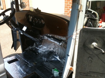

    Finished up the firewall and floor on the my coupe a few weeks ago and it seems to have knocked the heat down a few degrees, not so sure about the noise though ha.
    Oh, and not a bit of smell at all.
