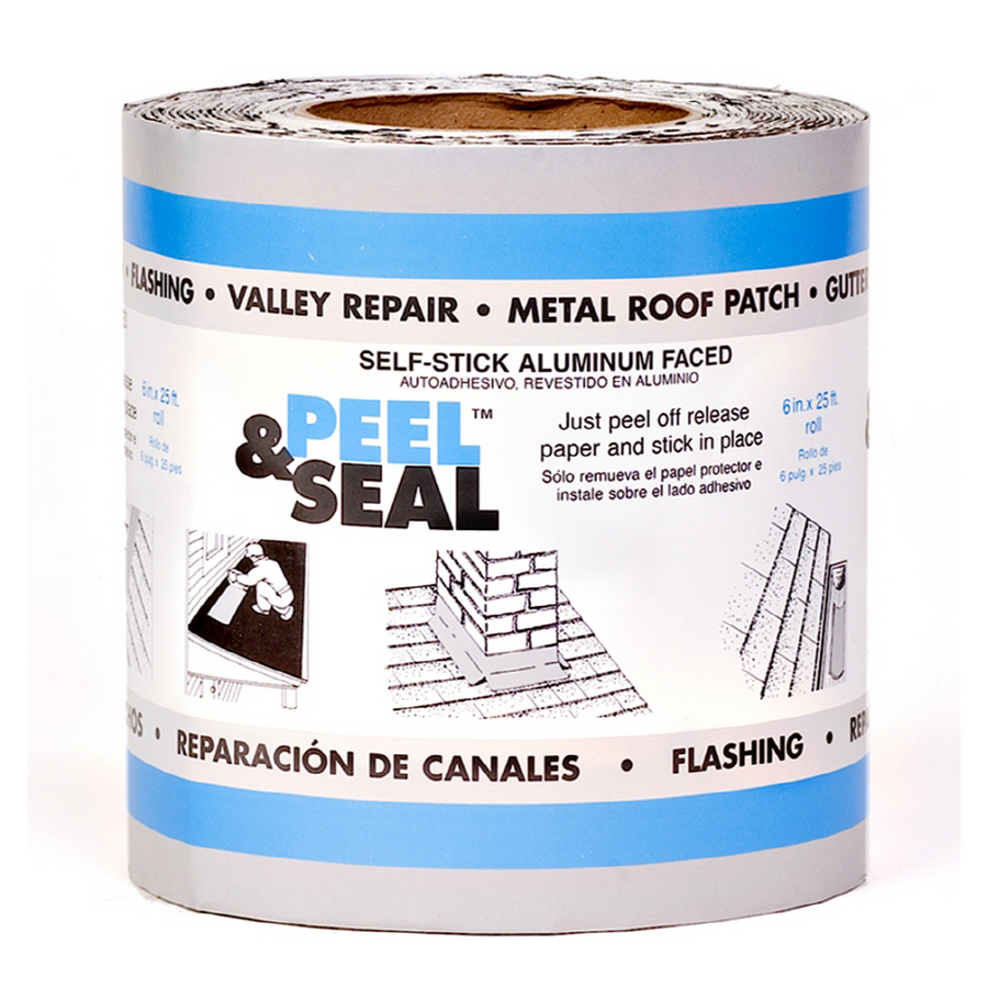

    In May, I used the ceramic beads from Wickes mixed into elastomeric roofing paint from Lowes on the floors, toe boards, kick panels and inside the doors of my 48 Plymouth Coupe. Covered the home-made lizzard skin with the Peel and Seal shown above. Used a hair dryer to heat the backing before sticking it down. Then covered the floor with some cheap foil backed insulation that JC Whitney had on sale.
    My car is a daily driver and is parked in the driveway not in a garage. Went through a summer in Dallas with NO tar smell in the car and only one piece of the Peel and Seal coming loose on the kick panel. The piece that did come loose was over two fairly large cutouts on the kickpanel so there was not a lot there for it to grip on to.
    Has made a big difference in the sound and temp inside the car. Made driving bearable during the summer. I will soon be taking the headliner out to do the home-made lizzard skin and insulation to the roof and then the trunk divider.

    FWIW I used the peel n seal on my floor and inside doors/quarters...I used the dap? landau top glue and it has held about 90%, and I didn't do any sort of surface prep, it's really irregular tar paper remnants or something in there that I stuck it to. Just a few sheeets had slight peeling at a corner or two. I figured if it falls to the bottom of the door or quarters so what. When I finally put the car together I'll put the reflectix/peel n seal behind the door panel so it'll stay up

    hey guys i work at the depot( regertably ) the stuff you are talking about is in building materials with the shingles it is used for valley flashing we keep ours next to the roof felt i will get the name tonite and let you know

    they call the insulation " ice and water shield" roofing supply stores!!! used on roofs in cold climates a the first course of tar paper to stop ice and water for backing up under shingles>>>> looks like dyna mat

    Hey Lobocrud, Waht did it smell like, did it have an asphault like smell? How well was it bonded at it's highest tempeture? Did it feel like it could be slid or peeled off?
    I just reroofed my house and have tons of the **** leftover. When the stuff was hot, it was gooey and messy to work with. Just wondering what it would do on a hot firewall.

    I am in the middle of doing my caddy in the peel n seel. Same place as rusty pipes got his. bout $70 a roll. I have the entire rear half of the caddy done and the roof. I figure I'll get all the doors done and probably run out.
    And rusty is dead on when he said it has to be warm out for it to work. I was out there the other day and get got cold on me and just wouldn't stick. So if you're working in the cold like I am at night set the roll up in front of a couple shop lights and bring a blow dryer with you. It doesn't have to be that hot but a little warm goes a long way.
    I'll post up pictures when I get them off my phone..

    When your roofing with it, its just the opposite. If you leave it out in the sun, it becomes too sticky and pliable to work with. I had to keep the rolls in my ba*****t and bring them out just before I installed it.
