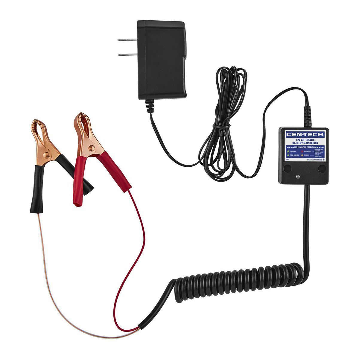

    I had mentioned to Brenda a few weeks ago that I was thinking about buying a battery maintainer for her wagon and when we left the doctors office she said, "Oh I forgot but I bought you a couple of battery tenders yesterday.
    I've never heard of this type of unit but if it does the job that's great, it's cheap enough a 9.99 :cool: HRP
    Keep 12V batteries in top condition. This automatic 12V battery float maintainer keeps batteries fully charged and prevents overcharging. The maintainer is easy to use, simply connect the battery and plug in the wall adapter.
    • Intuitive user interface with tri-color LED indicator for charging and operation status
    • Easy access reference guide on the maintainer body
    • Built-in indication for reverse polarity, bad battery, short circuit, and incorrect battery voltage
    • Auto shut-off when fault is detected

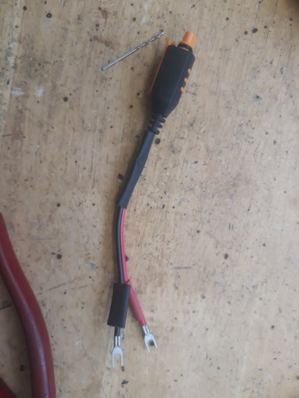

    So I purchased a CTek motorcycle battery tender [cheap] and a 3 metre male/female CTek extension cable, and I also managed to find a Ferrari plug in the UK for cheap.
    The CTek charger also came with 3 adaptors [one with 2 eyes, one with 2 jumper clamps, and one with a cigar lighter plug]
    I also purchase a "Deltran" solar powered battery tender and a solar panel.
    Then I got creative and cut the "male" plug off the extension cable approx 150mm from the end and soldered the Ferrari plug to the extension cable.
    The male plug "pigtail" that was cut off had 2 eyes crimped onto the ends. This was then attached to the "Deltran" solar tender.
    The other end of the"Deltran" tender has a Narva 2-pin plug that attaches to the solar panel.

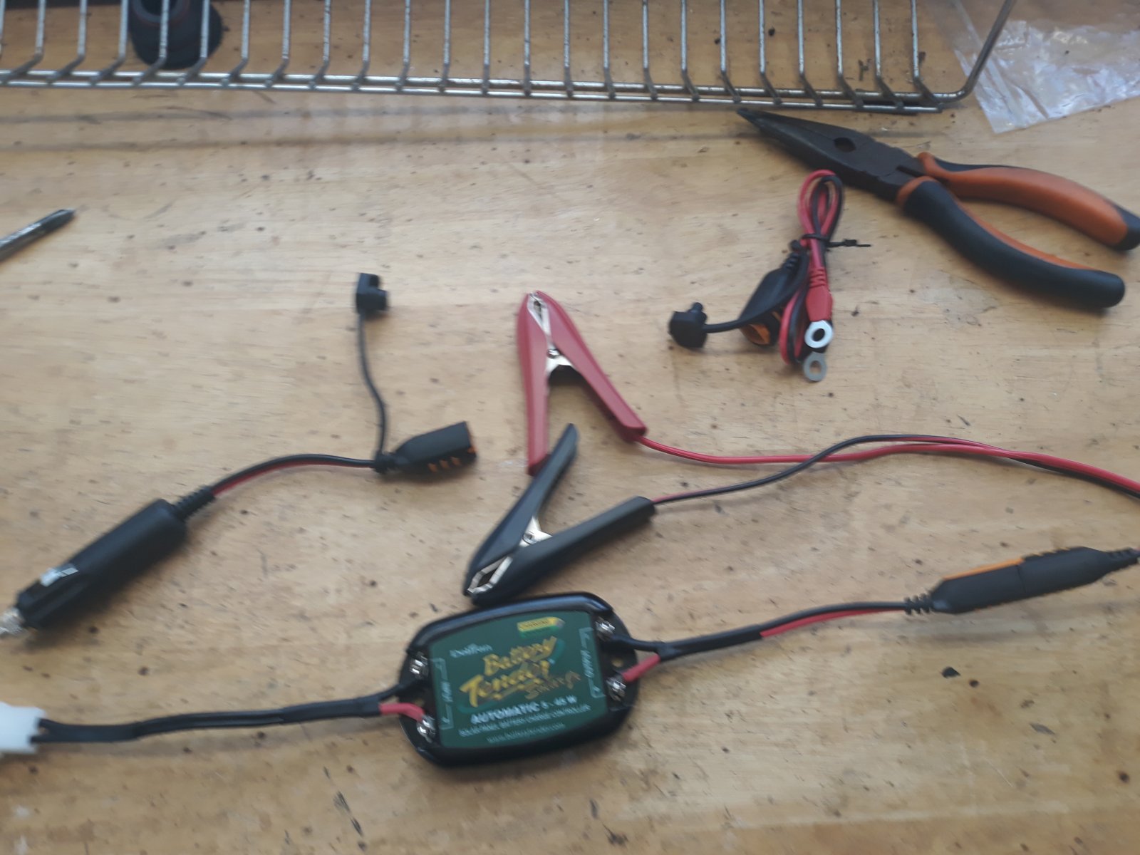

    Here is the "Detran" tender with the other attachments
    I use the jumper clamps on my 57 Chev, and the "Eye" attachment is now hardwired to my trailer winch battery.

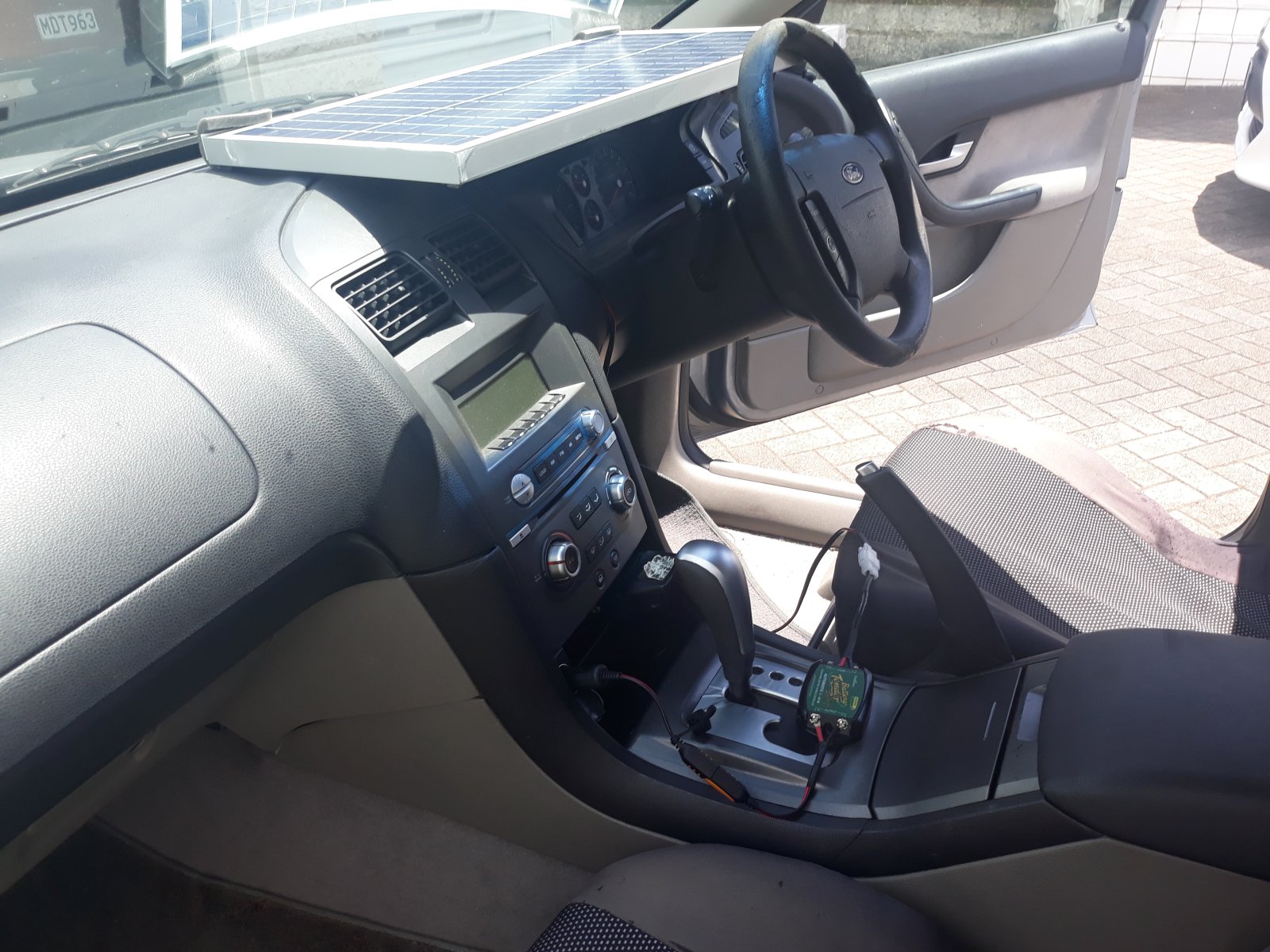

    Here is the solar charger in my tow hack [plugged into the 12v port]
    Now I can mix'n'match between vehicles ,and mix'n'match solar vs plug-in power.
