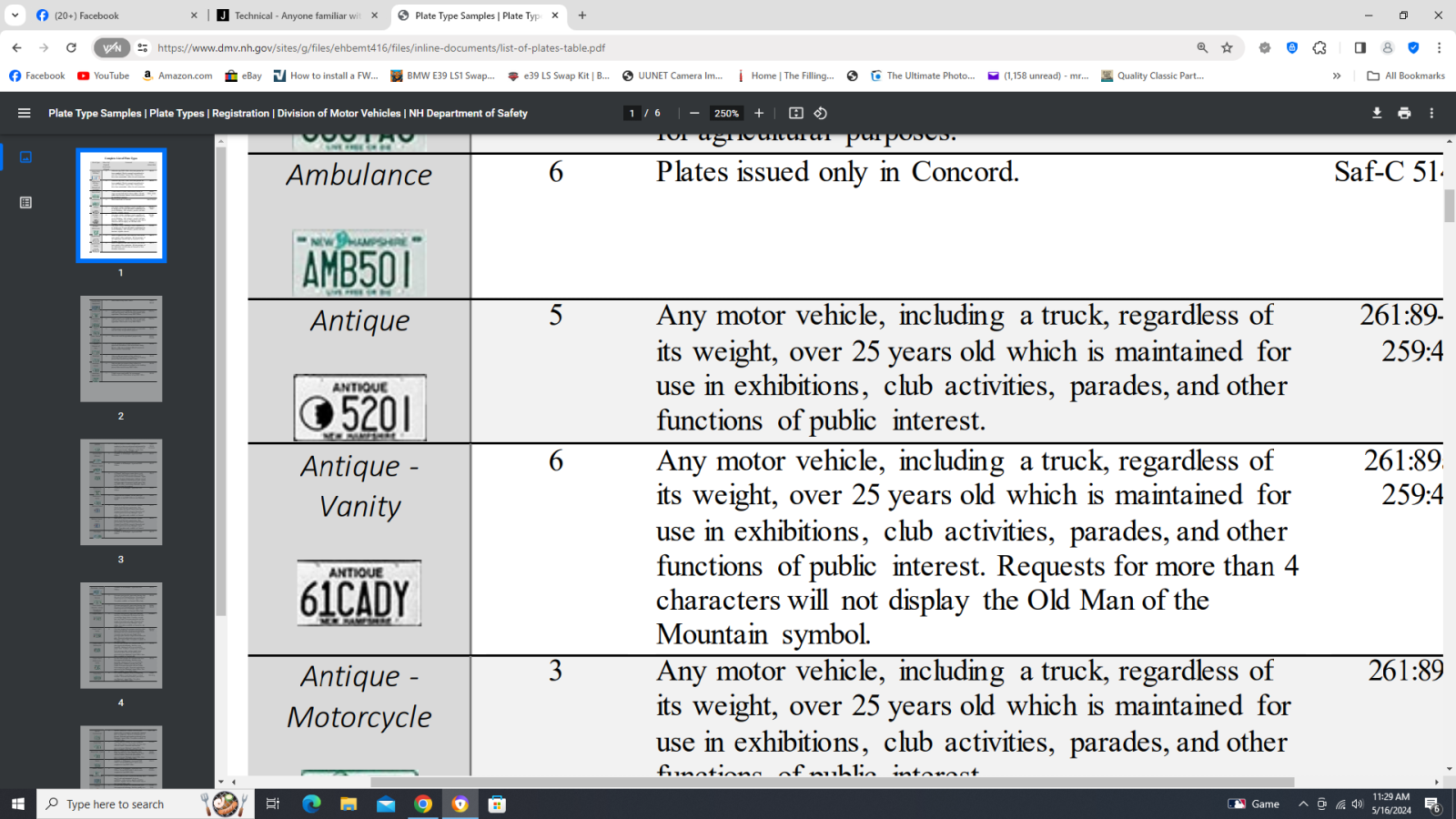

  8. Macey
    Joined: Dec 14, 2023
    Posts: 18
    Macey
    I'm not totally sure. I know antique plates aren't supposed to be for a daily driver and more for shows and parades or something like that.
    But I guess the different types of plates affect what needs to be present for inspection. Like I was in Massachusetts before and if the car was so many years old you were exempt from certain requirements. According to the inspection station in New Hampshire, it doesn't matter that the car is from 1934, it needs the antique plates to be exempt.

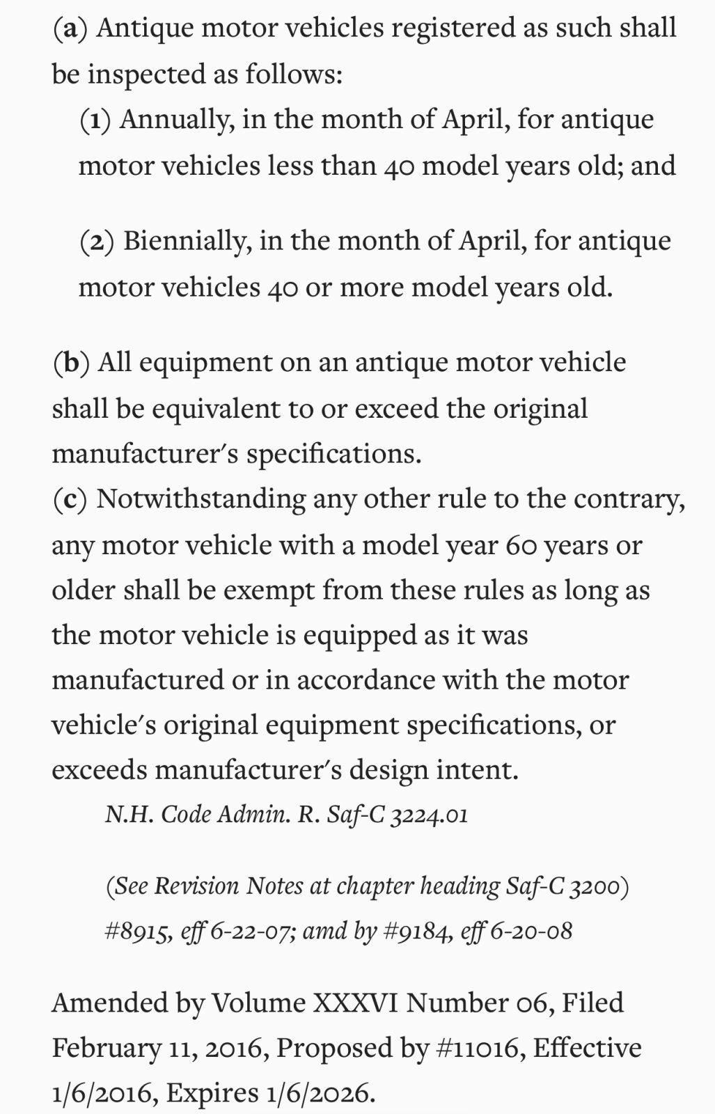

    Joined: Apr 28, 2011
    Posts: 1,054
    SDS
    If the VIN # is indeed that of a 1934, they cant hold you to a modern inspection. Only 1934 standards. You don't need turn signals or seat belts. Anything that the car was originally equipped with must be operational.

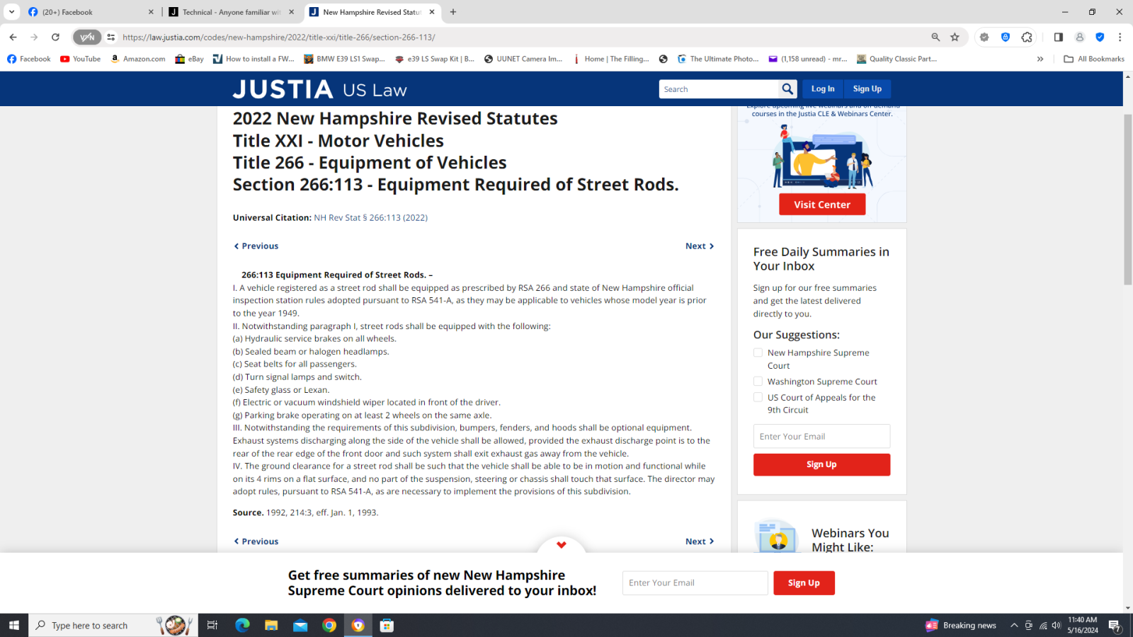

  11. Mr48chev
    Joined: Dec 28, 2007
    Posts: 35,849
    Mr48chev
    Here in Washington State the "Antique plates" get abused something terrible. the state allows anything over 20 years old to run antique plates because the plates were originally started around the mid 70's and Tri 5 Chevys were 20 years old. The horseless Carriage plates had/have a lot stricter requirements.
    Sad part is that every vehicle I own is old enough by at least two years including a 2002 VW Passat sedan.
    Still every state has their own rules and under this discussion only what goes on in New Hampshire is applicable. That includes jumping though smaller hoops some with or without flames to satisfy local regs on top of county and state. Meaning paying the tax to the city that isn't collected by the state and sent back to the city. I remember thinking that I was cutting a fat hog in Texas in 1970 when I registered my car there for about 15.00 rather than the 65 in Washington only to get a tax bill from the county, then one from the city and then one from the school district that made the total come out more than the 65 that I paid in Washington.
    As far as Macey's issue goes, it looks like the main difference between Antique and Street rod plates is that you have to have the car inspected to qualify it as a street rod. That may be to eliminate late model crap rods that are fenderless from getting street rod plates.
    Personally I would just contact the inspection station, tell them that you built it as a fenderless street rod and need to have it inspected and leave out the "when" part.
    Before that, make sure all of your ducks are lined up dress right dress and cover down. Go down the list in Section 266:113 and make damned sure that it complies with each line on that list that don't include fenders or hood.
    A lot of us have been in the been there done that when it comes to dealing with license clerks who are less than knowledgeable about anything out of the absolute norm. The license office I deal with here (15 miles away) is the best I have ever done business with, the owner is the best at knowing what is going on that I have ever met in any license office. He also knows exactly who to call in the main state office if he has an issue that he can't figure out too. Won't cut corners or cheat for anyone but he and his well trained clerks know what they are doing. The people in the city hall are often stuck with the job with little training. Screenshot (199).png Screenshot (200).png Screenshot (201).png

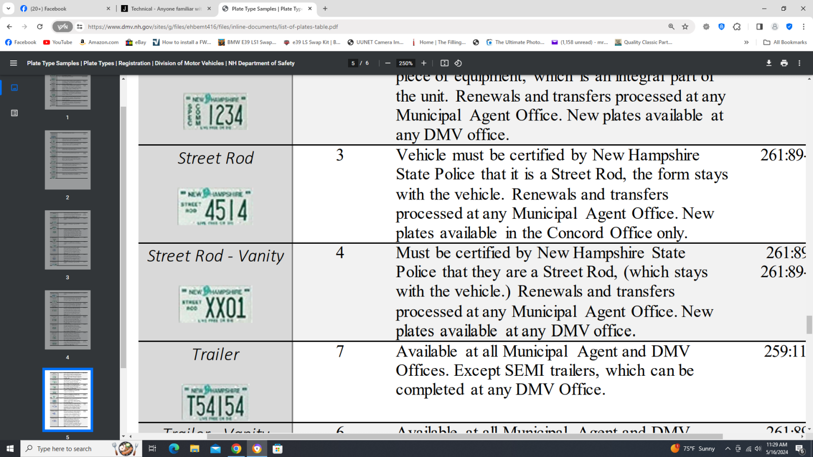

  13. Macey
    Posts: 18
    Macey
    Yes, exactly. The problem was because they couldn't figure out antique vs street rod I just got passenger plates. Solved the registration problem but sparked the inspection problems.
    I think best course of action will be to go back to town hall with the actual law printed and try to change the registration type. If I can go for antique, being more than 60 years old = no inspection at all.
    I could go for the street rod plates, but one of the aspects of the certification process is assigning a new vin number. The car has been more or less the same for probably 50 years and has a lot of sentimental value. I really don't want to go and change any of the numbers at this point.
    It seems the crux of the issue is the town clerk wouldn't do antique plates because the car is modified. She told me it would need to be street rod or passenger.
    However, street rod rules state the car must be older than 1949. My question would be how would she handle a registration for a modified 1955 car? Makes me think the logic isn't correct.
    The problem is the street rod registration criteria does describe a typical hot rod. But I wonder if it's more that you have the option to register a hot rod as a street rod rather than mandatory?
    Curious if anyone in NH has been able to register a 30s hot rod with antique plates? I think this is my ideal solution.
  14. Mr48chev
    Posts: 35,849
    Mr48chev
    You didn't frigging check the Street rod have to have list that I posted in post 11 before going for inspection?
    Wipers and seat belts required no if's and's or Buts clearly stated on that list.
    The minimum requirement is for one wiper in front of the driver. It doesn't matter if you are one of those fools who thinks he is never going to get caught in the rain in his hot rod even if it never gets pulled out of the garage if it looks like rain.
    Seat belt, I damned well would rather have my ass strapped down in the seat in any rig in case of a crash, I walked away from two helicopter crashes in Vietnam in 1968 because my butt stayed where it was supposed to be, I walked away from a roll over in my old OT truck because I was strapped in, I survived being ass ended by a garbage truck and shoved into a Johnson barrier because I was strapped down,, Had a hell of a bruise across my chest from the shoulder belt but I was able to get out of the car and cuss the garbage truck driver to the point he was scared shitless to get out of the truck. I don't think that fool had ever seen pissed off until he saw me standing beside that truck. He was probably still looking for his phone though. The "didn't come with" bull shit doesn't fly with me when it comes to seat belts.

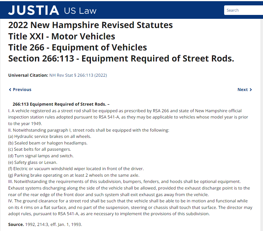

    Don't get me wrong, it will have seat belts. They were removed before I purchased it and I just haven't received the new ones yet. Wanted to get the inspection squared away to not worry about it.
    And no, that is the street rod requirement list, but the car is currently registered with standard passenger plates. So I went for standard car inspection, not street rod inspection.
    However, after reviewing that list there is an interesting point, 2 actually. To be a street rod, it must have 1) hydraulic brakes and 2) electric or vacuum wipers. My car is upgraded to hydraulic brakes, but being a '34 did not originally have them. It only has a single manually operated wiper. Therefore, I don't think they can tell me to go for street rod, it wouldn't qualify (going by original equipment).

  19. Mr48chev
    Posts: 35,849
    Mr48chev
    Are you for frigging real or are you a troll? after model T Ford era cars with hand operated wipers almost every American made vehicle had either a vacuum or later a electric wiper. Many up to 39 at least had one wiper as standard equipment and the passenger side wiper was "optional" That was cheap ass people bitched about paying for the extra wiper.
    The hydraulic brakes requirement just says that they don't want you sticking a big engine in it and staying with the mechanical brakes or in some cases just rear wheel brakes. If you don't put it down in writing some damned fool will try to cut corners on things like brakes.
    That list plus cycle fenders should keep you out of trouble with the law in any state let alone NH on the other hand none of those items make a hot rod a street rod, they just make it safer to drive in traffic.

  23. SDS
    Posts: 1,054
    SDS
    The info you have is incorrect - in NH, you can't be held to the vehicle having seat belts or anything that it didn't have when it was originally sold. In NH, you don't even have to get an emissions and/or OBD test if the vehicle is older than 20 years. The problem Macey has is that his town clerk doesn't know the rules pertaining to this - and it looks like the inspection station doesn't either (which is common in NH).

  25. 32’ pickup
    Joined: Jul 11, 2024
    Posts: 1
    32’ pickup
    Even with regular plates there is no inspection if it’s 60 or older. I’ve never inspected any of mine and never been stopped or questioned
