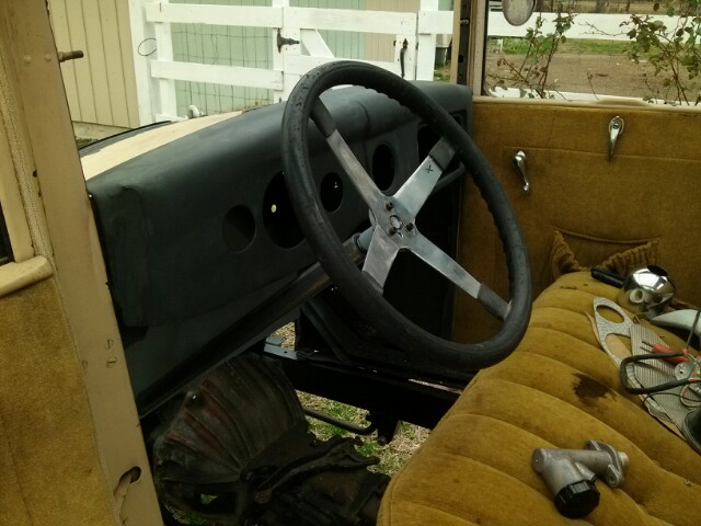

    I think I took both off this site. I was playing with the idea myself

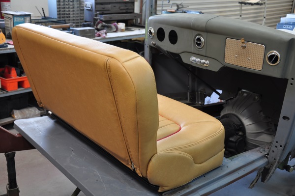

  7. Here is a 37 Dash in my 30 Roadster. I moved it forward of the dash rail. My body is Channeled and I needed leg room. This let me lift the steering column angle some. I'm running a 40 steering box and didn't want to modify the column drop. I cut the top off the dash and made a new flange facing the windshield and bolted in using the Gas Tank bolt holes. I'm building new end pieces curving forward to the A post. The Glove box opens just fine and with the Roadster dash rail trim on it looks right at home. Being it's Flathead powered I'll run all stock gauges as well as mount the starter button back where it belongs in the new corner piece.
