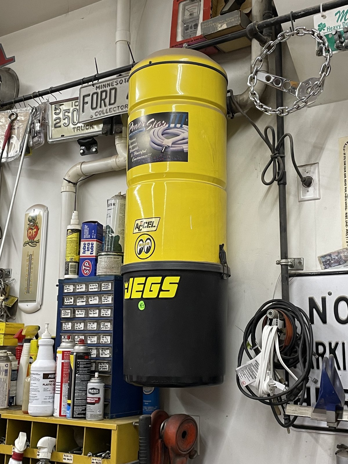

    My house has a central vac system and there is a drop in the shop and another in the room where my Bridgeport is. I have a 30 foot hose. I use it to vacuum up metal shavings from my mill and lathe and every other dirty job. I use it to vacuum the last of the glass beads from my blast cabinet when I am switching over to walnut shells. It is 20 years old and has never given me any grief. It works great for vacuuming out cars too. Way more powerful than any shop vac I have ever used IMG_9103.jpeg
