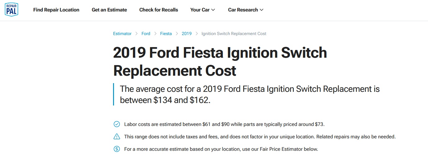

    quick google

    Here is what you get with the tumbler, I am behind times but I always got a key with the lock. But now all keys have to be programmed so that changes things. I went with my friend to the Ford dealer and I wanted to know if they warranty their diagnostic work. They are supposed to let me know the first of the week. I think the charge for that was $300.00. I think the tech just took the bigger job. Here is a link to the tumbler. https://parts.levittownfordparts.co...CkRUeeSci3ewdTNIkmdJSkDwmX3Z_O0xG76KTnMvplxKm

    So add 1/4 hour...
